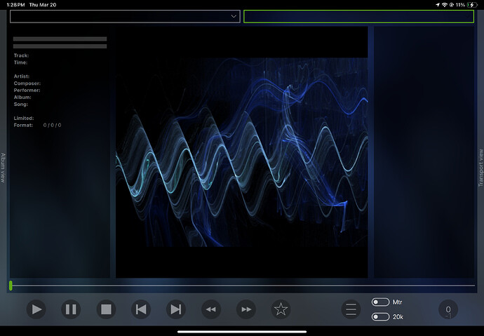

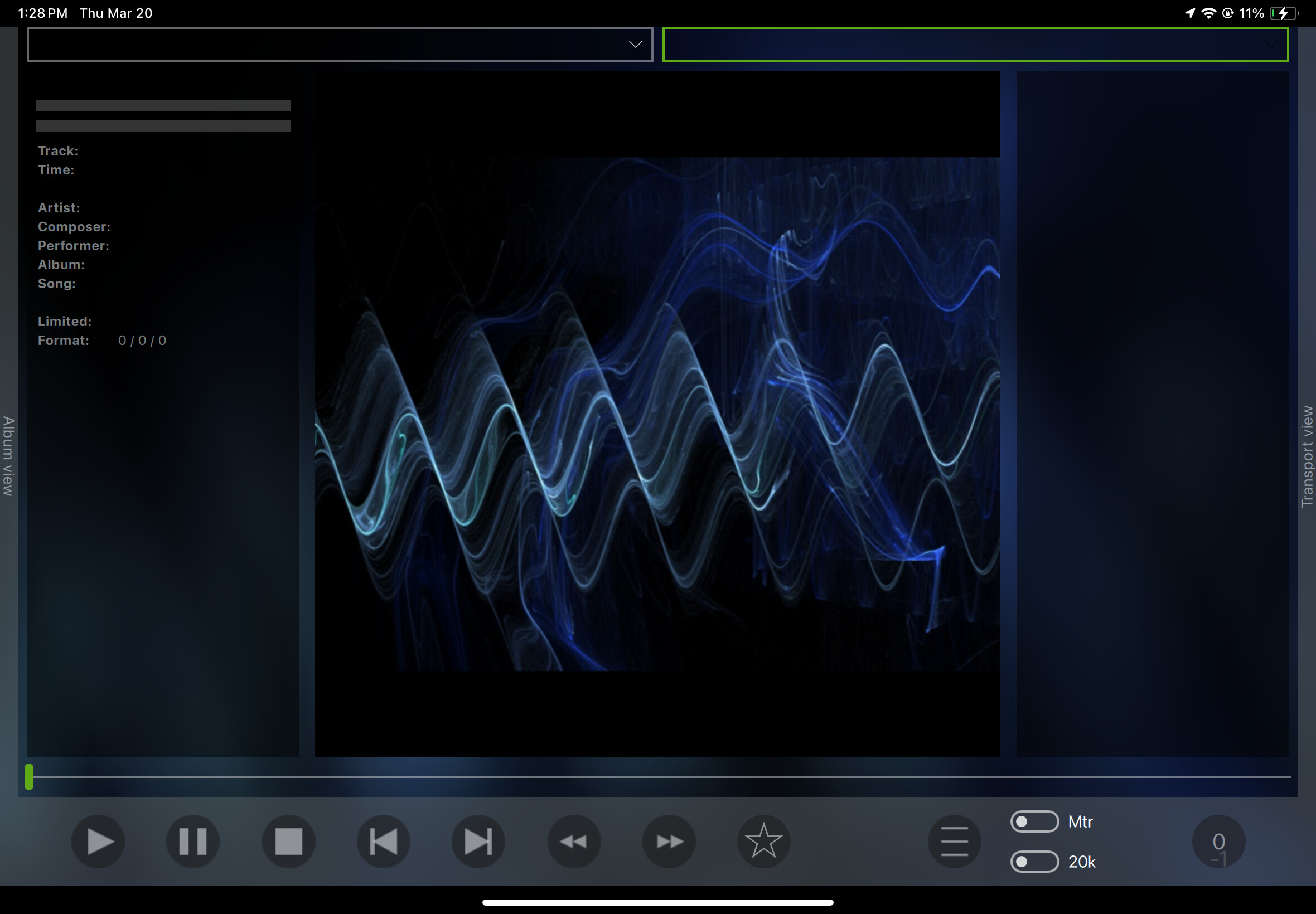

HQPlayer Client sounds really useful to me but I could use a little help getting started. When I first open it up, this is the screen I get. If I pull down the top left box it says localhost but selecting that doesn’t populate the box. I can swipe to a different screen which is also inactive. I don’t see any choices to make the changes that apparently it’s capable of. Can you help me get started?
