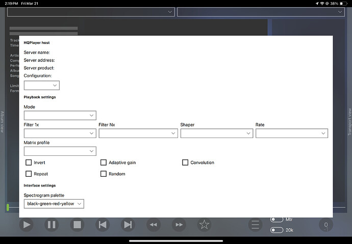

Mac OS 15.3.2. Under System Settings/Privacy & Security/Local Network HQPlayer Desktop has been given access. I can open the Client dialog box which has places for the server IP address but am not able to edit any of the information. Client also has allow network access turned on.
This one is not connected to any server. From the main window, top-left corner drop list you can select one of the discovered servers (or ā€œlocalhostā€ which is always there static option regardless if one exists). You can also manually enter IP address there if the (multicast) discovery fails for some reason.
Once you are connected to a HQPlayer server, those fields will be populated.
That’s the problem I tried to explain in my previous post. I cannot select Local Host nor enter the address of my server. It won’t let me edit any of the information.
Well, this is a little weird. After a couple of days of the only choice in the dropdown being Local Host, this morning it also listed my server and was able to connect to it. Sorry to have bothered you, thanks for your help.
