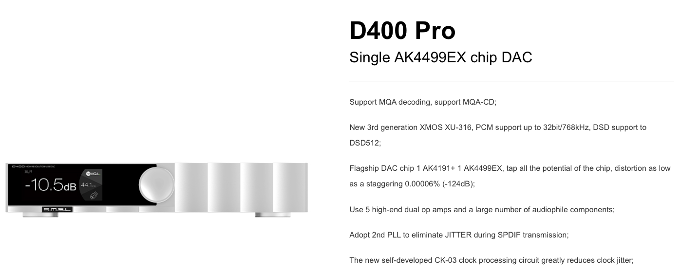

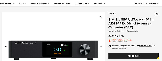

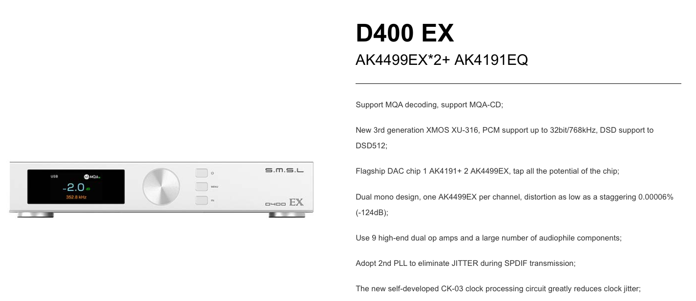

SMSL have new AKM 4499EX DACs out at the moment. Maybe one of them is actually great with DSD256 :smile: ! All support DSD Direct (you can confirm in the user manual).

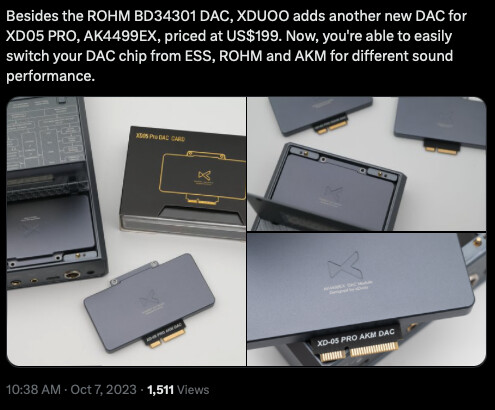

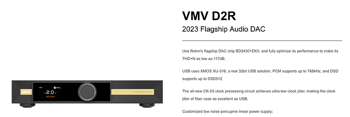

And a new ROHM DAC
And another newer SMSL ! So many AK4499EX - surely one of them is great.
And no IMD hump:
