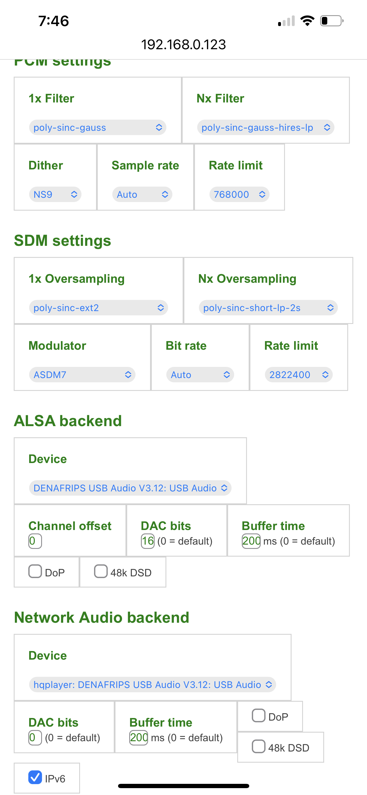

Is ā€œauto bit rateā€ in Embedded SDM the same as ā€œadaptive output rateā€ in Desktop? In particular, for DSD256, with the same filters and modulators, do the two behave the same on 44.1/16 material? I’m trying auto on Embedded, with a limit of 256*48000, and it seems that upsampling is non-integer and hits that limit, while I expected an integer multiplier under the limit. To some extent it’s just curiosity, but also it seems (I emphasize ā€œseemsā€) that the i9-19000 that runs Embedded for a Holo May is working harder than the Mac Mini M1 that runs Desktop for a Spring 2 at my other location.
In Embedded ā€œadaptive output rateā€ is named ā€œAuto rate Familyā€.
Set ā€œRate limitā€ to 12288000 (=256x48)
You need to check ā€œ48k DSDā€ too
… these are my settings using NAA
