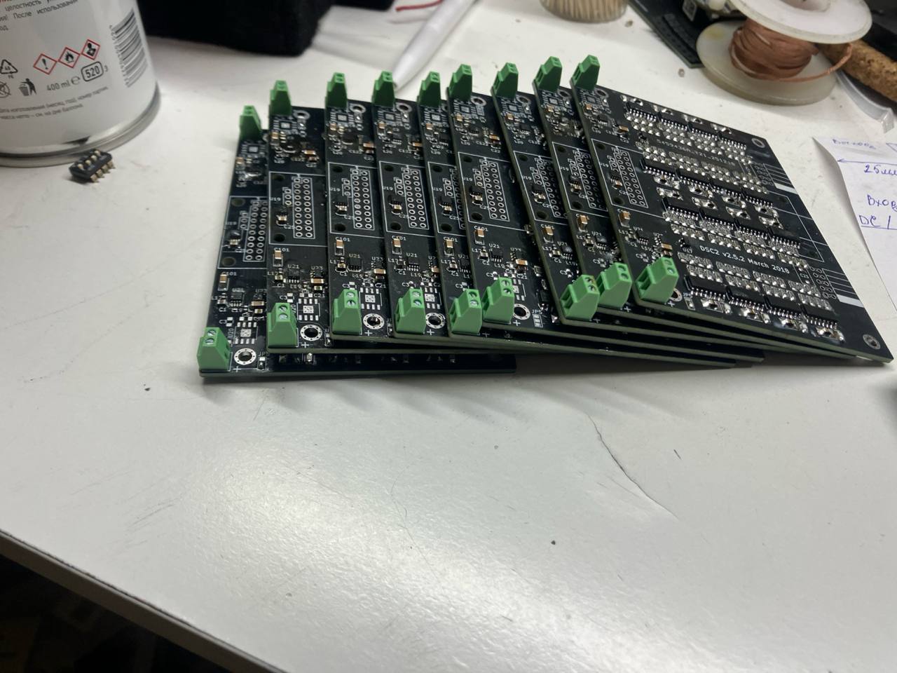

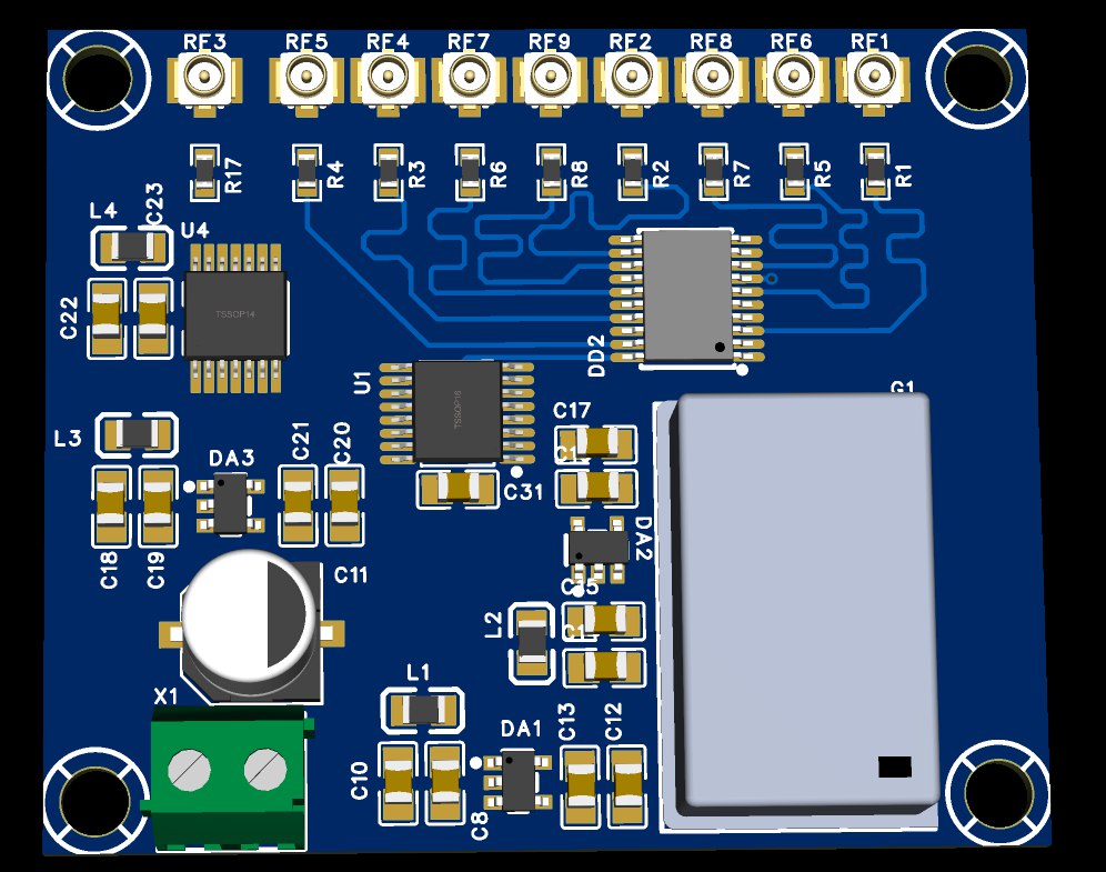

Custom Clock Board with 8 outputs 49 mhz and 1 word clock for Dante network.
