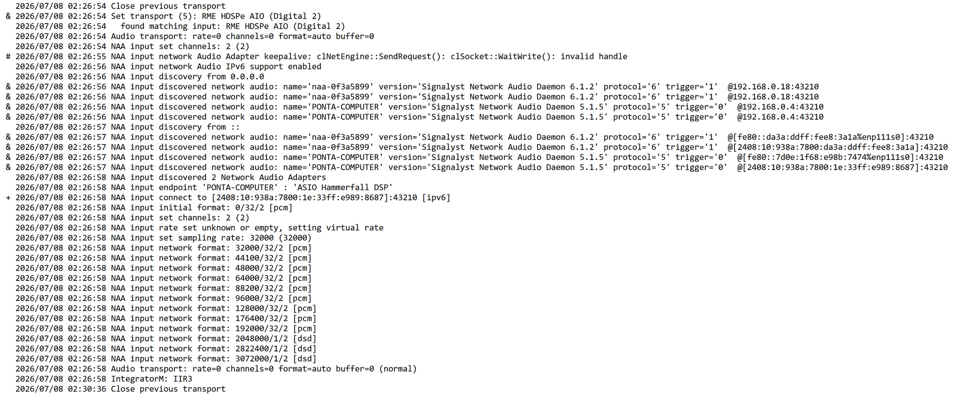

Log file states:
But no sound comes out with this…
I don’t see anything particularly wrong there. Only error is keepalive timing out on NAA and HQPlayer hence reconnecting there.

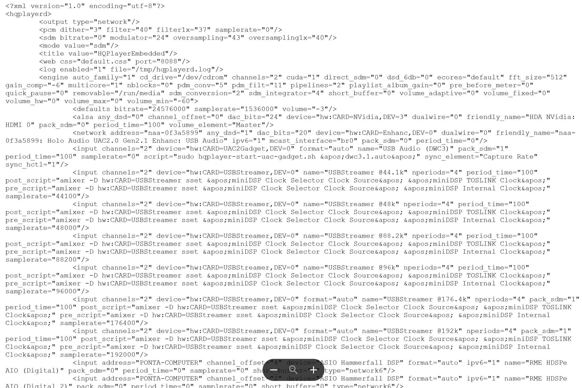

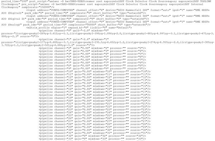

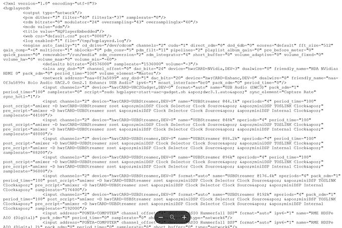

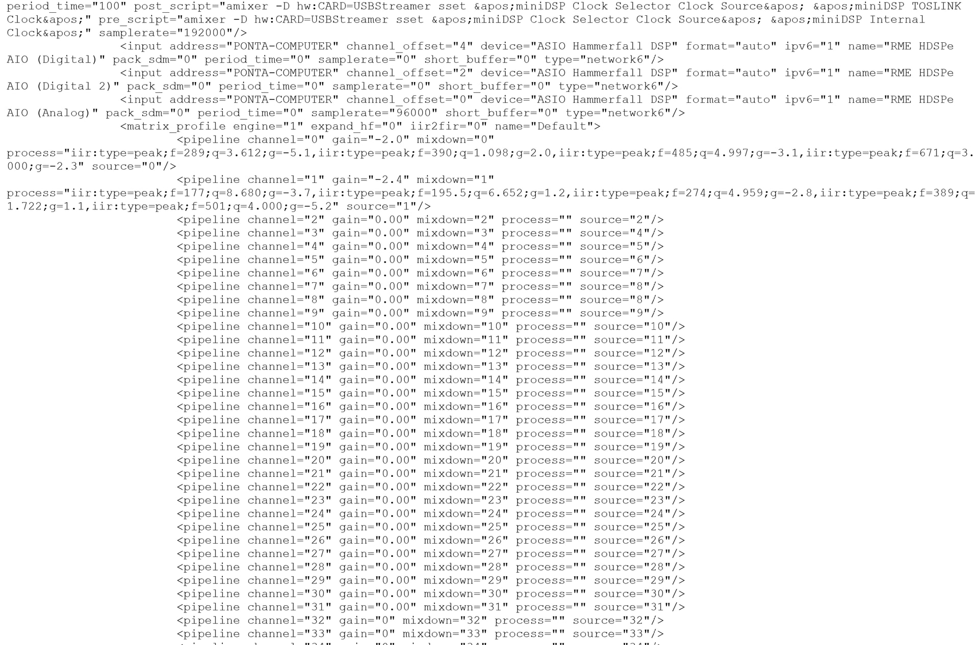

How about my configuration file?
Is there something wrong here?
That looks fine too.

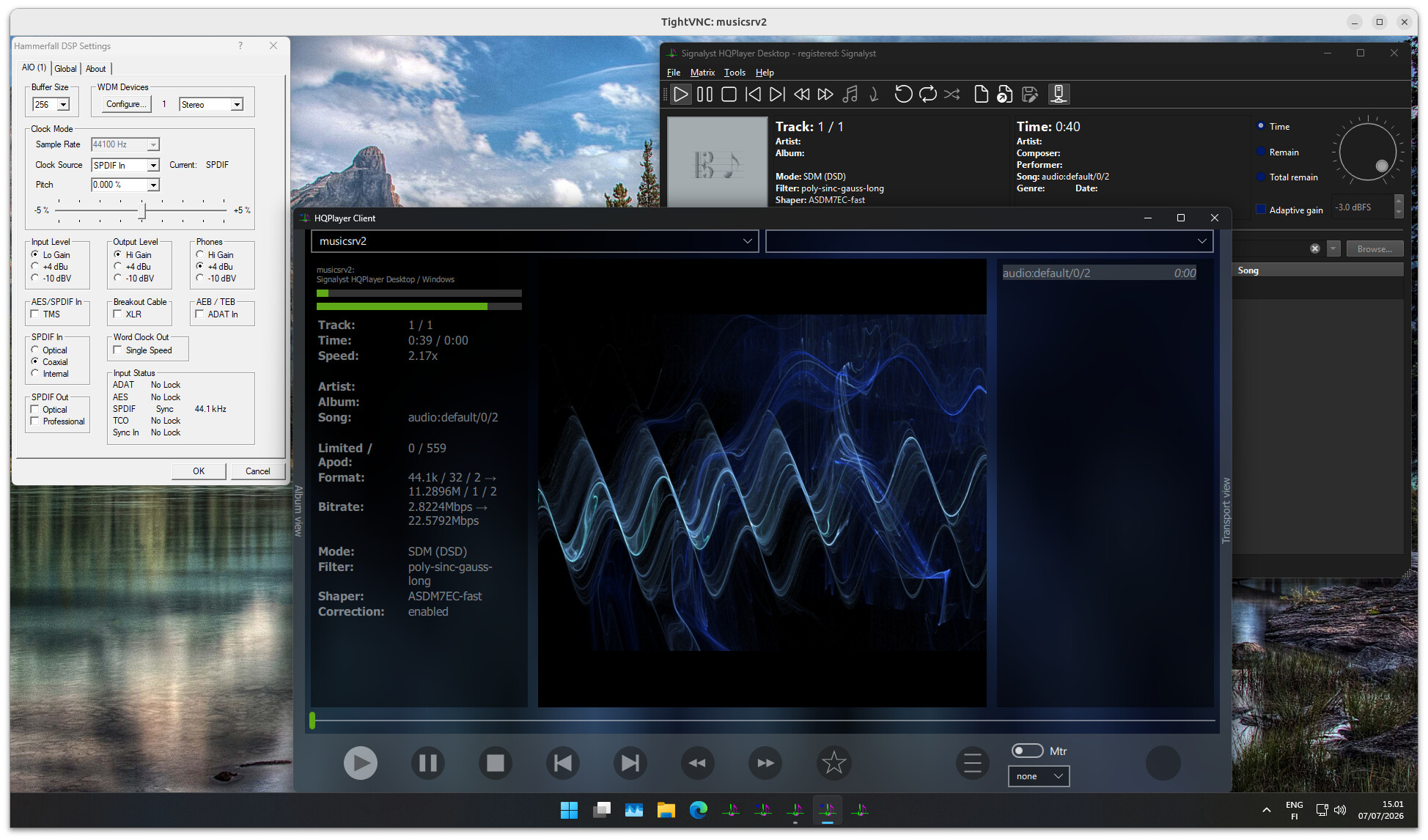

It is of course possible that the newer AIO Pro is somewhat different in behavior than the older AIO I have (two pieces). Or something else slightly different. Most of the time I run Desktop locally on Windows with direct ASIO input and output goes to a NAA. You could try such and see if it makes any difference in your case.
This screenshot is iPad playing Apple Music to HQPlayer, automatic rate switching working too.

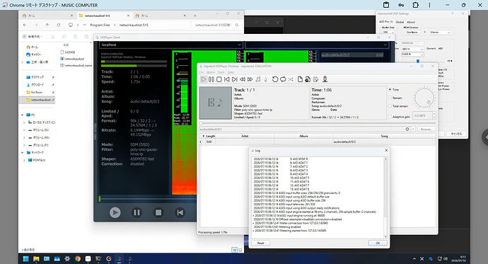

So, I tried the Desktop, but the external input basically didn’t work at all, with the exception of a playback once…
I can’t even reproduce the situation, so I’m not sure what made it work for that one occasion.
Roon works fine, though.
OK, that is really weird…
Did you check the log what was the reason?

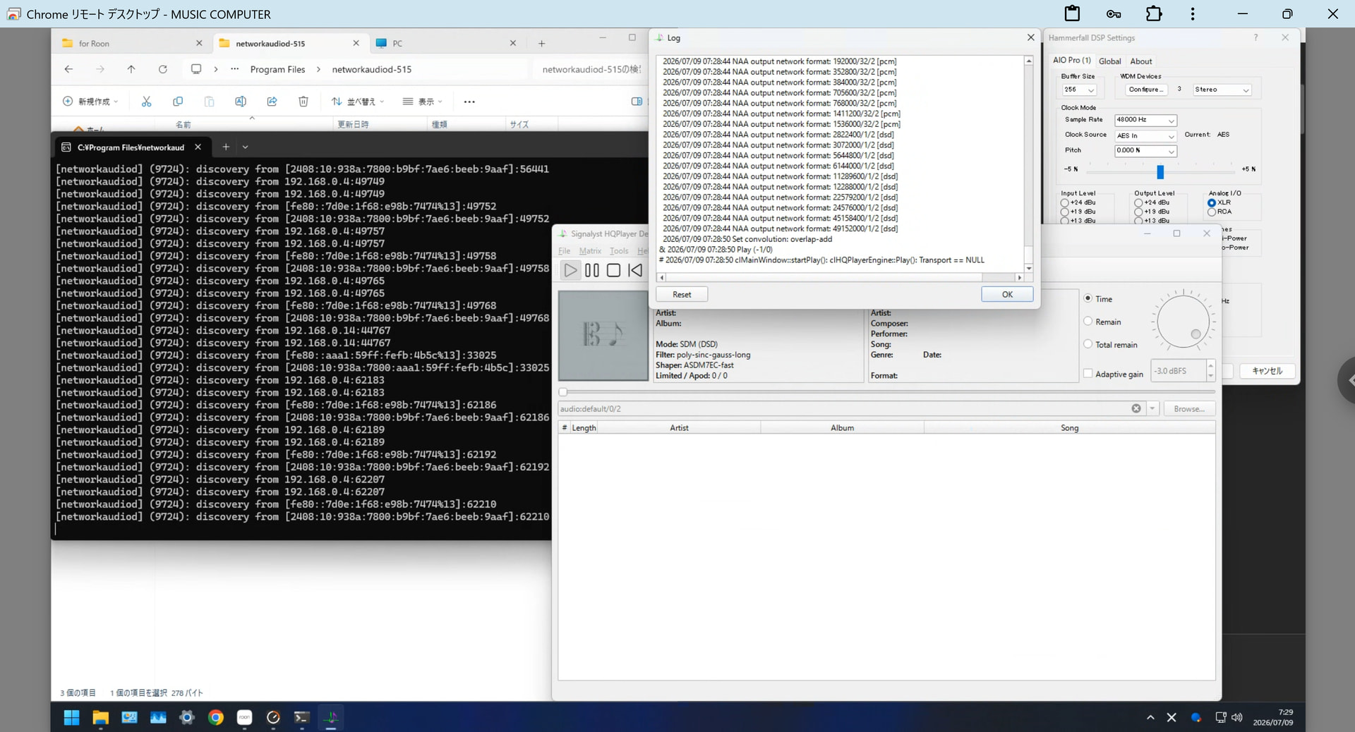

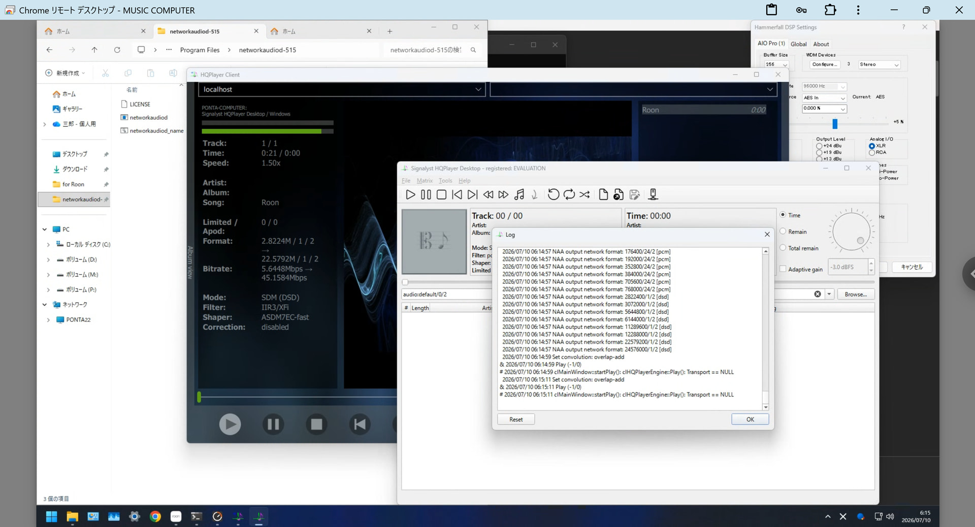

This is what it looks like:
The source section (audio:default/0/2) remains gray.

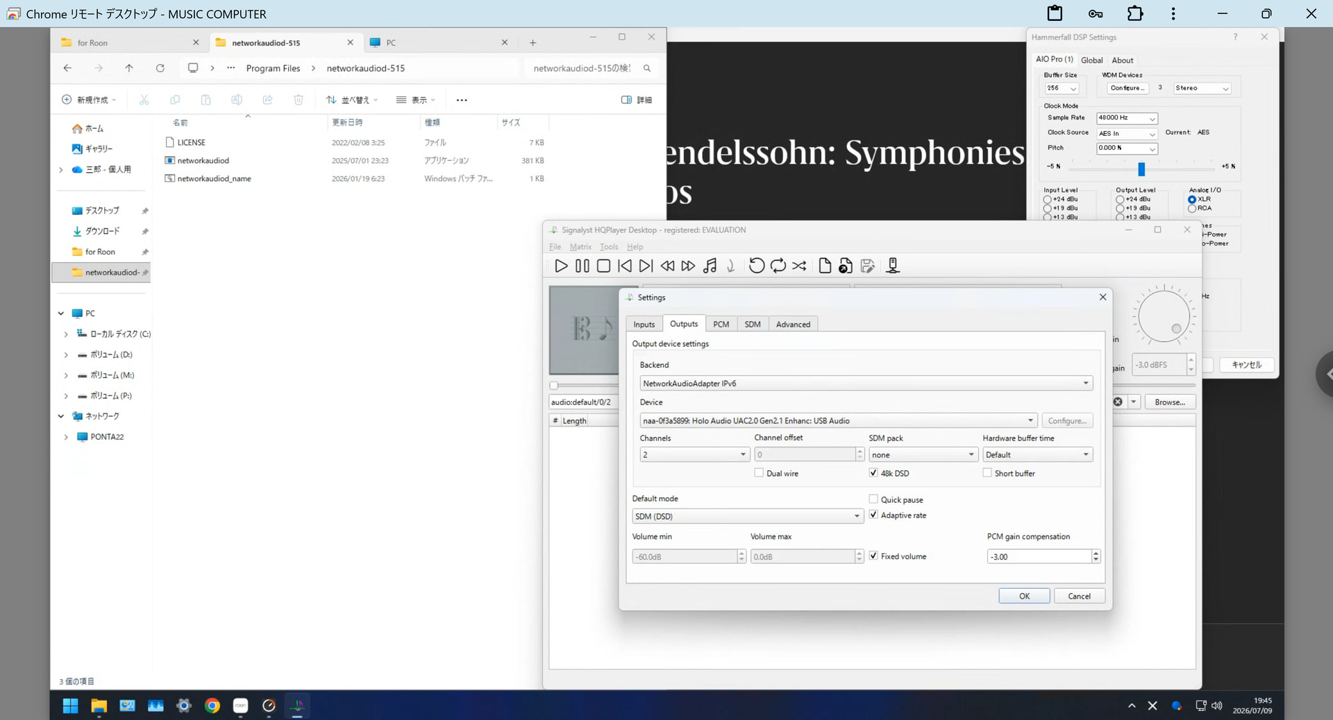

It just fails to play because the transport is empty. But why do you have a NAA running there at the same time? You have set the input through ASIO driver and output through a remote NAA?
I’ll check how to set up the transport.
I just used part of what I use for HQPe:
Windows PC (where roon core resides) (=> HQPe (Fedora 44)) => NAA => DAC
Remember to set a correct channel offset here. Offset 0 is the analog input (channels 0 & 1)!
You can refer to your HQPlayer Embedded configuration for the offsets for example. IIRC, the channel layout is also described in the AIO manual. You can also find the channel names from HQPlayer log file now that the ASIO driver is selected as input device.

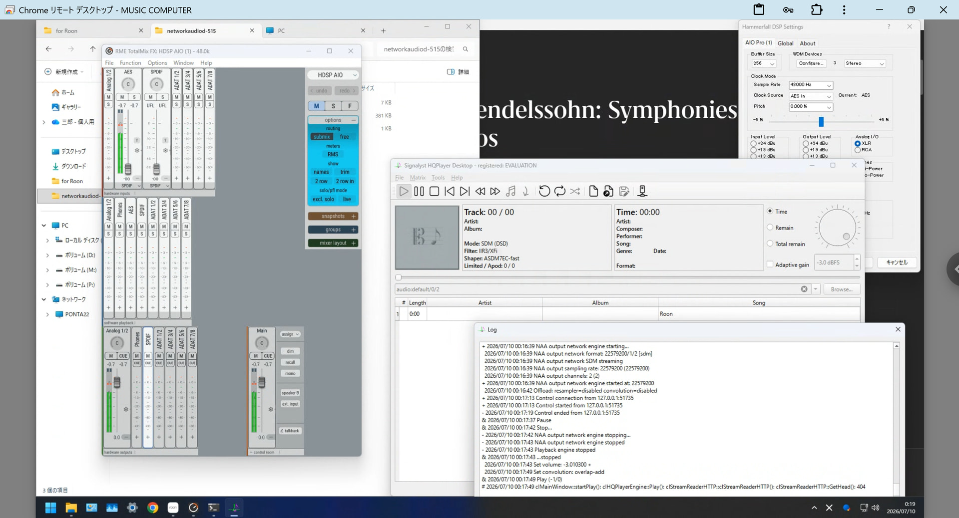

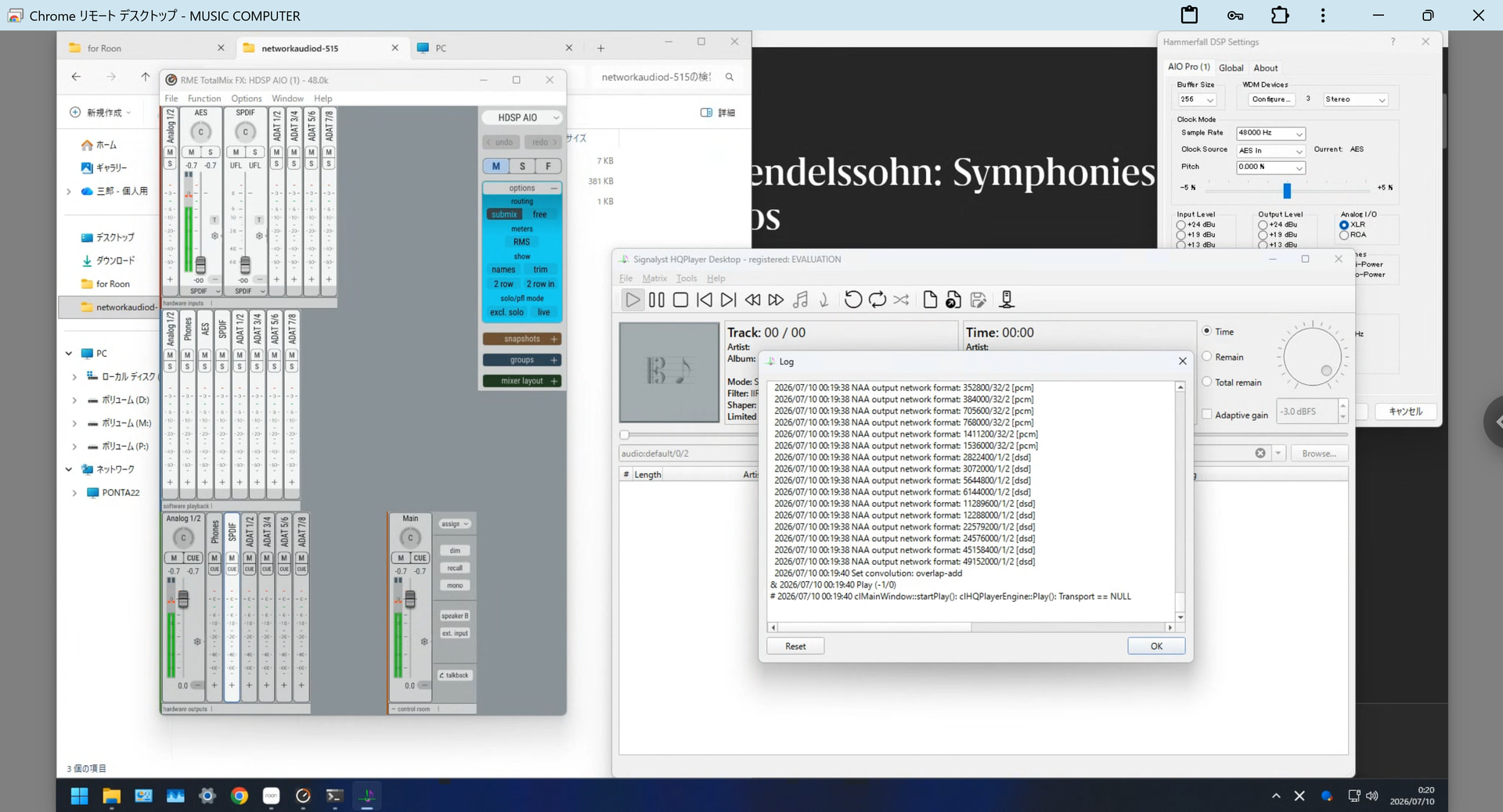

So, after setting it to offset 2, it did work ONCE.
I mean, after switching to roon, I cannot return to the external digital input.
This persists after rebooting HQP Desktop or even the entire Windows 11 system.

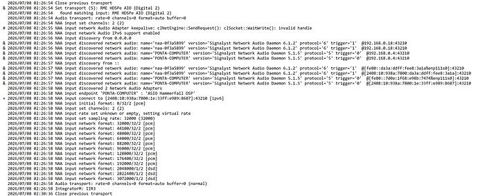

Log file states as follows:
They look somewhat similar, but different, so I pasted two screenshots.
You should be able to load the input URI to the playlist. In the latter screenshot, transport is empty and playback cannot be started because there’s nothing to play.

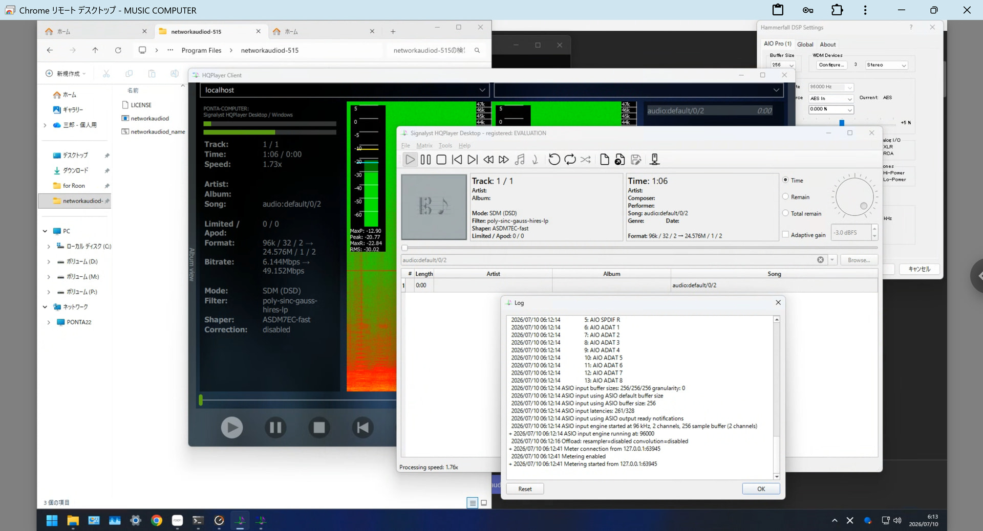

Well, I managed to play from the external digital input after launching HQP Client on the same computer with Desktop.
However, it fails after running roon and attempting to switch back to the external input.
Desktop even shuts down unexpectedly.
Below is the log file after that happens:
Once this happens, it is hard for me to fix the situation, because nothing seems to help…
