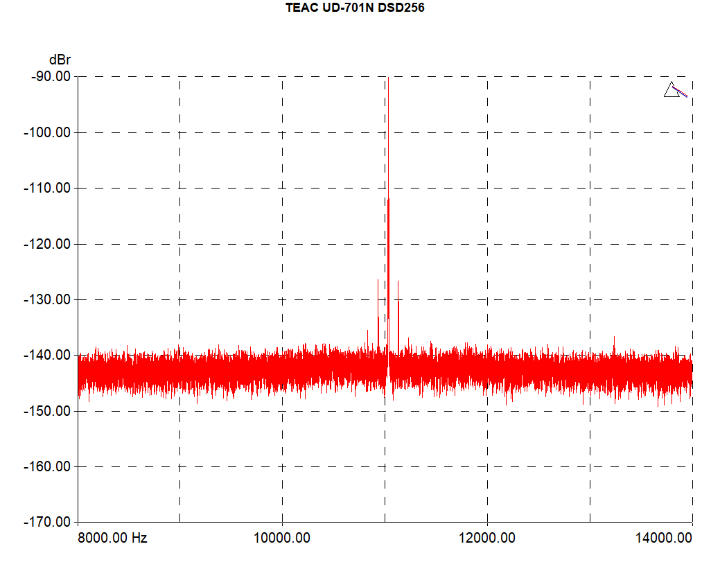

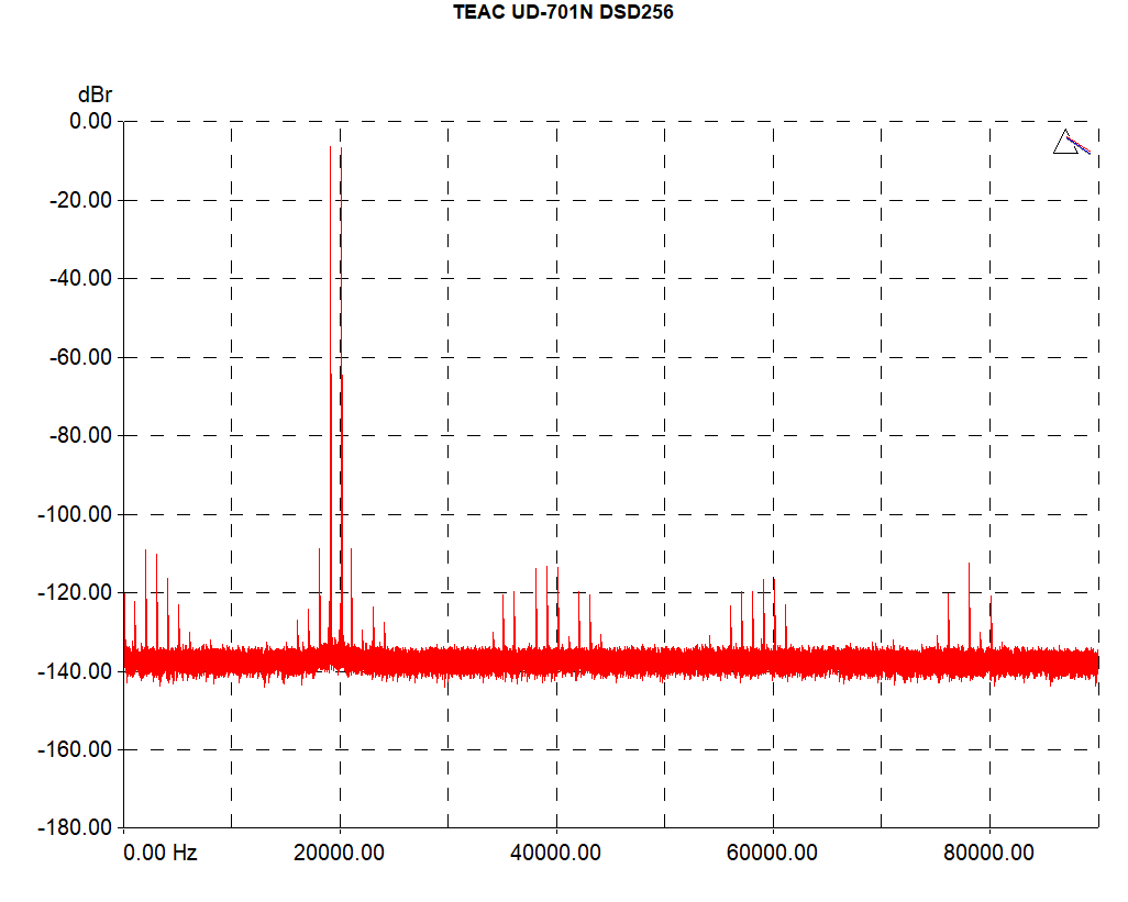

This TEAC looks interesting. How does it measure? Can you share some squiggly lines :slight_smile:

THD with 44.1k PCM input, 8x internal oversampling and multibit modulator:
Otherwise same, but internal 8x oversampling and DSD modulator:
HQPlayer filter and modulator at DSD256, DAC set to FIR1 mode:

Looks good, jitter and CCIF IMD (19 + 20kHz) plots?
And 5MHz wide band?
Supports x48k base rates?
These are with HQPlayer DSD256 output:
Yes, it supports 48k base rates…
