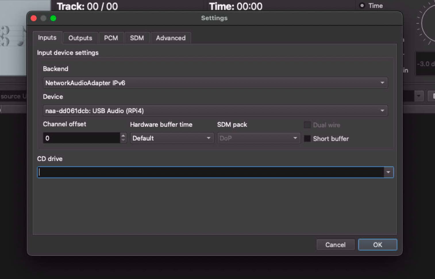

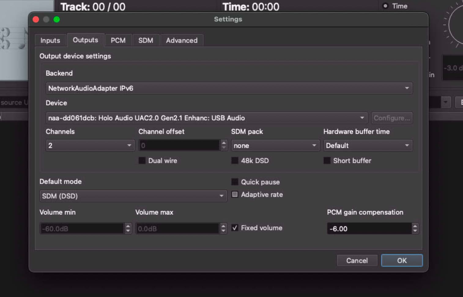

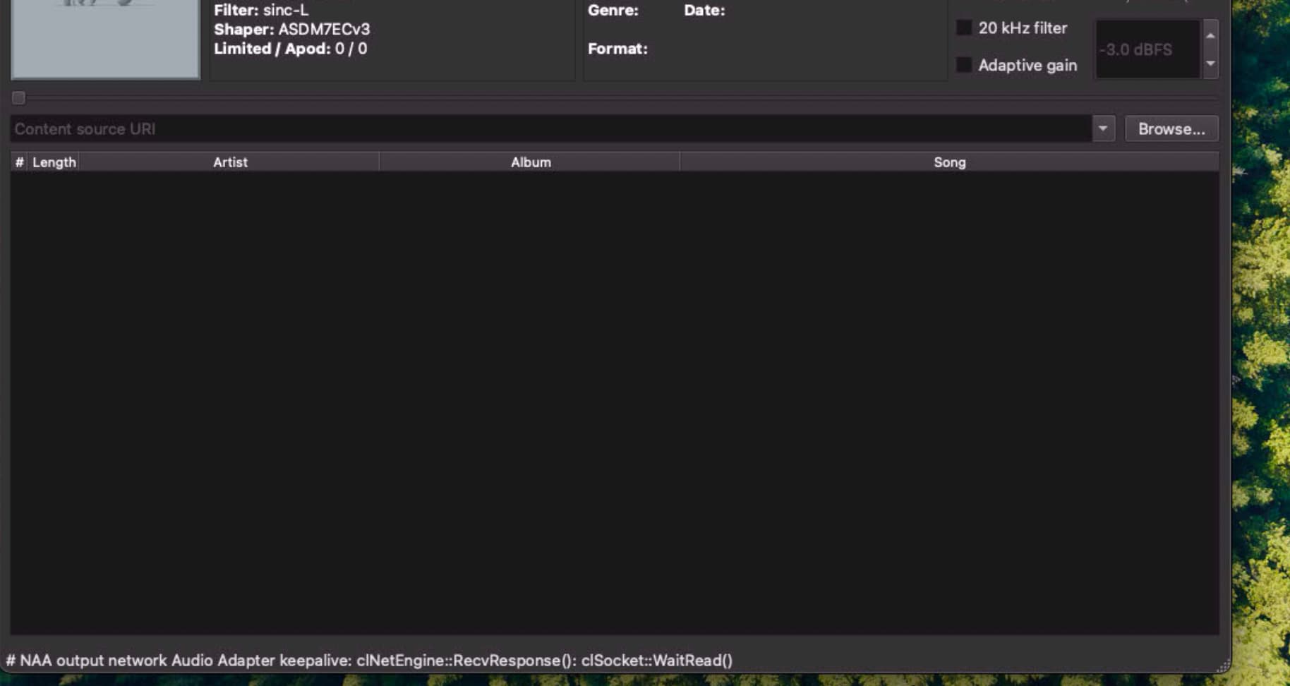

Hi all
I’ve just got myself a RPi4 and I’m clearly doing something wrong…
Help?
Roon doesn’t see the HQplayer RPi4
Presumably I put in the address of the RPi4 not the Mac mini that’s running HQPlayer?
I suspect my mistake has something to do with the input settings?
You have to put HQPlayer server ip-address to Roon settings. If it’s running on the same machine as Roon server, just leave the default “localhost” text there. Roon sends music to HQP server and HQP server sends it to HQP NAA endpoint and so on.
Also double check that you have correct device selected from the HQP output settings. With Holo, there’s usually two options.
Also, here are the official instructions for setting up Roon → HQPlayer link:
It is also imporant to pay attention to the last bullet point there. It is most common source of problems…
