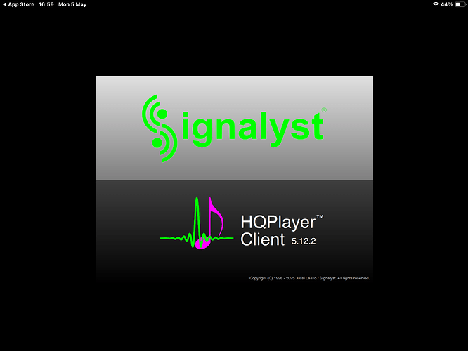

HQplayer Client 5.12.2
App quits after launch.

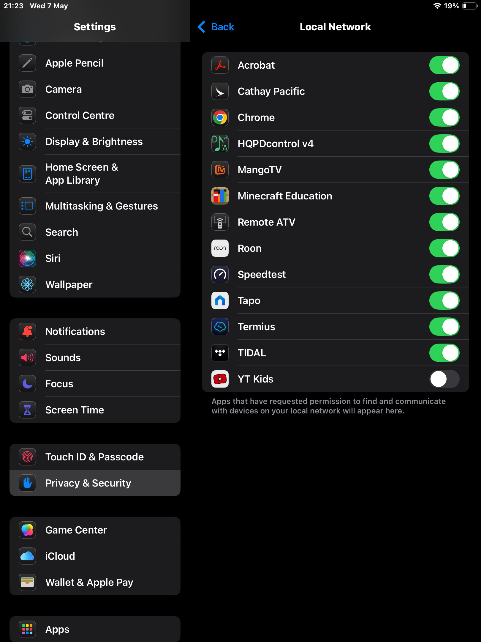

Already:
:white_check_mark: added network permissions under privacy
:white_check_mark: uninstalled and installed again
Problem still same.

Edit
Loads the first screen and quits:
Edit :writing_hand:
HQplayer also not showing on network/ It happened to me too, I was able to get it back by pressing power button and thumb bottom button, but although is showing is still crashing at launch.
@jussi_laako here the same (app quits, 5.12.2) on iPad 5th gen iPadOS 16.7.11
