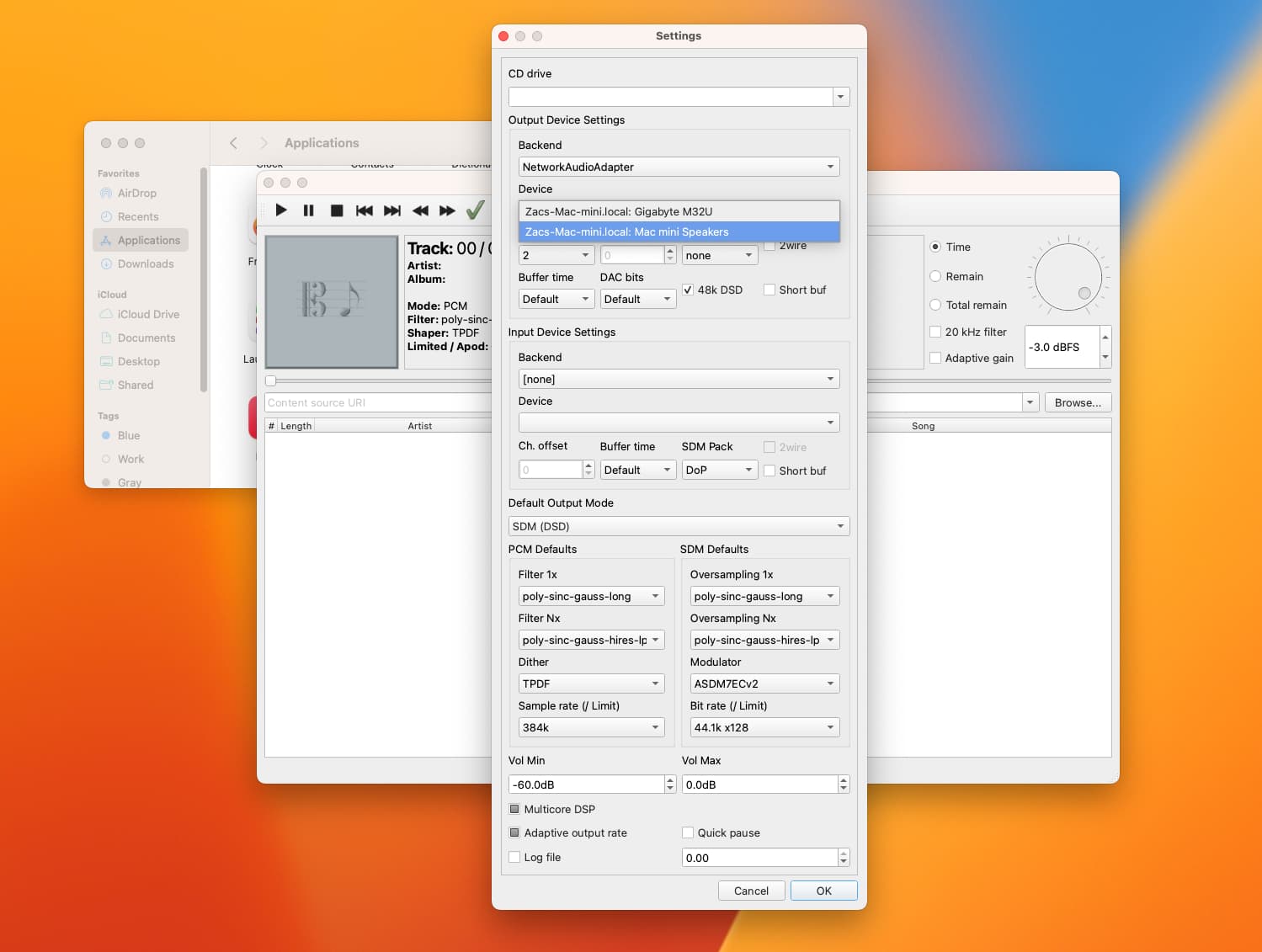

HQPlayer no Devices Found (Network Audio Adapter)
Post here you HQPlayer settings please … and why installing networkaudiod (aka NAA) on your Mac?

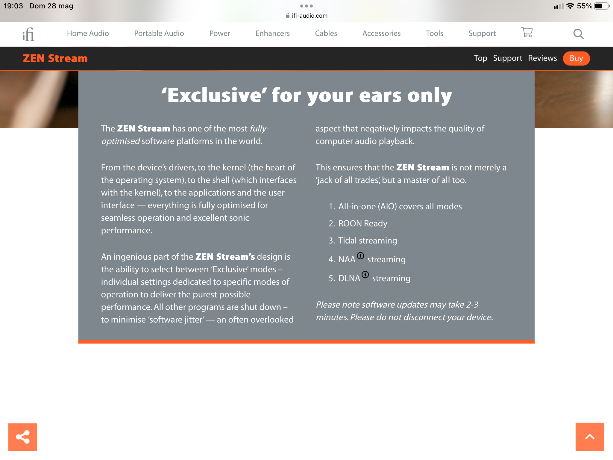

Have you set the Zen Stream as NAA?
And is you dac connected to the Zen Stream and powered on?
The right sequence is:
  • connect the dac to the Zen and power it on
  • power on the Zen
  • start HQPlayer
HQPlayer settings are basically irrelevant until I can actually have it see the Zen Stream. Do I NOT need to install networkaudiod on my Mac Mini? It has never been able to see the Zen Stream.
Have done the correct order, yes. Just will never see the Zen Stream lol… sorry I sound like a robot.
No, you don’t … the Zen Stream has the networkaudiod (NAA) embedded
How is it connected to you network?
Ok - still wouldn’t work beforehand anyway, so I’ve just terminated the app. I appreciate your help @Stefano_Antonelli - thank you sincerely.
Both are hardwired and I have no issue streaming in Roon to the Zen Stream which is how I normally operate.
How did you set the function selector (on the back of the Zen)?
Should be set to 1 or 4
Please check if you are in Roon only mode or AIO mode on the stream. I have made the mistake myself in the past.
Also make sure that you have not accidentally disabled the NAA service (yes also something I have done)
Other than that HQPlayer should find it automatically

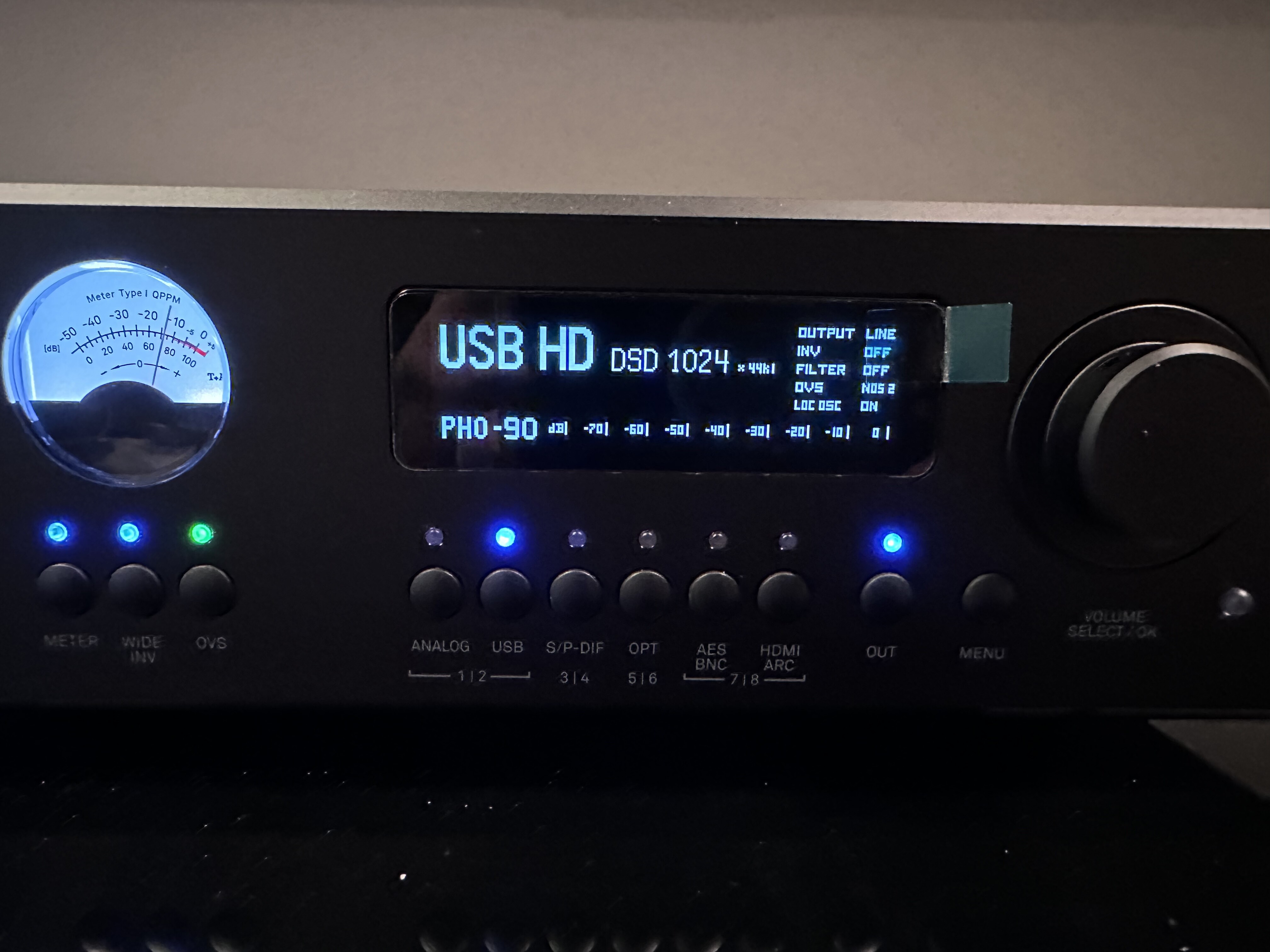

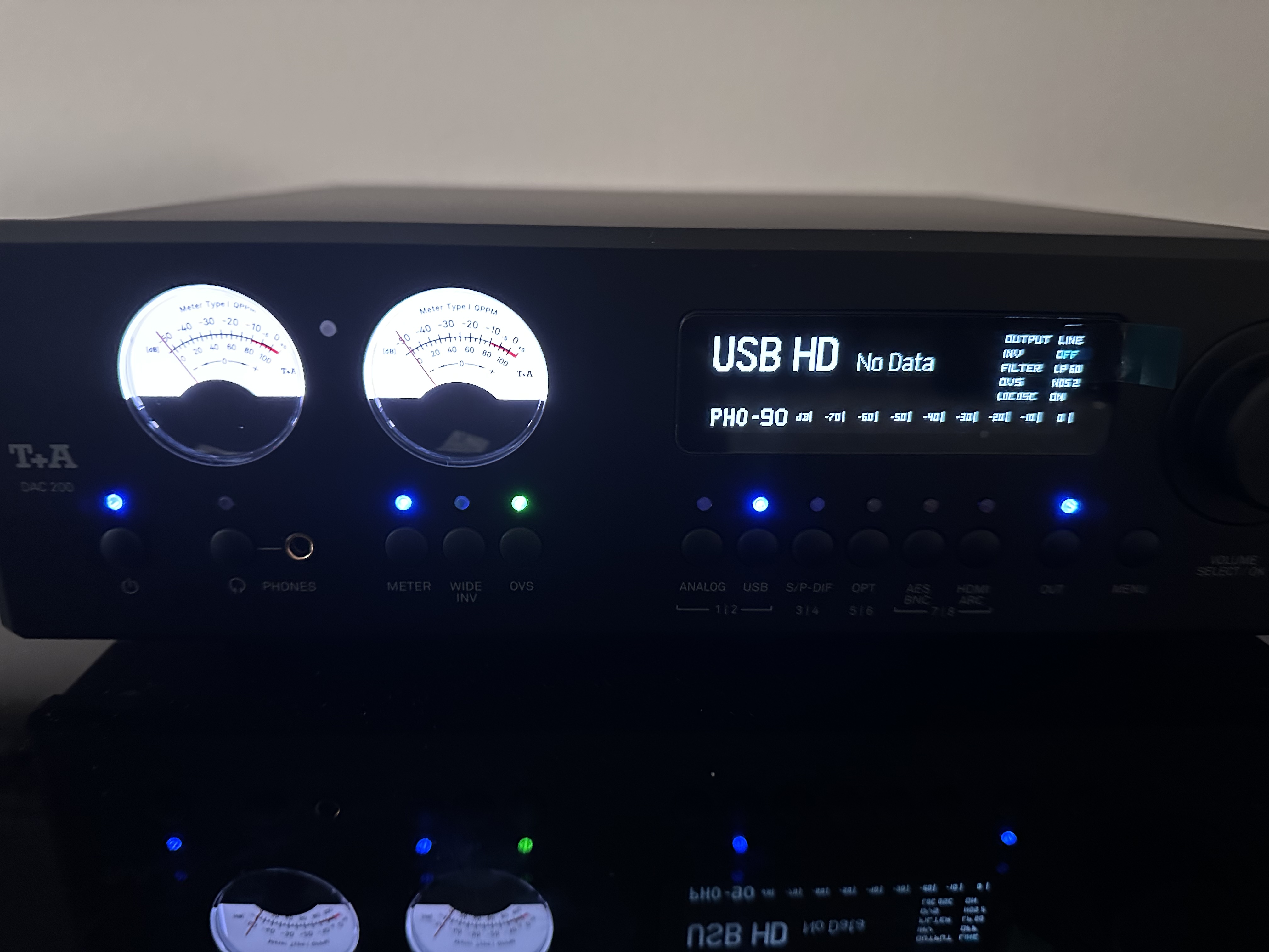

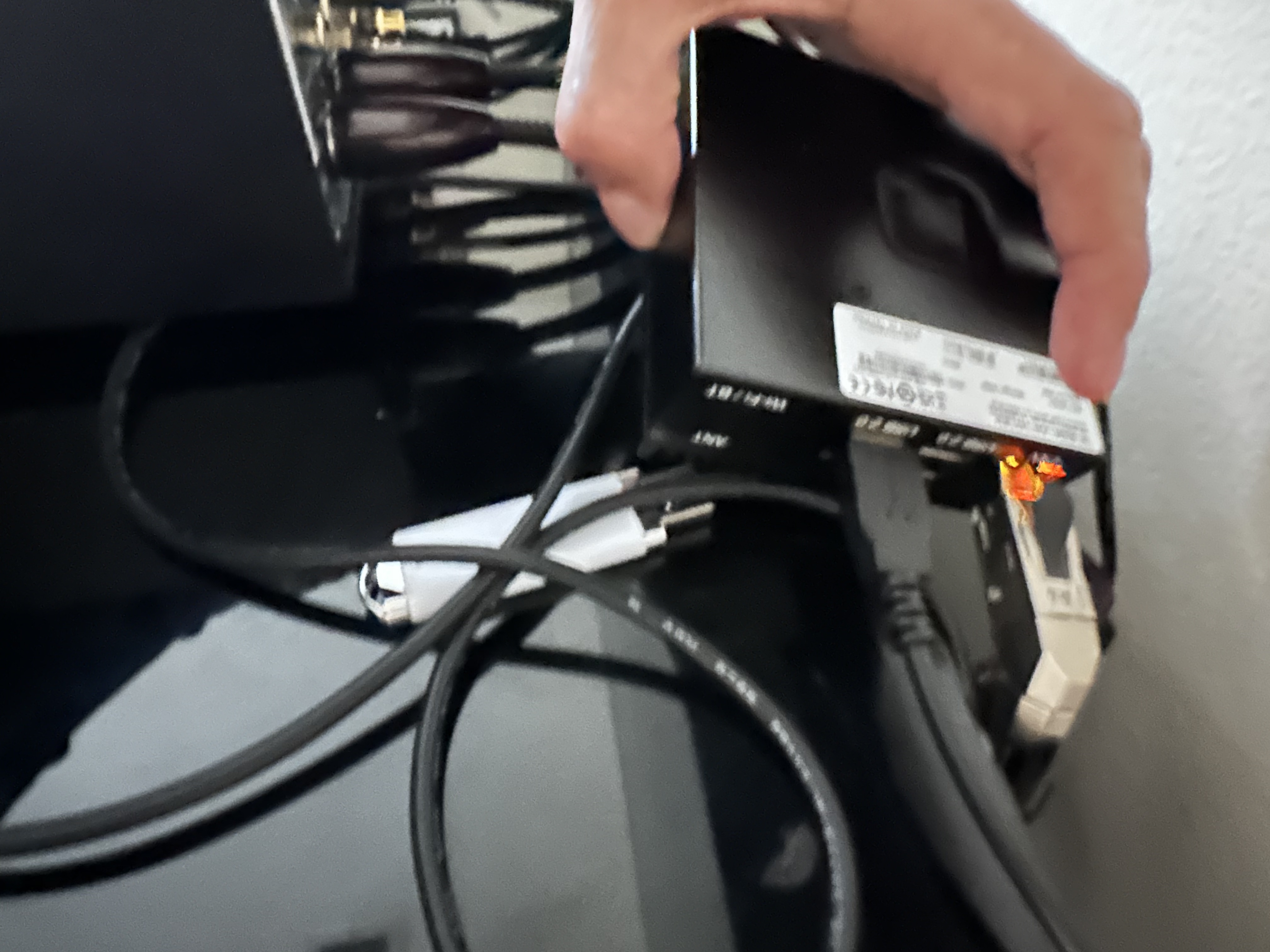

Hi guys.

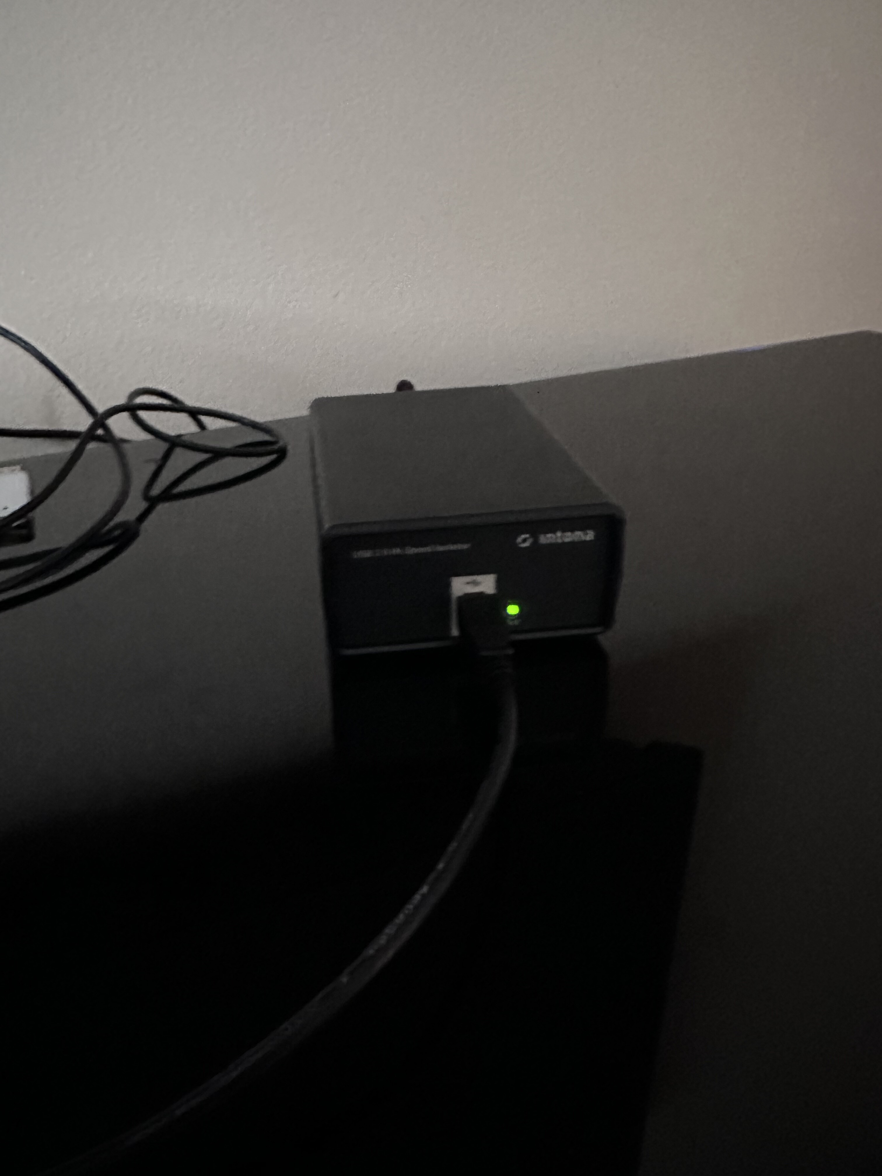

So I received my UP Gateway and miraculously (as a non tech guy) managed to flash the image and boot it up from a usb drive! Thank you @dabassgoesboomboom @jussi_laako

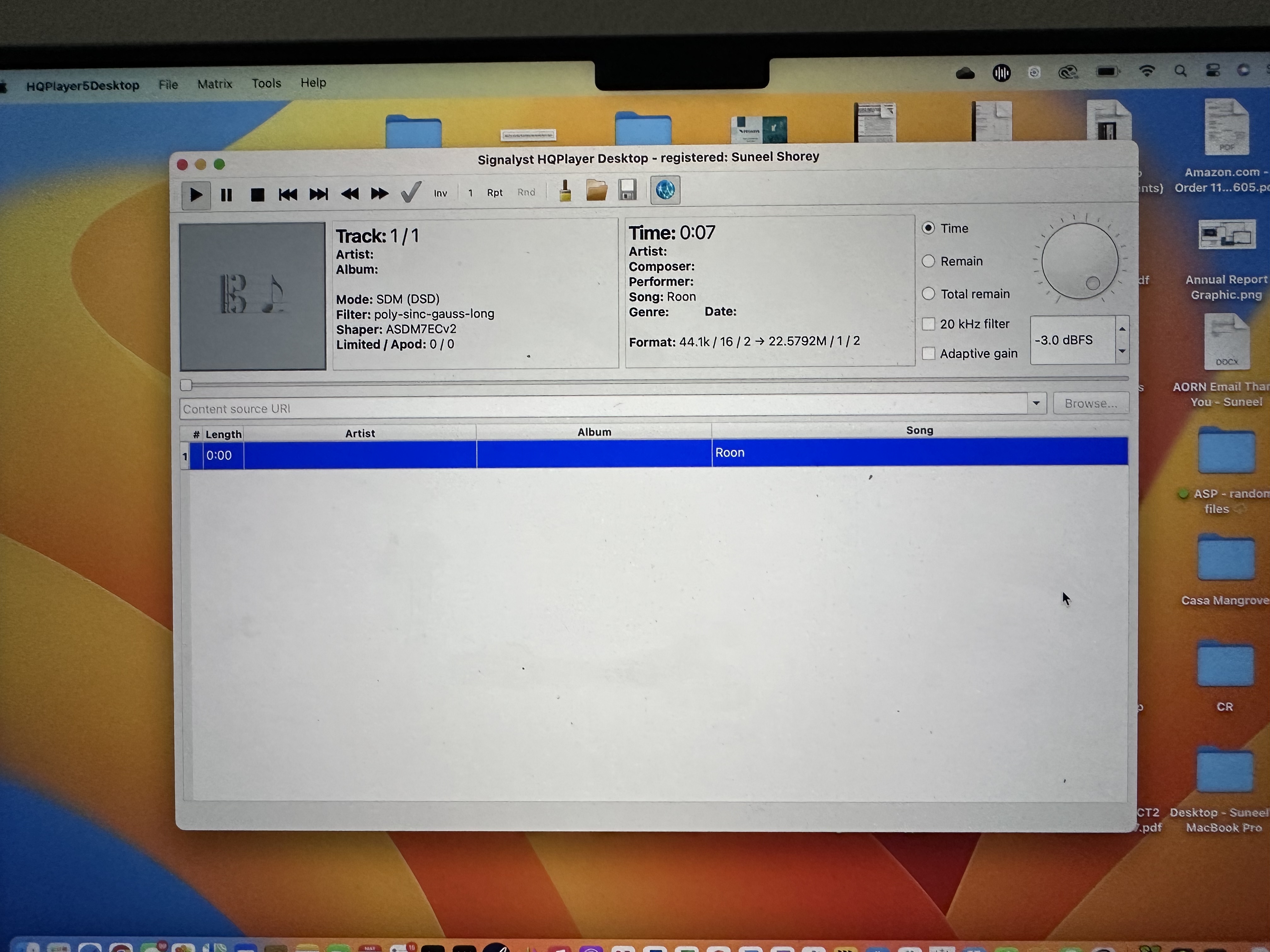

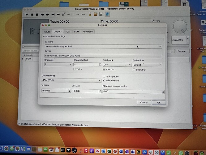

I’ve connected my T+A Dac 200 via usb to the intona isolator which is then connected via usb to my NAA.

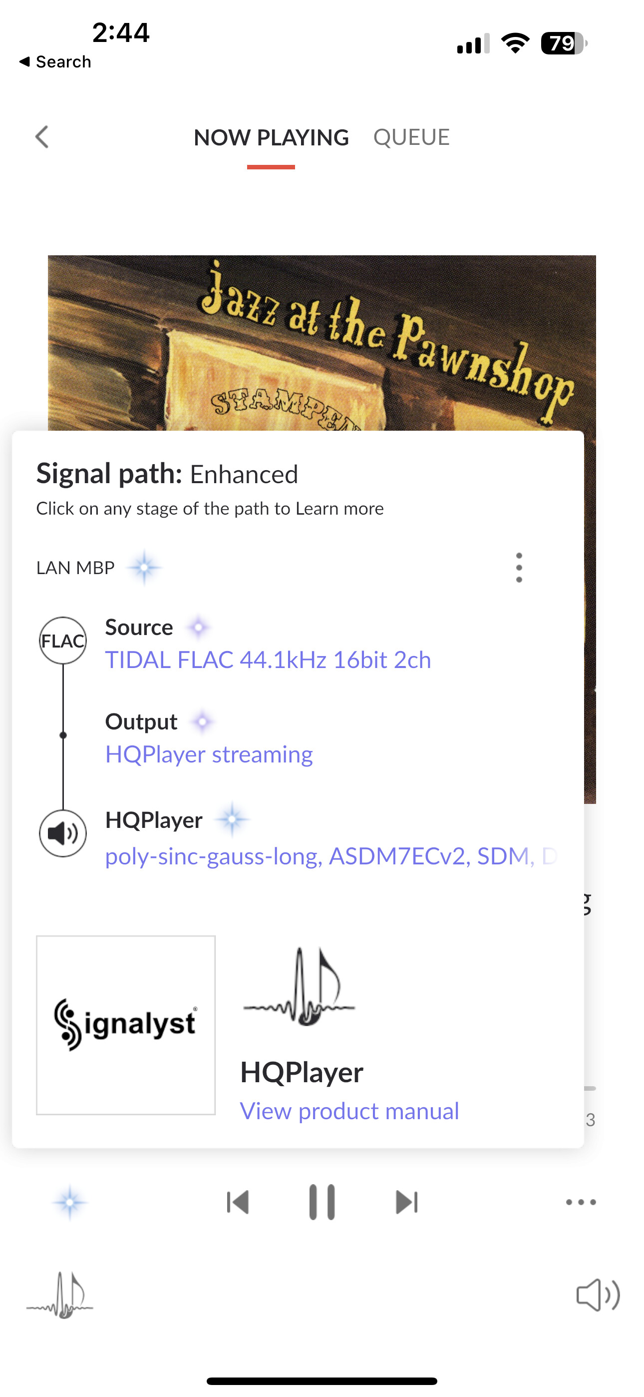

My Roon core is on a networked (Ethernet) Roon Nucleus and I’m playing HQP on an M1Pro MacBook Pro with 16GB of RAM.

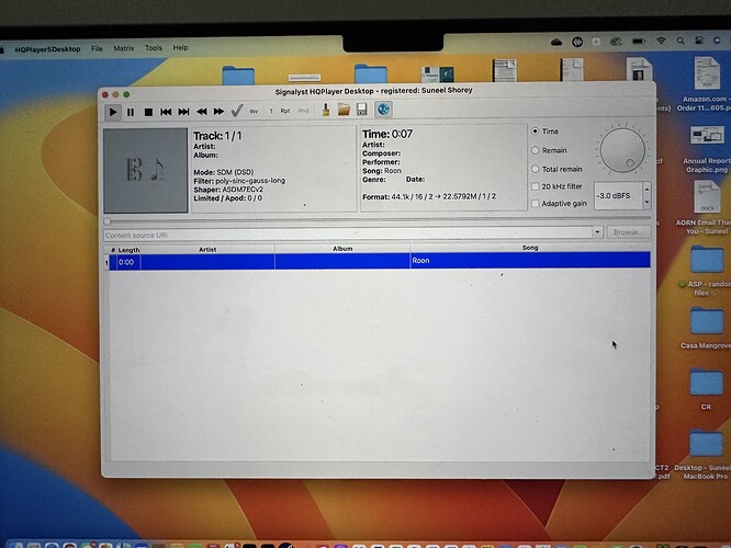

So……I’ve played around a little and the max output I can get is DSD 256. Whenever I try for 512 or more, my HQP detects the Roon signal input but it doesn’t make its way to the T+A
Any thoughts and guidance would be really appreciated!!
HW setup pics too:

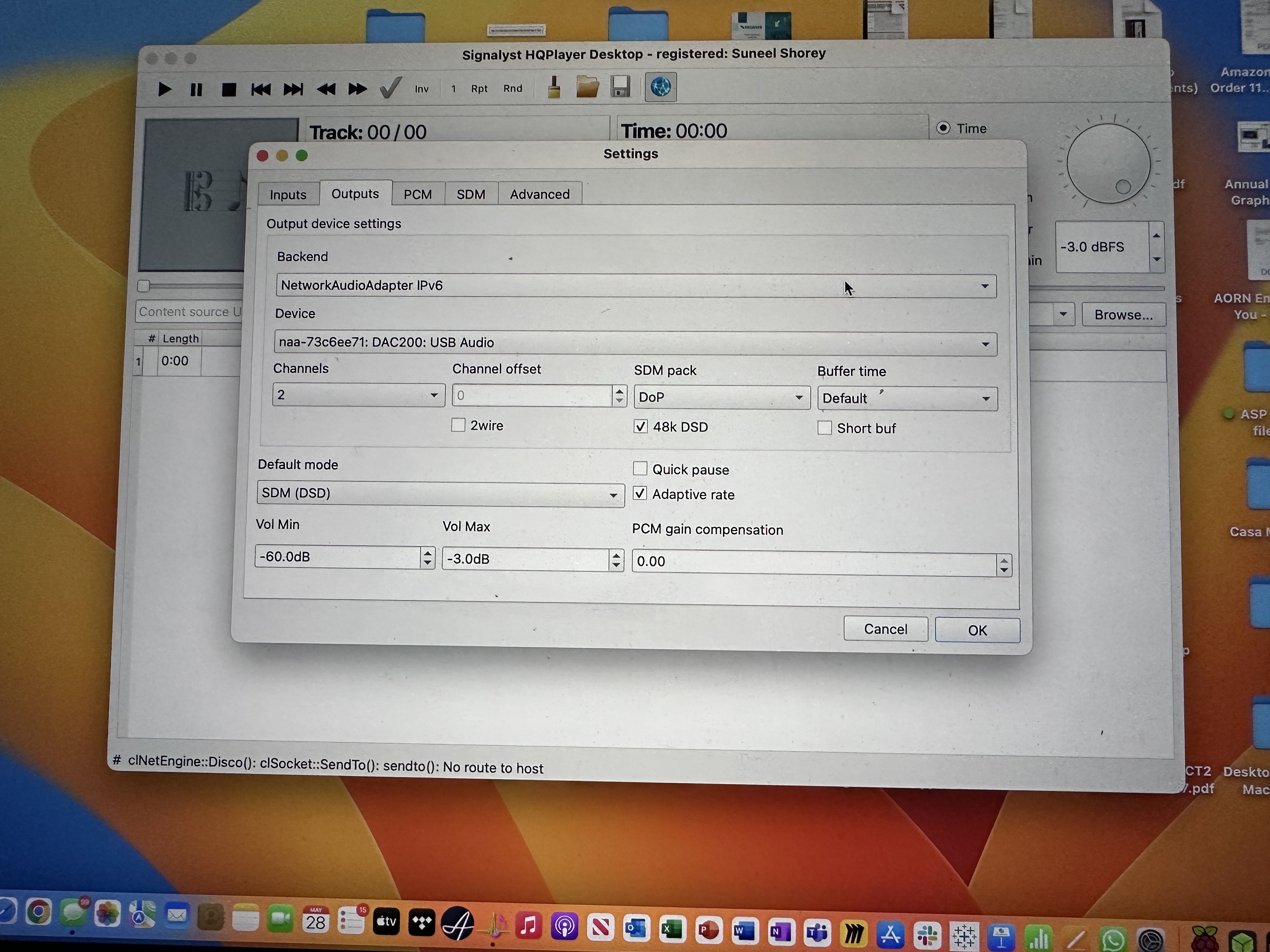

Set SDM Pack to “None” and it will work.

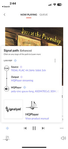

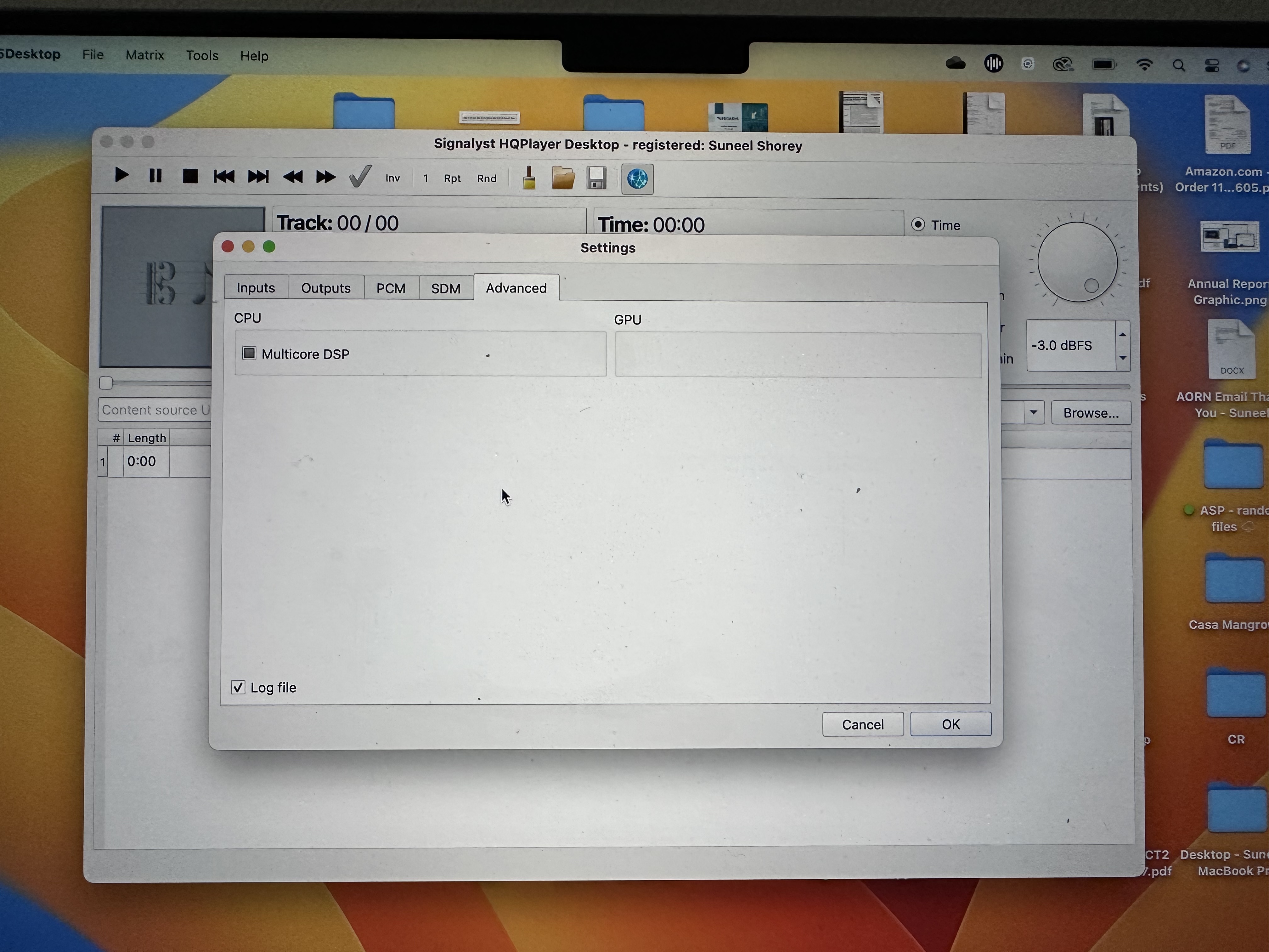

You are right….I have intermittent drops (not signal dropouts to the DAC but intermittent pauses is the best way to describe it). I guess my M1Pro chip cannot handle HQP for DSD 512…… Any other settings I can use to lighten the load?
It works - thank you!!!

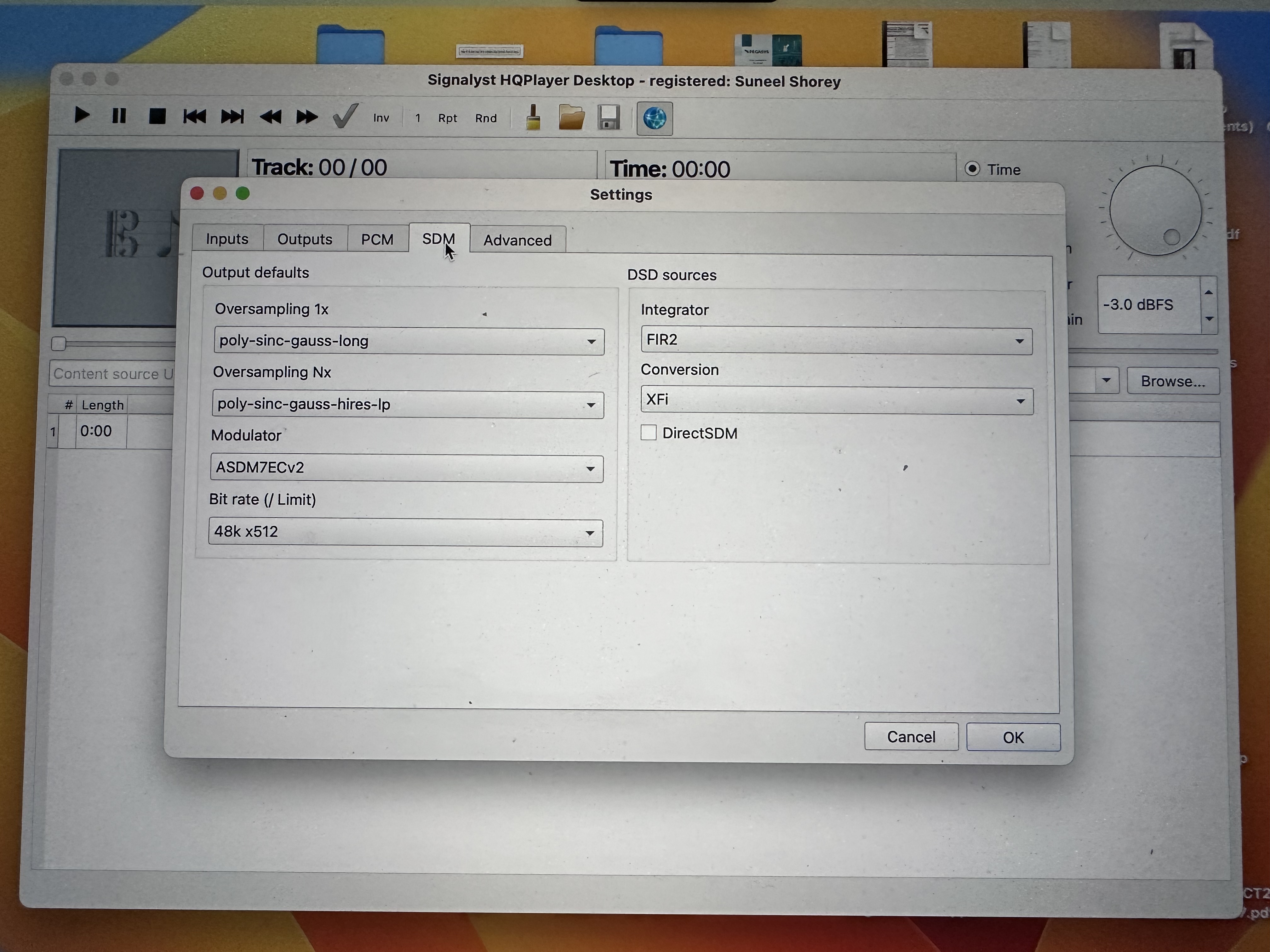

Per my note above, seems like my processing power still isn’t enough to upsample at DSD 512.
Need to make a call on a Mac mini with M2 pro chip or a gaming spec machine…
Greyed out the Multi-core dsp and went for a non-EC modulator (ASDM7). Guess I need to invest in a better cpu!
If EC modulator at DSD512 is what you want, M2 just barely does it.
13900K has more headroom (even without GPU). With GPU you unlock more of what HQPlayer can do with filter’s because the filtering gets done by GPU and CPU is left to handle modulators - load sharing
I have an 11900K without separate GPU - very easily doing DSD512 with all modulators and I stick to 1x = gauss-long and Nx = gauss-hires-lp filters
I Don’t feel a rush to add a GPU for 2 years now but I made sure my case and powersupply are ready just in case
