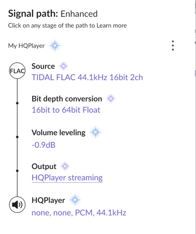

The signal path is as below:-
I cannot see how to upscale to DSD files in HQPlayer so I have only tried to upscale PCM files.

Well you don’t set up scaling in hqplayer in roon since hqplayer is its own software. Once roon has sent the audio to hqplayer, roon is out of the picture. That would be the line that says Output. The line below is informational. Roon is just displaying what hqplayer is sharing as it’s upsampljng setup. In your case hqplayer doesn’t seem to be set to do any.
Open up hqplayer and set your upscaling there.
