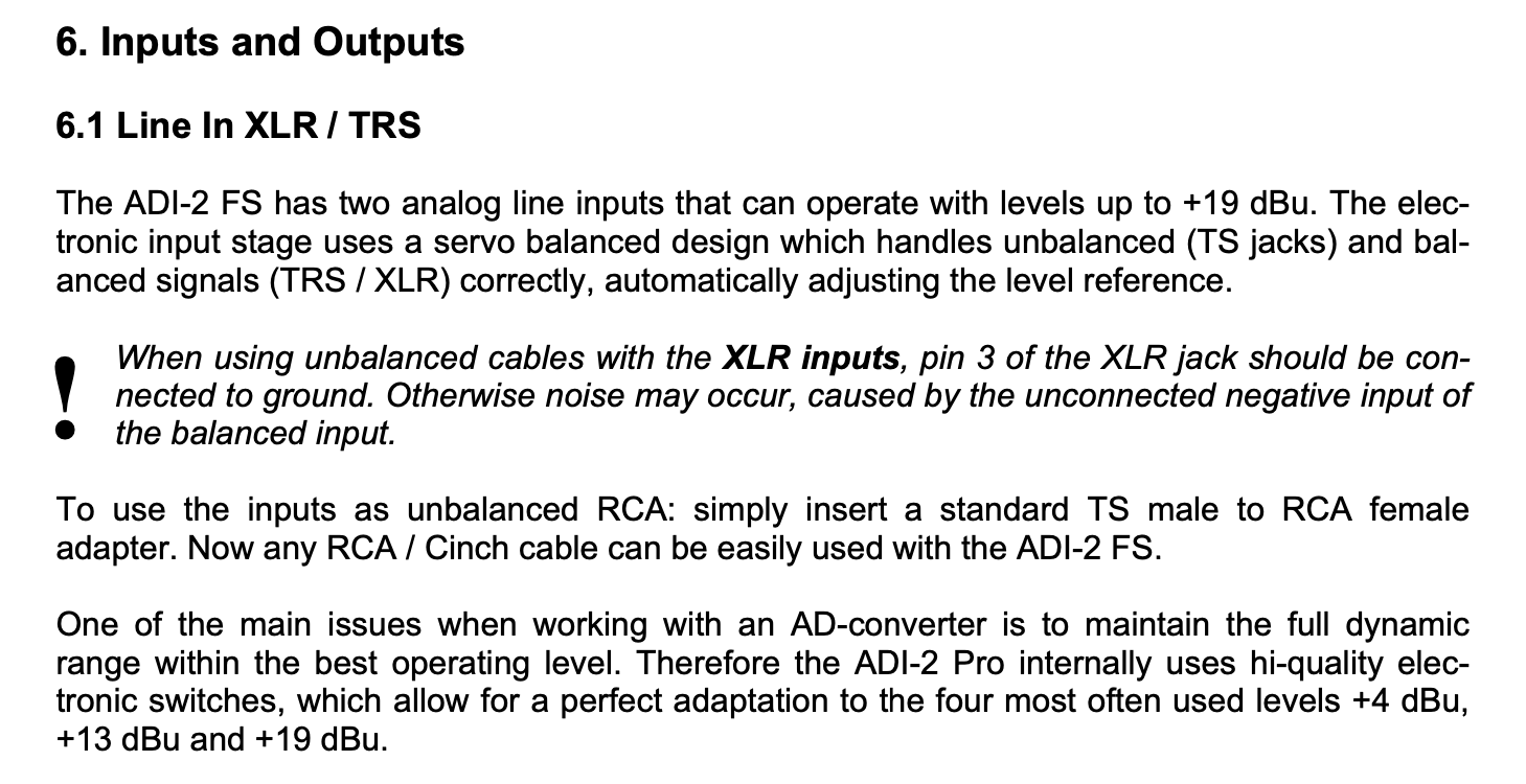

There is a cheaper RME (both ADC and DAC) that is limited to PCM192kHz but should do the same job as the Pro with this limitation. Missing AES3 in/out too. I can see analogue in, TOSlink in and digital coax in.

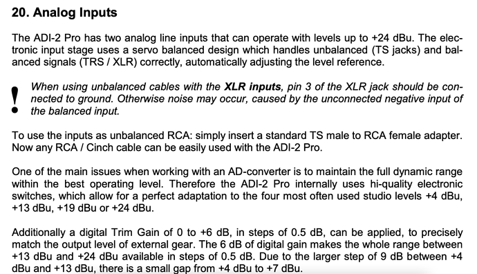

Your analogue tape deck would connect via RCA and looks like both ADI-2 models can take RCA cable (TS to RCA adapters and cables are easy to get everywhere, even Mogami make such cables)
