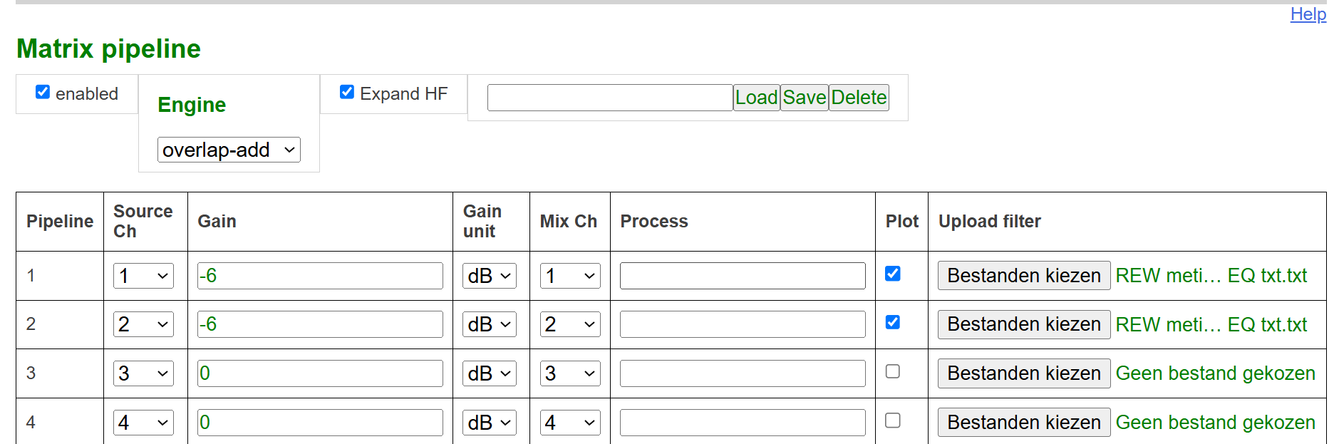

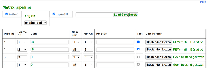

But you would just click “Browse” button for corresponding pipeline and upload the .txt. It will get added to the “Process” line. Then please use the Plot feature to check the needed gain compensation. By quick look from your EQ setup, you should probably apply -6 dB pipeline gain to compensate for the positive boosts there, so that the output doesn’t exceed 0 dBFS.

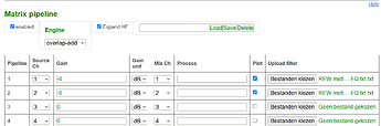

Something like this?

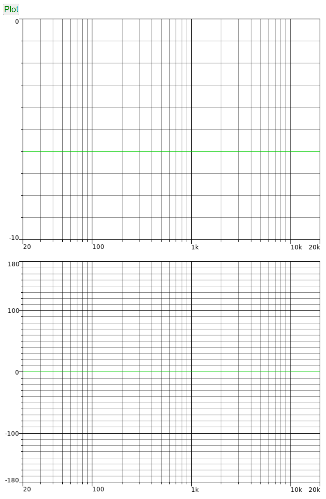

Then I choose Plot and I got this:

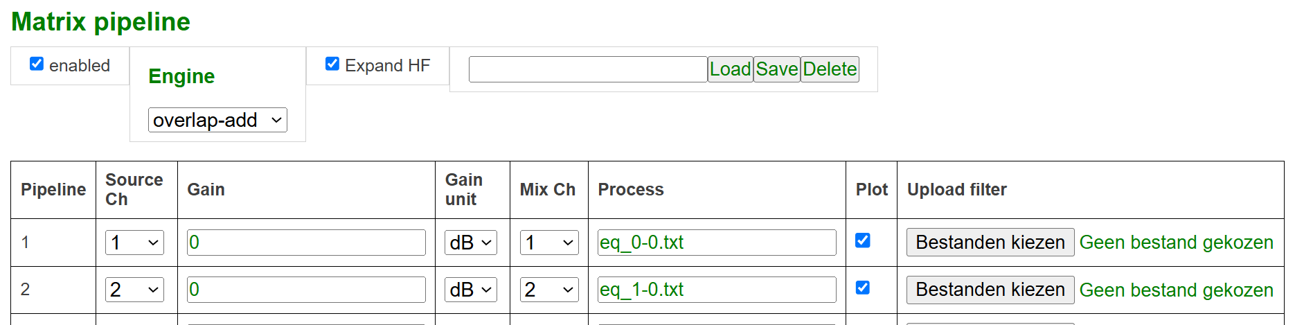

And the pipeline is empty again:
Yes, then click Apply so that the response files are uploaded.
So this step is the one missing here. After that those appear as something like “eq_0-0.txt” and “eq_1-0.txt” there. You can then use the Plot feature.
Alright, I got this:
But then I have to plot which is a new advantage: nothing to move or to fill in below, just 2 green lines:
I did hope that it would be something like the PEQ in Roon, but it’s only magnitude (db?) and phase? (Plot corresponding pipeline process magnitude and phase responses) No frequency, shelfs, Q’s. Sure there is something I misunderstand.

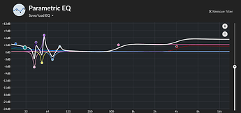

My target is to make this PEQ in HQPlayerd:
Is it possible?

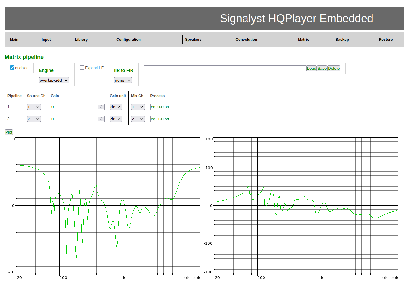

I got following response:

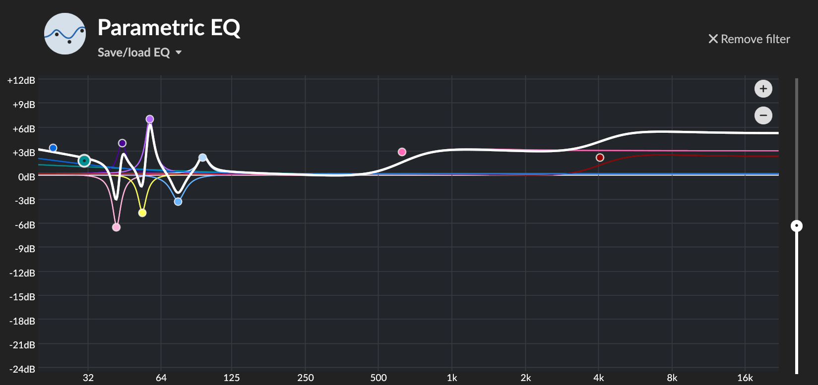

In your Roon EQ plot you don’t seem to have all those 20 bands?
Thanks Jussi,
First of all, it is true that the Roon EQ plot is not the same because of limiting possibilities (e.g. Q in Roon does not go beyond 10), because some frequencies were too close together and because of auditory adjustments (my ears have certain deviations, including little high). The plot of REW is how REW hears it and wants to handle it.
Furthermore, I see that you have received a beautiful graphic representation of the REW plot.

  1. The PEQ plot does not give the desired result. Instead of a nice graph like Jussi’s, it is a straight green line for me. Unfortunately, there is no follow-up to this topic. Of course, it could be that I’m doing something wrong.
