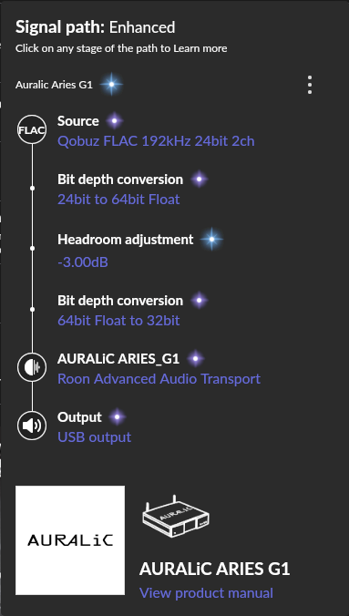

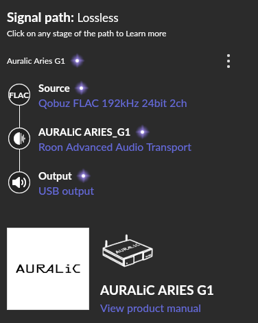

Welcome to the forum. Fellow user here. Please post a screenshot of your signal path with and without headroom management
Screenshot 2023-06-03 at 16.50.30
Thank you for replying to my post. Before and after posted as requested.
Thanks, it was always unlikely but I was wondering if maybe the performance indicator might show the Core struggling with DSP enabled, but not at all, so that’s not it.

I thought about this because the output is 32bit after DSP, but it’s still weird. The 32bit output after DSP occurs in the same way for 44.1/16 files, so I don’t get why there is a difference with 192/24 for @Dalbir_Virdee
My Naim NDX2 also advertises 32bit input to Roon and so it’s the same signal path for me as it was here, but I don’t see any issues like this.
The downsampling after DSP will theoretically introduce more errors but the differences should be tiny and probably not audible. In any case you can try with 16bit files
