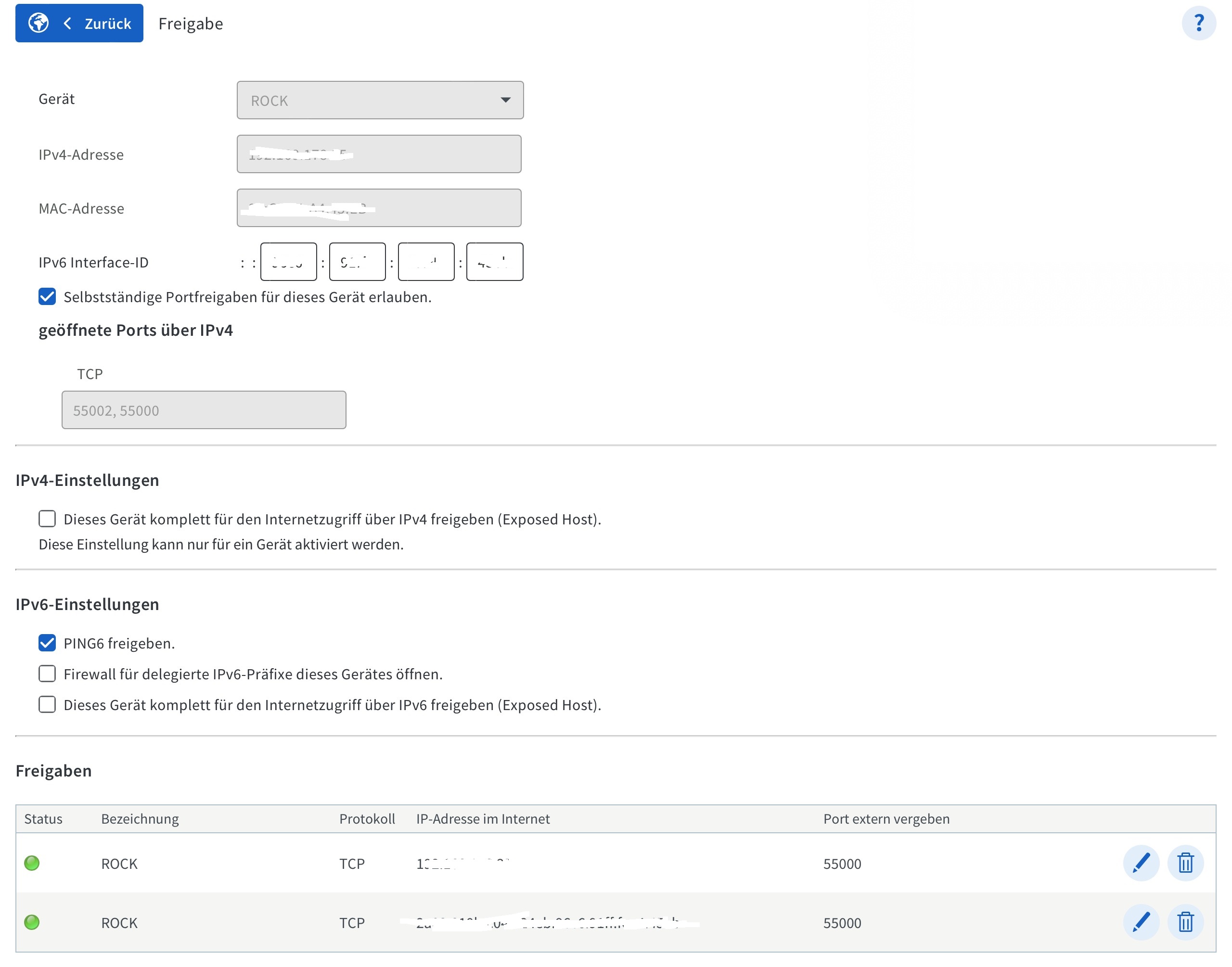

So, here is what I did:
  1. configuring ARC in ROON: → port 55000
    tested… ROON shows success, server can be reached by ARC
  2. Fritz!Box Internet/Port Forwarding (see screenshots)
test in WLAN - successful
test extern (t-mobile, 5G) - error! no connection!!! ;-(
Can you see anything that’s wrong?

I assume you get this in the Settings->ARC:
From what I see, your settings are correct, and should work. :+1:
Now, I don’t know about Vodafone DS-LITE, but if you connect your phone to a WiFi (not in your house), you should be able to connect (and by doing so verify if that is the problem with the t-mobile connection or not)
