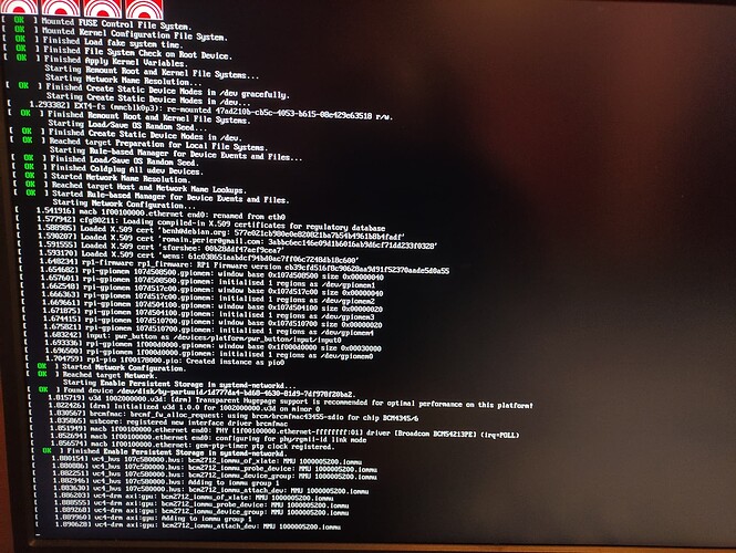

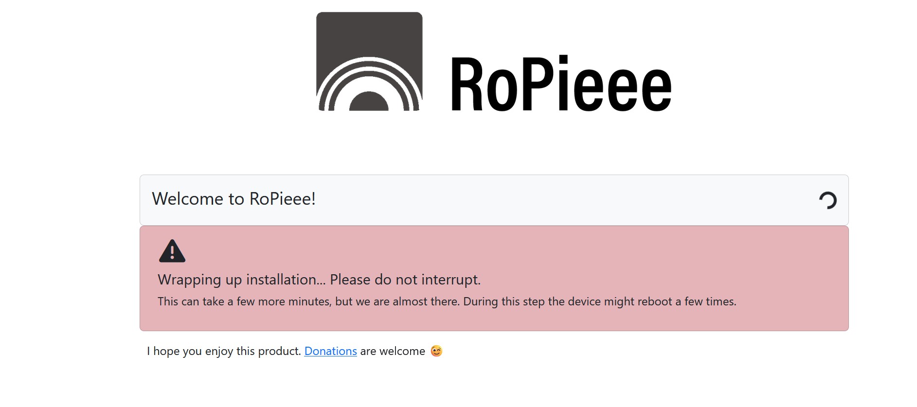

I have a Raspberry Pi 5 with 8GB of RAM. I tried installing various Ropiee images for the Raspberry Pi 5, using 16GB and 32GB memory cards. The result is always the same: after starting the installation and several reboots, the green LED blinks frequently as during installation, but nothing happens for an hour. The Raspberry Pi 5 is connected to the router with a cable. Other operating systems, such as Volumio, are installed. Is it possible to install Ropiee on a Raspberry Pi 5?

I have the same problem after try to upgrade old version to latest. RaspberryPi 4b with RoPieee is in this state about 3 days. I try to power off and power on a few times and nothing changed.
Can it be because of network issue?
Yes, that could be. Assuming you have a DHCP enabled network, with access to the internet, everything should work just fine.
I resolved it! In my case it was a network problem with smth of this
