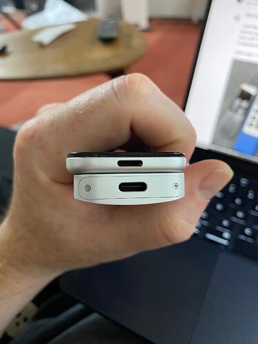

Mine is also the version with the USB-C port

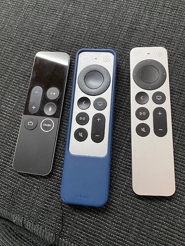

I just tried with three different Apple TV remote’s, and non of them seem to can wake the amp. Are you sure you can turn on the amp with the volume on the Apple TV remote? Can you also turn it off? Can you remember if you only used the Hegel remote to “teach” the Apple TV remote to operate the Hegel amp?
Left to right - Older, newer (Lightning) and newest (USB C version)
It’s not clear what the Apple TV remote actually can do. And I don’t understand what you should use a remote from a TV for, if you don’t have a TV with that brand.
Mine is the small black one. I can’t remember exactly what I’ve done, it was in April 2023. Just followed the instructions. Clicking 3 times on the mute button of the Samsung or the Cable Box remotes switches the amp off. I don’t do it with the Apple TV remote because I don’t know where is the mute function and the amp will turn itself off after 15m if not in use. But the Apple TV remote definitely turns it on after the TV is on.

Ok then that may explain it. The black version is older and definitely not USB C. The bottom remote is USB C. There’s no mute button on the old remote :slight_smile:
You’re right. It’s thunderbolt. Sorry.
