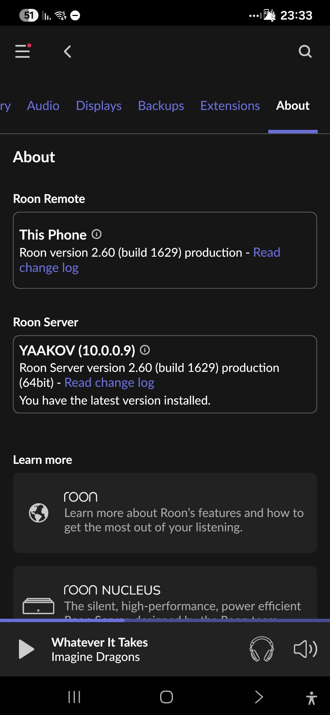

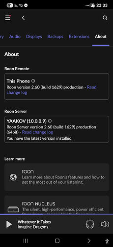

What’s the version of your Roon Server?
The version I have installed is Roon 2.60 (Build 1629)
And your phone app is the same version?
I’m asking because there there were recently several cases that looked just like yours, which were caused by having different versions from different release branches installed together (typically 2.60 Production and 2.59 Early Access) which can’t work.
If you have all 2.60, I’d recommend opening a support ticket: go to → Support and then click Get Help
Ok, so all being 2.60 and it’s not this known issue with the mixed versions. I’d recommend the official support ticket, then.
