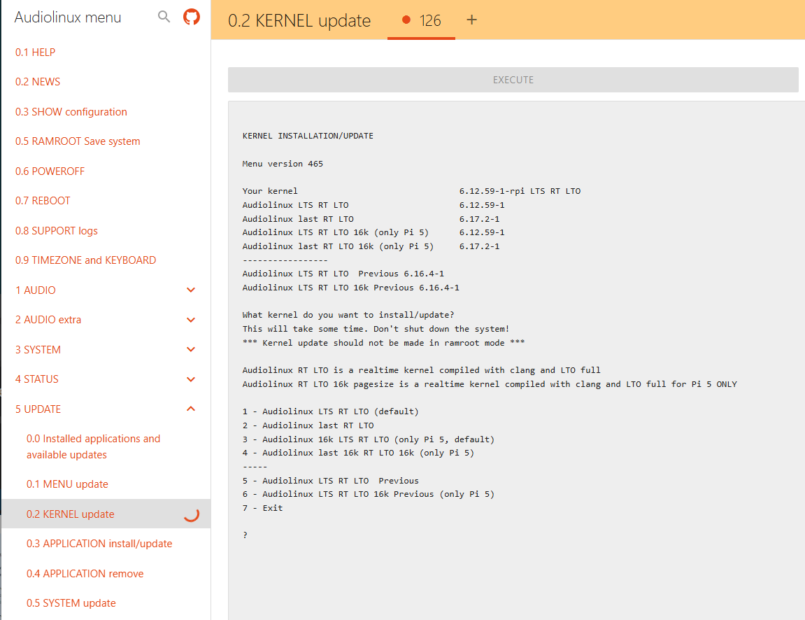

Hey @David_Snyder , please did you manage to turn off EEE on internal NIC on RPi5 ? If so can you please let me know the kernel version where it works? I’ve been trying it with up to 6.12 kernels if i’m not mistaken and it was not supported by that time (the main reason i’m using PCIe NIC with RPI5). Thx!
You are correct. I don’t recall which sub version of 6.12.x brought EEE for RPi5 hardware, but it works with 6.12.59. I don’t think it was working with 6.12.42.

You probably just need to update to a newer kernel. I hope this helps.
I cannot go higher then 6.12.55. Are you sure that you are on 6.12.59?
I am now using 6.12.55-251026-RT. I don’t know if that is the best kernel, or that I better go to 6.12.55-151026 (so no Real Time). Anyone an idea/experiance at that level?
I’m not familiar with that menu. Is that AudioLinux? Here’s what I see from the Web UI:
