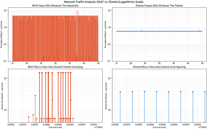

You inspired me to try to capture this effect visually. I just ran a fresh network capture on my Diretta Host to compare the Input (RAAT, left) vs. the Output (Diretta, right).
The Top Row - 30 seconds at 32-bits, 88.2 kHz
This shows the throughput (Mbps) over time. I had to use a logarithmic scale here because the differences between RAAT and Diretta are so large.
  • RAAT (Left): You can clearly see the “Sawtooth”. It bursts up to ~100 Mbps to fill the buffer, then drops to zero, then bursts again. That violent up-and-down is what causes the “Race-to-Idle” power noise.
  • Diretta (Right): It is a “Flatline”. It’s a constant, calm stream of data hovering steadily around 6 Mbps. The CPU never has to sprint; it just jogs steadily.
The Bottom Row (4-Millisecond Zoom)
This zooms in to see individual packets during a 4ms window.
  • RAAT (Left): You see a dense “clump” of packets hammered into the interface back-to-back, followed by silence.
  • Diretta (Right): You see the “Drip Feed”. Packets are perfectly spaced, arriving with metronomic precision.
I think these plots effectively illustrate that ‘Computer Tranquilizer’ effect you described.
Thanks again for the nudge to dig deeper into this. I wouldn’t have thought to run this specific comparison without your questions. I hope these plots help bridge the gap between the logical idea of a buffer and the physical reality of what’s happening on the wire!

Yet, network traffic is not noise. The assumpton is that “tranquility” results in less noise, but there is no evidence to support this, so far. I hope you do explore this further.
Likewise, it is unclear if the DAC is controlling timing or Diretta essentially behaves like S/PDIF, where there is no signalling, and the DAC has to reclock.
Describing this as a “quantum jump” causes me to scratch my head. Is it messing with timing, or altering the stream? I don’t find the argument that less network traffic in the final hop very convincing since noise is ubiquitous. Nor the need for a real time kernel. Low latency would make more sense in audio-intensive scenarios, but for an SBC doing nothing but processing a simple 44.1 kHz stream, this should be unnecessary (after all, it is Diretta that schedules the transfer, not the RTK.)
I do hope we can move beyond hypotheses. For now, I’ll sit back, enjoy reading, occassionally scatch my head, and make sure the discussion stays on track.
Correct. Yet, network traffic causes electrical activity which can generate noise.
I think David has demonstrated that the amount of noise generated at the Target can be minimized. It doesn’t have to be everywhere, as in standard TCP/IP.

I’m not disputing this, but that’s not my point, and I don’t believe Diretta is about network generated noise, either. Indeed, Ethernet rejects common mode noise effectively.
When I say noise is ubiquitous, that means it is everywhere all the time. Potentially reducing noise – we do know if this is true – in the target doesn’t reduce noise from those other sources. We live in very noisy environments, e.g. machines, power lines, Wi-Fi, microwave, radio, and so on, all affect electronic devices.
But steps are already taken to reduce or eliminate such noise. Diretta implies that the drip feed reduces noise in the target, and that there is a correlation between this and noise.
However, this isn’t proven, and there is no demonstration of this being the case. Moreover, DACs have galvanic isolation between the input stages, and the analogue output. That’s not to say that noise can’t appear at the analogue output through other means. But it begs the question: what is Diretta actually doing?
This is why this is such a head-scratcher.
