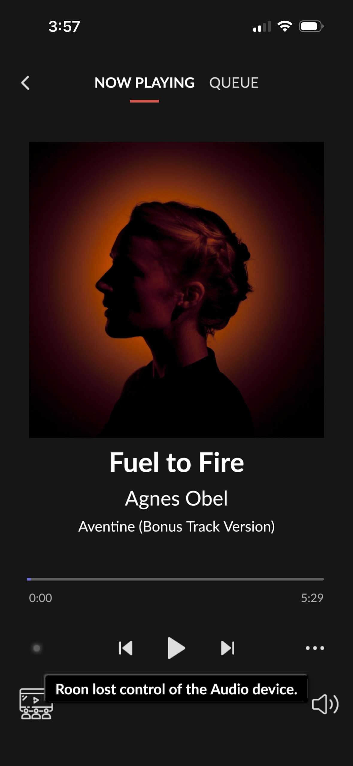

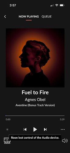

I just reproduced my issue, which is that advancing tracks multiple times somewhat quickly can result in Roon displaying an error message (pictured below) at which point the Selekt becomes unresponsive and requires a reboot. I don’t run into my issue as frequently as I used to. I’ve been trained to allow a track to get a ways in before advancing and I also think Linn may have partially fixed it. It does still happen, though.
