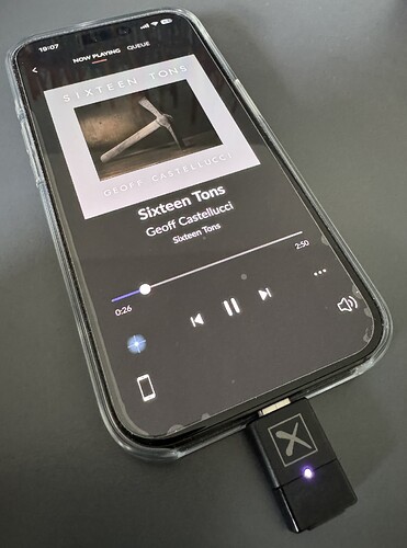

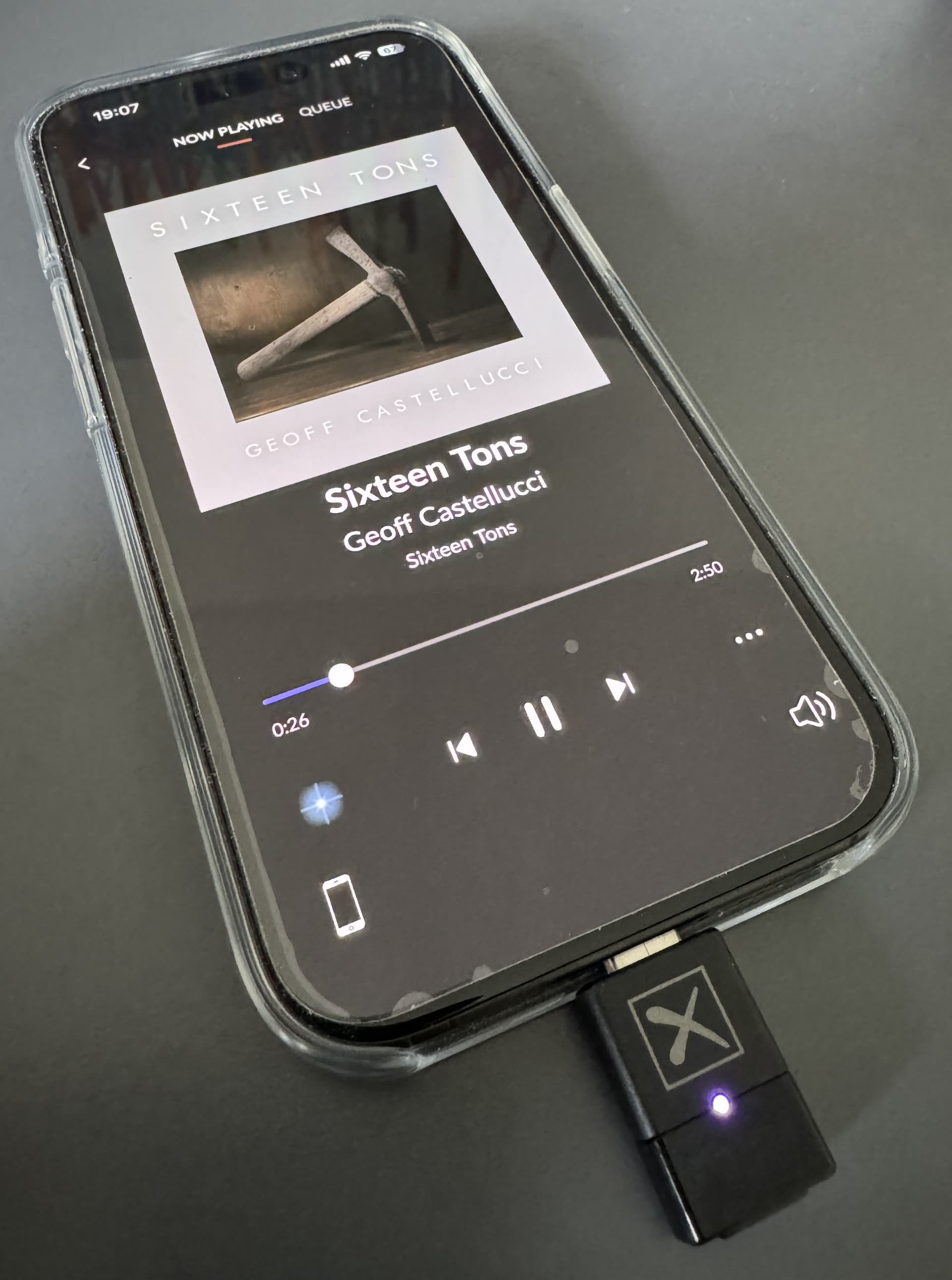

Maybee it is not a fair comparison, but I have bin testing Sennheiser MOMENTUM True Wireless 4 for some days now (AptX Adaptive) and had no problems.

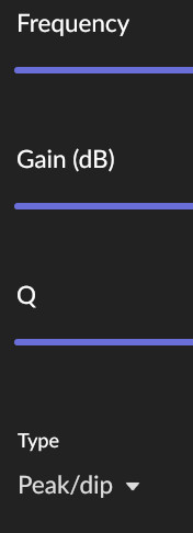

Any suggestions for some DSP settings:
Aufnahme1

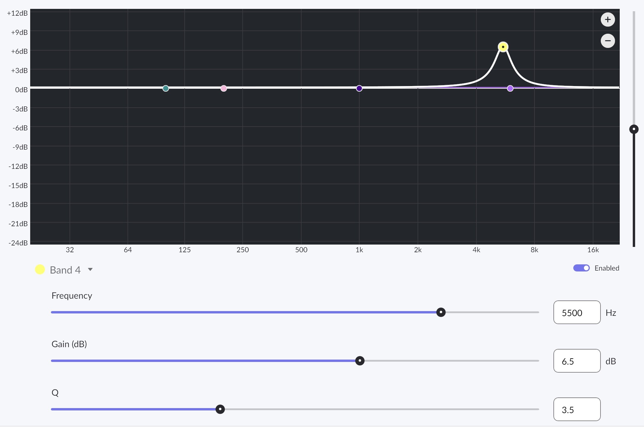

I usually start by trying to identify narrow frequency bands which are most annoying to you by emphasizing them overly on some well-balanced headphones or speakers. Example:
Then tune the frequency to 2600Hz instead and listen to the result. Afterwards 4000Hz (which is the most sensitive band for the human ear) or fine steps somewhere in that band between 2500 and 5500 Hz. Once you found the most annoying band you reverse the filter to -3.5dB or similar and make it a bit broader (Q=2.5) and try the earphones or speakers which sounded annoying. If your ears are just sensitive to a certain frequency band which the particular pair of earphones are emphasizing you stand a pretty good chance to reduce that problem.
