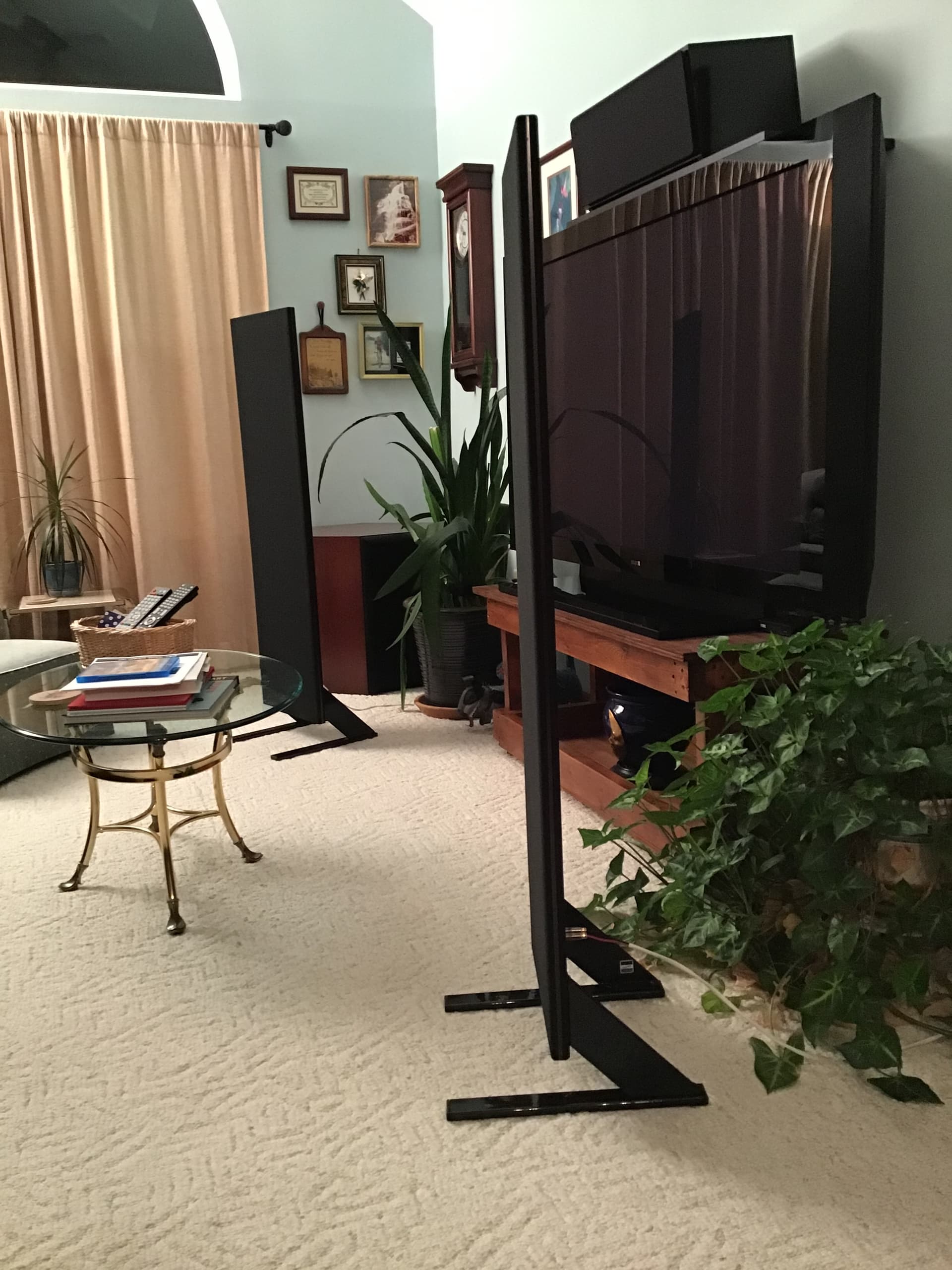

I also use Maggies (LRS) and have a 60” TV (on a stand) between them.
I thought that such a setup would negatively impact the sound, so I tried covering the TV with a heavy blanket. To my surprise, this sucked the life out of the sound rather than improving it, so I don’t cover the TV.
I would strongly suggest you experiment to find what works best for you and your setup/room rather than going by others suggestions (different rooms/setups/speakers/preferences) and assumptions (like I initially did).

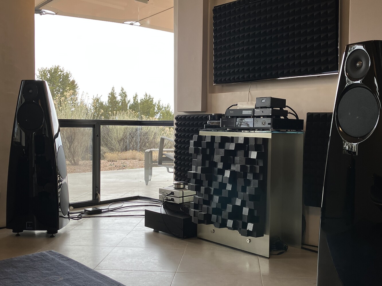

In my room, adding some diffraction along with a modest amount of absorption has improved soundstage and imaging. The lightweight foam panel over the screen happens to be just the right size, doesn’t scratch, and is easily lifted off for viewing.
