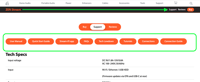

iFi hasn’t failed to provide documentation. It’s right there on the product page. Your feelings on the rest are your valid opinions and I won’t argue against them. I certainly never said nor inferred that you’re mentally deficient. Just trying to help.
