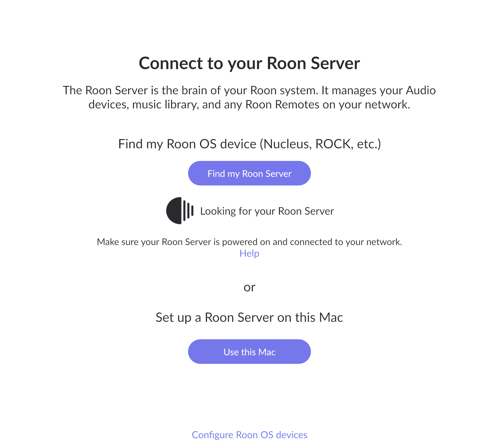

I have a Mac-based roon system with one server and four clients. All of these devices are on the same Eero network and can communicate with each other. Three of the clients communicate fine with the roon server. However, the fourth, an iMac, cannot connect. It is located next to another computer that connects with no problems. I can play music from the neighboring computer while the iMac cannot find the server. The iMac connected normally until several months ago, when it stopped. Do you have any ideas? Thanks, Duncan
The internet is connected through ethernet to an Eero Pro 6E router. The 6E connects via WiFi to two other Eero Pro 6 mesh points located in other parts of the house. One of these Pro6 routers is connected through Ethernet to an LHY Audio SW-6 ethernet switch. The roon server (a Mac mini) is connected by ethernet cable to the SW-6. All four (3 connecting and one not) roon clients connect via WiFi.

Unfortunately, replacing the roon library folder, made no change either. While in the Libray folder, I noticed that there were RoonServer and RoonGoer folders too. Should I be worried about these?

Another observation–all of my other clients ask me to locate a server if it can’t find the correct one. The iMac only asks to find a Roon OS. Is this relevant?
