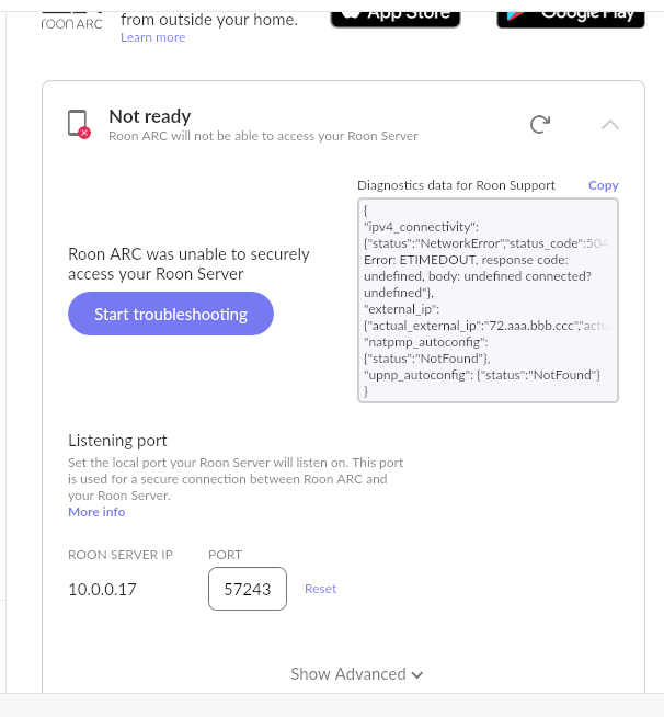

Here’s the current ARC error message.

The first possibility is simply that UPnP is failing. You mention that you’ve placed one router in AP mode, which should remove the second network address translation layer imposed by a two-router setup. However, the diagnostic snippet is still timing out, which means that the port either a) isn’t open or b) hasn’t received a response.
Try disabling UPnP and creating a manual port forwarding rule in both routers instead. This rule should be TCP-protocol and point to the port and IP address from the Roon Settings page in your screenshot.

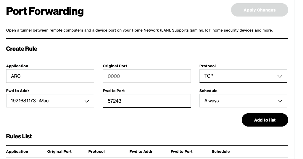

I’m at the “setting up the port forwarding rule in FIOS” stage and got the following error:
Original Port: The input of port has illegal characters. Destination port should be 111, or 111-222, or 111,222-333 and so on.
Can you give me some guidance as to what I need to enter for “original port” and “forward to addr”? I assume that Fwd to Port is 57243 as indicated in the Roon Settings?
As I said, I’m a complete illiterate in these matters, sorry.

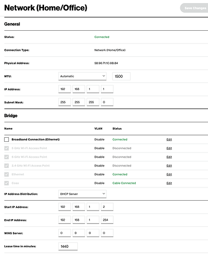

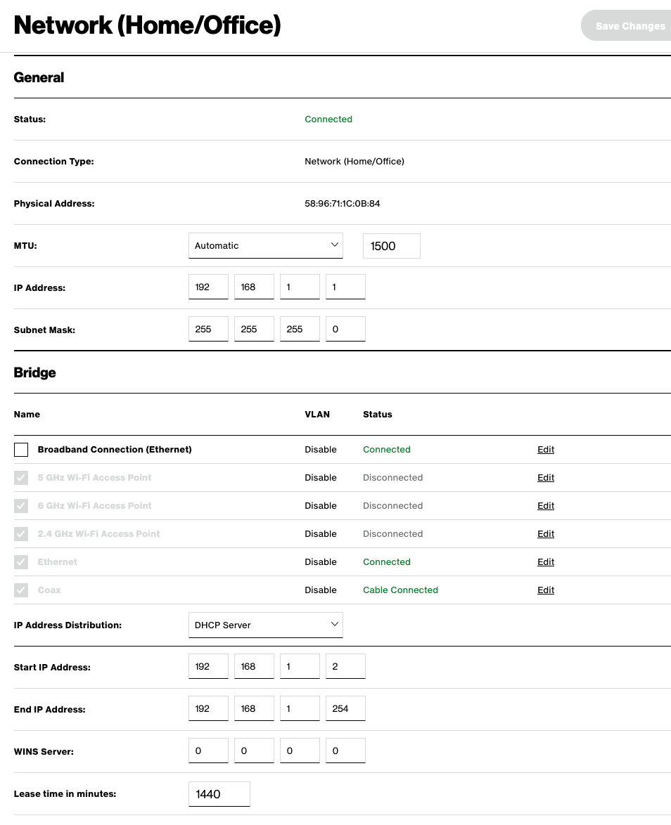

I’ll also note that I’m not seeing the “IP Passthrough” option under Bridge in my Verizon settings.
N\
OK nevermind, I see the Verizon Router is already in Bridge Mode.
This is what I’m imagining the rule looking like, absent the “original port” entry… stop me if I’m getting things wrong.
Hi @Stephen_Garrison,
Assuming that 57243 is the ort you have listed in Roon that should work. Can you share a screenshot of the error message you’re getting when you add the original port?
This is text rather than screenshot, which I’m not in a position to provide at the moment. But that’s it, in its entirety.

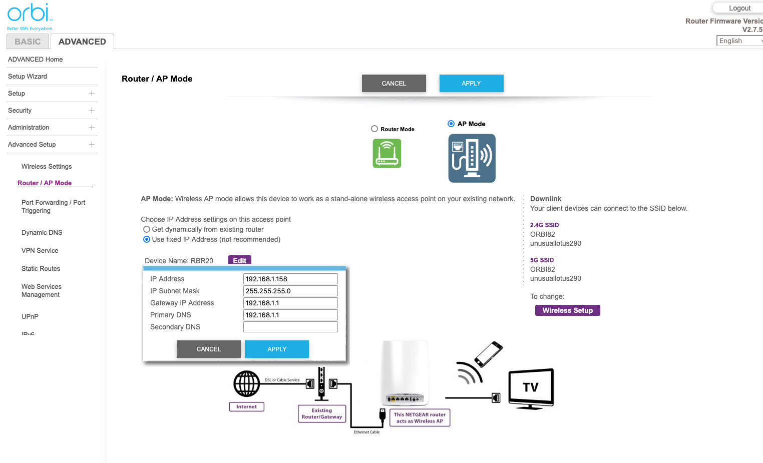

I’ll also add this, in case it’s relevant. Although the Orbi is currently in Router mode, this is when it shows when you look at AP Mode.

Let’s zoom out - you’ve 1) placed the Verizon router in Bridge mode and 2) created the manual port forwarding rule in the Orbi router. Is this correct?

This might impact port forwarding: first, re-create the manual port forwarding rule, keeping the “original port” blank if it throws an error when you attempt to paste the RoonServer-> ARC port from Settings.
