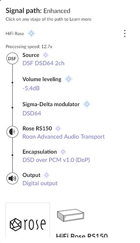

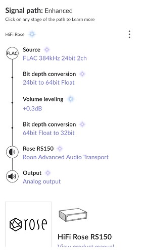

After the latest updates to both Hifi Rose RS150B and Roon, I can no longer play dsd files. The Hifi Rose device setup in Roon does not contain any reference to dsd (dsf).
laptop and Hifi Rose 150B connected to wifi using Eero extenders to Verizon 2GB router

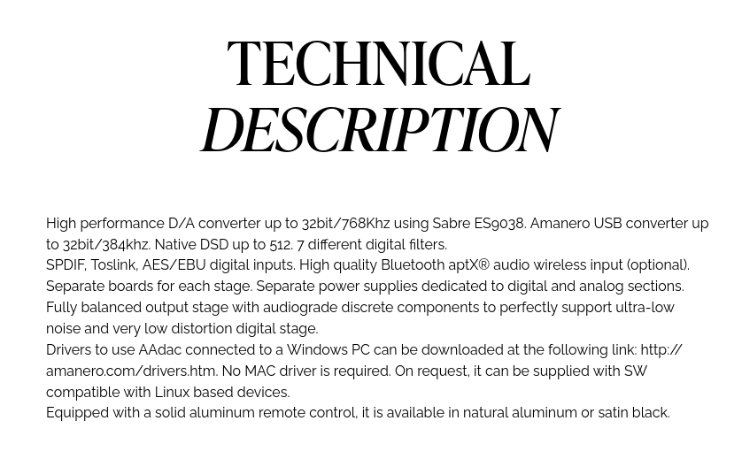

Unable to see DSD 512 from my Hifi Rose RS130 thru my Audio Analogue DAC. Help!!!
?! Home network. Fiber
You need drivers (of some sort) for “native” DSD.
grafik
I suggest you inquire with HiFi Rose support about “native” DSD support for Amanero in their streamer (maybe he already does and it is just a “wrong” setting on the streamer that prevents it from showing). Depending on their answer, you may also have to request the Linux compatible software for your DAC (see above) to make it work (if possible at all with your current setup).

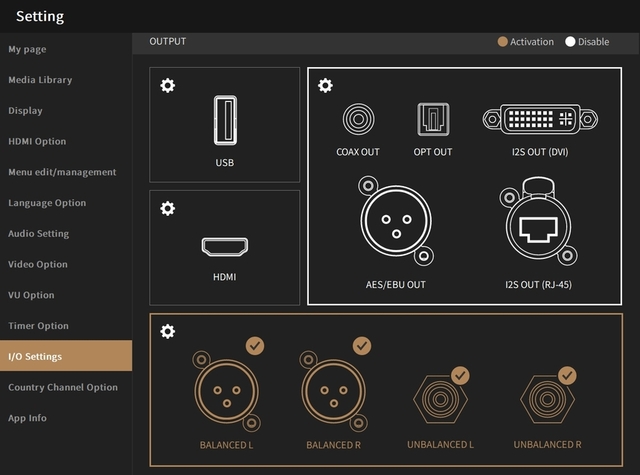

Hi, Connor, I solved the PCM / DSD playback issue.
I ran the HiFi Rose windows application on my laptop, and kept changing the audio input /output settings until both PCM as well as DSD had audio playback on HiFiRose150B.
HiFi Rose 150Bsettings
