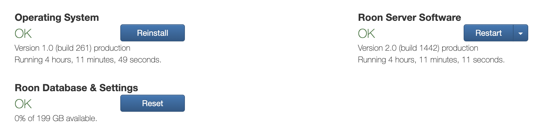

Wondering if this has something to do with the issues I am having – 0% of 199 GB available for the database?
It seems weird that RoonOS/Roon consumes 200Gb, are you by any chance using the default share as storage or backup location?
But you are correct, it is likely the cause of your issues.
Thanks. I wasn’t intentionally storing backups there. What’s the best way to fix it?
I’d say you’d be best off by “browsing” to your ROCK share and deleting some of them over the network.
I don’t remember exactly what they look like, but i think that they are located in a separate folder, containing thousands of files, and the folder is named with a guid (a series of hexadecimal letters/numbers)
When you have freed up some 10-15% pf the database drives capacity you should be able to start the Core and adjust your backup location.

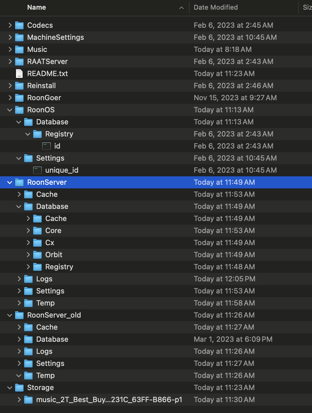

Can you post a screenshot of what you are seeing on the Data share?
Figuring out what’s writing to that drive will take some investigating, but at least my system is functional.
Again, very grateful for the assistance and coaching!
If you show us a screen shot of your Storage settings along with a screen shot of what the folder hierarchy looks like, on the Data-share, the forum might be able to see whats happening and causing this.
Here (I think) are the suggested screen caps:
Culprit found! Third folder in your screenshot, “Music”… Does not belong there, and should be placed under Storage\Music_2Tb_*\Music*
What/whoever is storing/backing things there is doing the damage.
