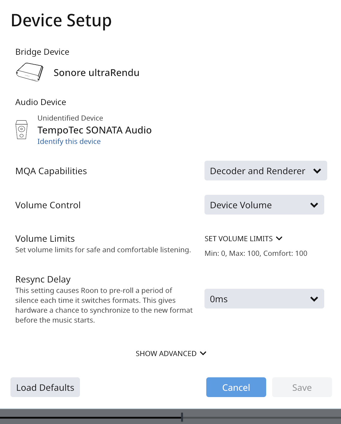

Can you share a screenshot of Device Setup for this Zone?
Hi Dylan. Tried to S8/Ropieee combination again this morning and couldn’t get any recognition at all from ROON this morning. Perplexing since It was recognized yesterday but didnt produce sound. Tried rebooting everything, ROCK, router,ropiee, but no joy. I disconnected the S8 and reattached the Khadas to Ropieee and it connected to ROON immediately. The S8 also worked fine with the Ultrarendu this morning. Would the system logs help?
