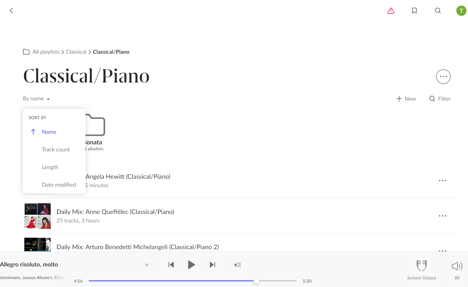

This makes it a lot easier to navigate a larger playlist library. The strange thing is that although playlist sorting is not supported when adding to a playlist, it is when displaying playlists:

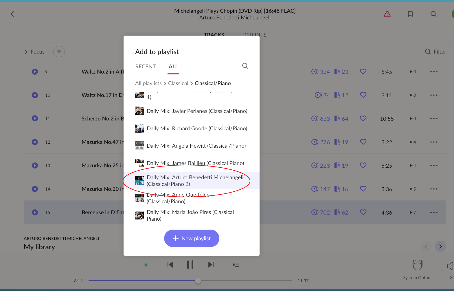

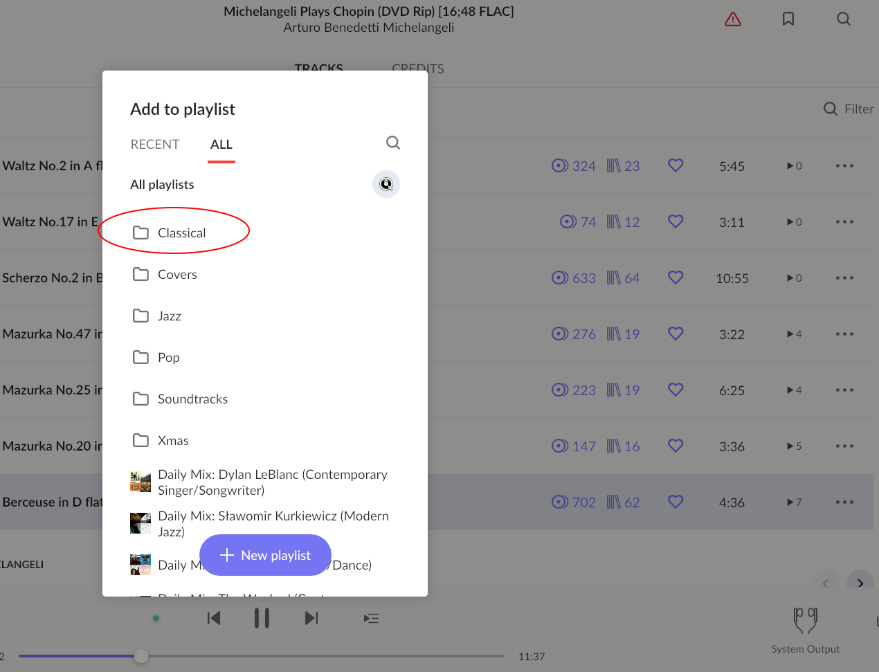

What this means is that for example, say I want to add an “Arturo Benedetti Michelangeli” track to a Classical, a Classical Piano, a Chamber Music or even a Michelangeli playlist then I can much more easily navigate down a folder hierarchy than a 600+ randomised list. Once you have made the folder hierarchy and moved your playlists into a more structured form then roon will display the folders when you go to “add to playlist”:
Bizarrely, the folders are displayed alphabetically if not the playlists. I wouldn’t suggest putting each playlist in its own folder but some sort of folder structure does help.

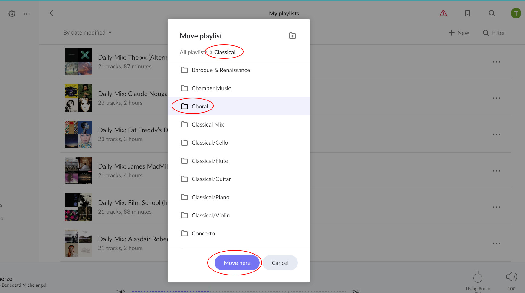

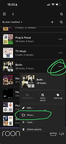

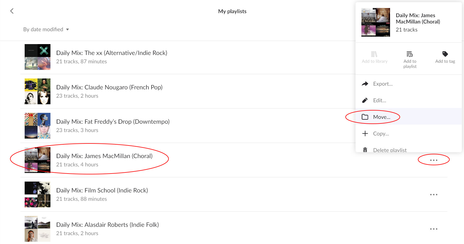

You move a playlist into a playlist folder from its menu in My Playlists:

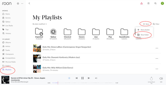

To create playlist folders:
Roon‘s owners changed.
  1. Create as many playlist folders and sub-folders as you need in roon. These are not part of your OS filesystem but are a solely roon structure. This might be what is causing the confusion:
  1. Next move your playlists into the relevant folder:
