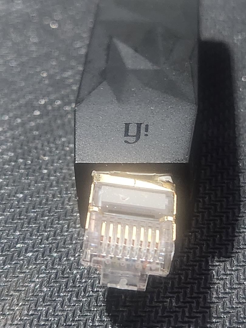

The chain I use is Wi-Fi extender->Switch #1->Switch#2->ethernet input of streamer.
Some time ago I inserted an iFi ethernet filter (the LAN iSilencer) ‘dongle’ coming out of the wifi extender.
I decided to unplug and replug all ethernet cables in the chain so see if that would work and I found this…
Yeah…the iFi had undergone some torque-related disruption of the LAN plug, which was hanging by dangling wires.
Needless to say, this was removed. I should really have known better, as this is the SECOND time one of these has crumbled on me.
So the U2-Mini is up and running again (and sounding QUITE better than the streamer of the N130) and SO FAR, I am not having any problems.
But it is too early to say for sure, as sometimes it can be hours before the Lumin app freezes or I encounter dropouts.
But I have a good feeling that my problems MAY be solved and the fault in fact had nothing to do with the firmware or the U2-Mini hardware.
