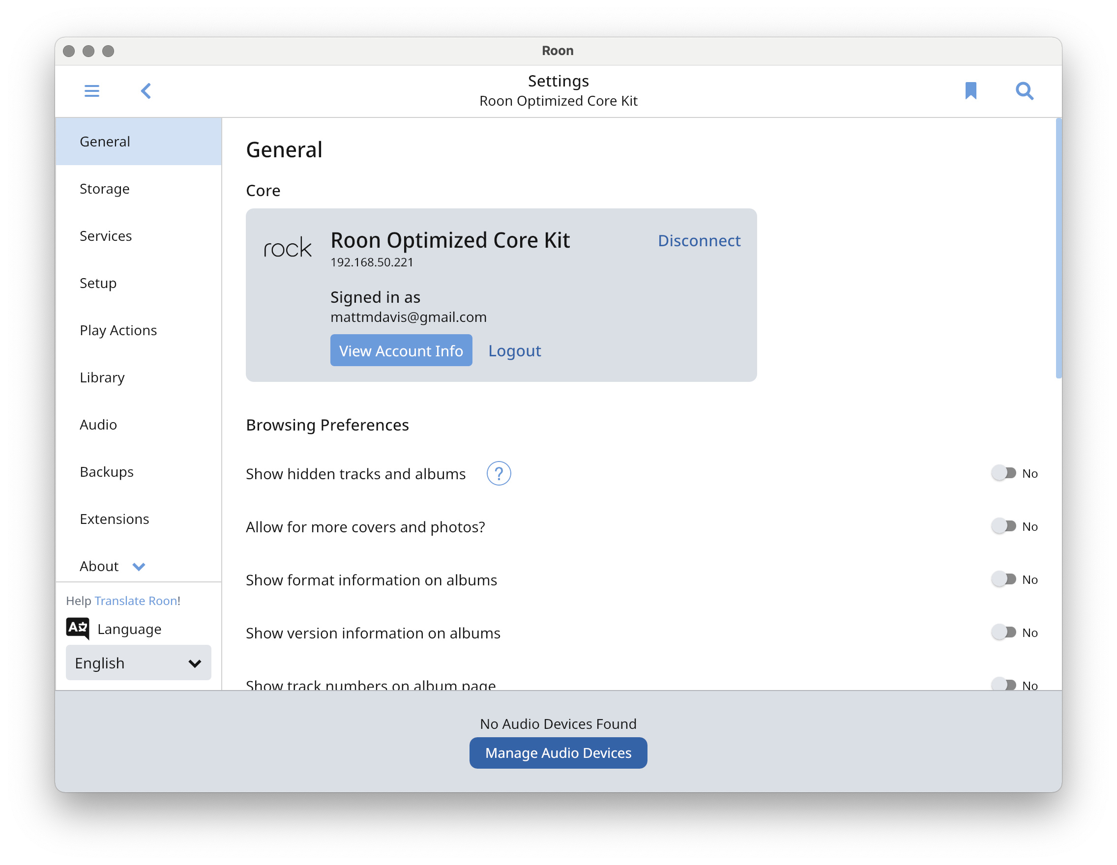

Going back to the Mac Roon, which is now effectively just a Roon Remote, I was informed that I had No Audio Devices Found. According to the ROCK migration directions, if I wanted my Mac’s local devices to be accessible, I’d need to run RoonBridge.
I’m running RoonBridge now, and that’s not helping. Also, there are two other problems that suggest that it’s not really an audio device problem:

At any rate: it is not a firewall problem (I didn’t think so, but I checked to be sure). It’s a “nothing from my database is showing up–not audio devices, not albums, not nothing” problem.
If I tell Roon to “clean up the library,” it says there are 5851 items that are from a storage location that no longer exists. So that makes sense: it’s on the NUC now, so the path to the Mac directory is broken. But it’s not because of the firewall.
I mean, really, I’ve only been using Roon for a few weeks, and it’s no huge deal if I have to nuke the whole Roon core and start over. But I don’t know how to do that, either.
OK, here are some screenshots. This morning, I installed internal storage in the NUC and copied over the files from the old storage location on my Mac, and so now when I go to “Library Cleanup” it no longer says there are items in the database that are in a location that doesn’t exist anymore:
Oops. That’s because I took the screenshot before I refreshed the web interface. After refreshing the page, the Internal Storage is at 69% availability, not 100%.
My understanding from the documentation is that putting the files on the disk and then putting the disk in the NUC won’t work.
So, I added a drive, booted the NUC, formatted the drive using the web interface, and then copied all the files from their HDD location on my Mac to the SMB share on the NUC—specifically, data>Storage>InternalStorage. This SMB share is fully accessible over the network. I can browse it using the Finder on my Mac, no problem.
So even if all the old files were missing/links to the locations were broken, I would expect to see 5000+ NEW items showing up in the database, after being automatically imported when I put them into the Internal Storage. But no. Instead, there are no longer 5000+ orphaned items; there are zero. And yet none of the files are showing up in the Library. And I don’t have audio devices.
