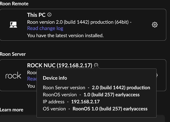

Reading this post I decided to look at my Roon OS and found it in “earlyaccess” at build 257.

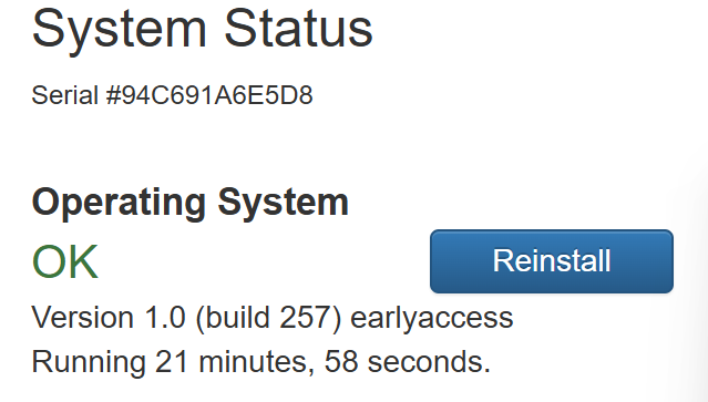

I downloaded the “roon-production.bin” file and dropped it into my ROCK’s /Data/Reinstall directory; did a Reinstall of the Operating System but my OS remains at “earlyaccess” build 257. Not sure of what to do OR just leave it as such. Any help appreciated
Thanks, Dave
p.s. here’s my About info in my Windows 11 laptop.
Unless you need the new features (e.g. if you are running on a NUC12 or later and want to use HDMI audio), you are unlikely to see any difference between this older early access build and the current production build of RoonOS.
As you have seen, the build of the OS has not affected your ability to run the latest version of Roon Server.
