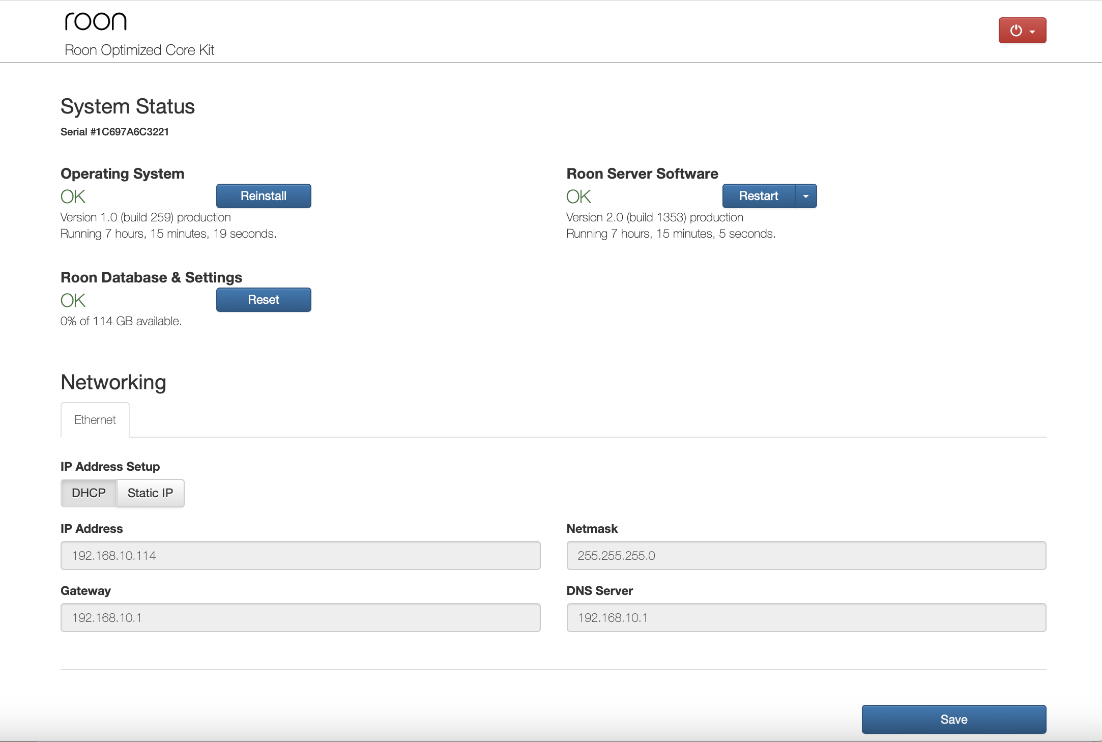

Daniel, really appreciate your reply and your helping me. This has been too frustrating!! I’ve taken the screen shot you requested. Have to figure out how to “send it”.
Sent, let me know you’ve received it and how to proceed.
I see that the NUC is on 192.168.10.x. I wonder if the control devices (on Wi-Fi) are on a different network. With mesh networks, it’s easy to end up with multiple LANs without realizing it. The fact that Roon Server is accessible via ARC but not via Wi-Fi suggests a split LAN situation.
As @WiWavelength says, your m.2 SSD, which holds the Roon OS and Roon software is full. Have you been storing music files and/or Roon Backups on this SSD? If so, this should not be done. They need to be cleared from the SSD.
Geoff and Andrew, thank you for your insightful observation. That’s something I’ve never paid attention to on the Roon web ui. It appears I have been making “backups” of my Local library on the NUC’s HD. I’ve been deleting those files but the Web ui still shows 0% space available. Is there something I need to do make the deleted space available? Thanks again, David

So I’ve reinstalled the OS, I deleted a bunch of files and the GUI still shows 0% available and the Roon app won’t open on either the Mac or iPhone; just the oscillating icon. And I can still use RoonArc in the car!! Now what???
If I had this problem, I would boot from a thumb drive with the latest ROCK image, reinstall Roon OS (which reformatts the NVMe boot drive), and restore from my last Roon database backup.
