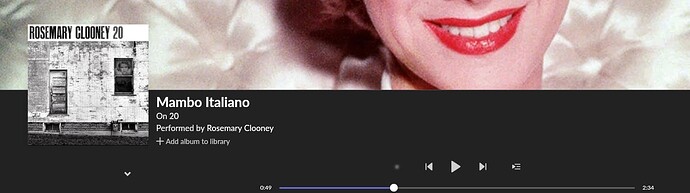

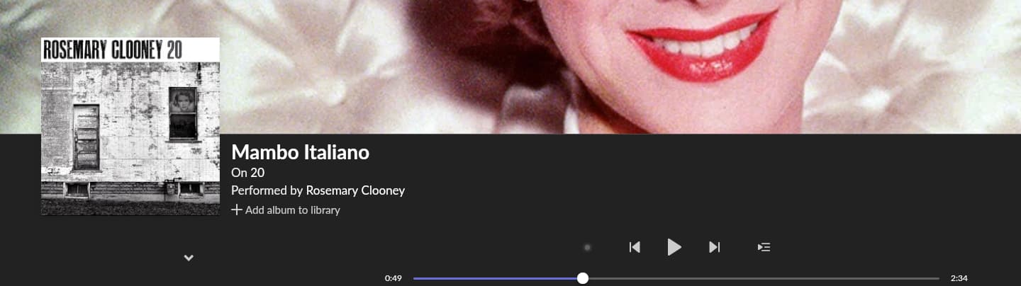

I can predictably see this issue on the song Mambo Italiano (Rosemary Clooney, album 20) from Tidal. After ~55-60 seconds it will drop audio for 1-8 seconds
This morning, I tried everything I could network-wise (mesh/none, 2.4/5ghz, wired/not, force connection to a specific router, physically move speaker) and all produced the same issue on the above song.
Again, if I played that same track from Tidal using the Sonos app it plays without incident. What is different in how Roon sends audio to the Sonos speaker versus how the Sonos app does it?
