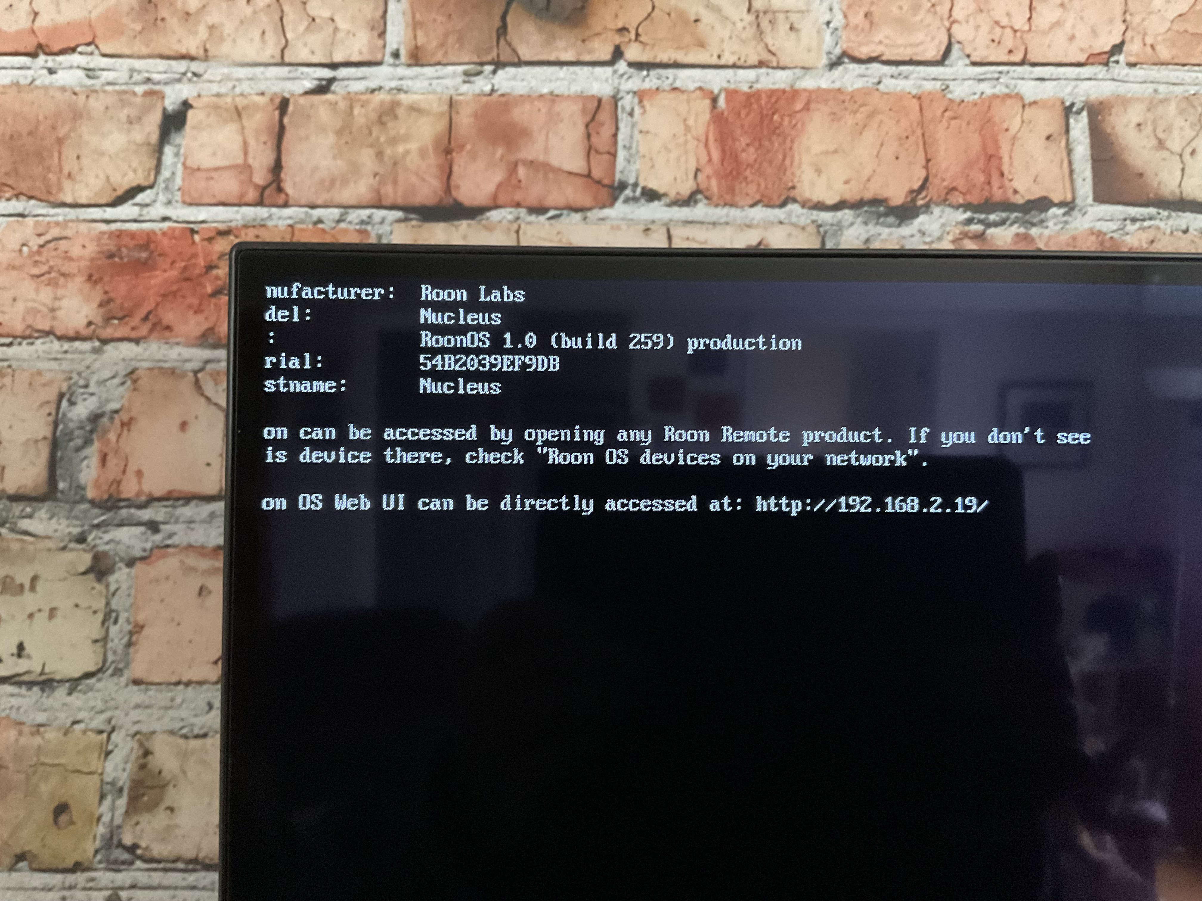

I appreciate your patience while we worked through the queue. Please connect your nucleus to a monitor with an HDMI cable and share a photo of what you see on the monitor. This will allow us to diagnose if there is a hardware issue with your nucleus.
Add images
Okay, good news. That screen means that your nucleus doesn’t have any hardware issues. I’ll activate diagnostics on your account to investigate further.
