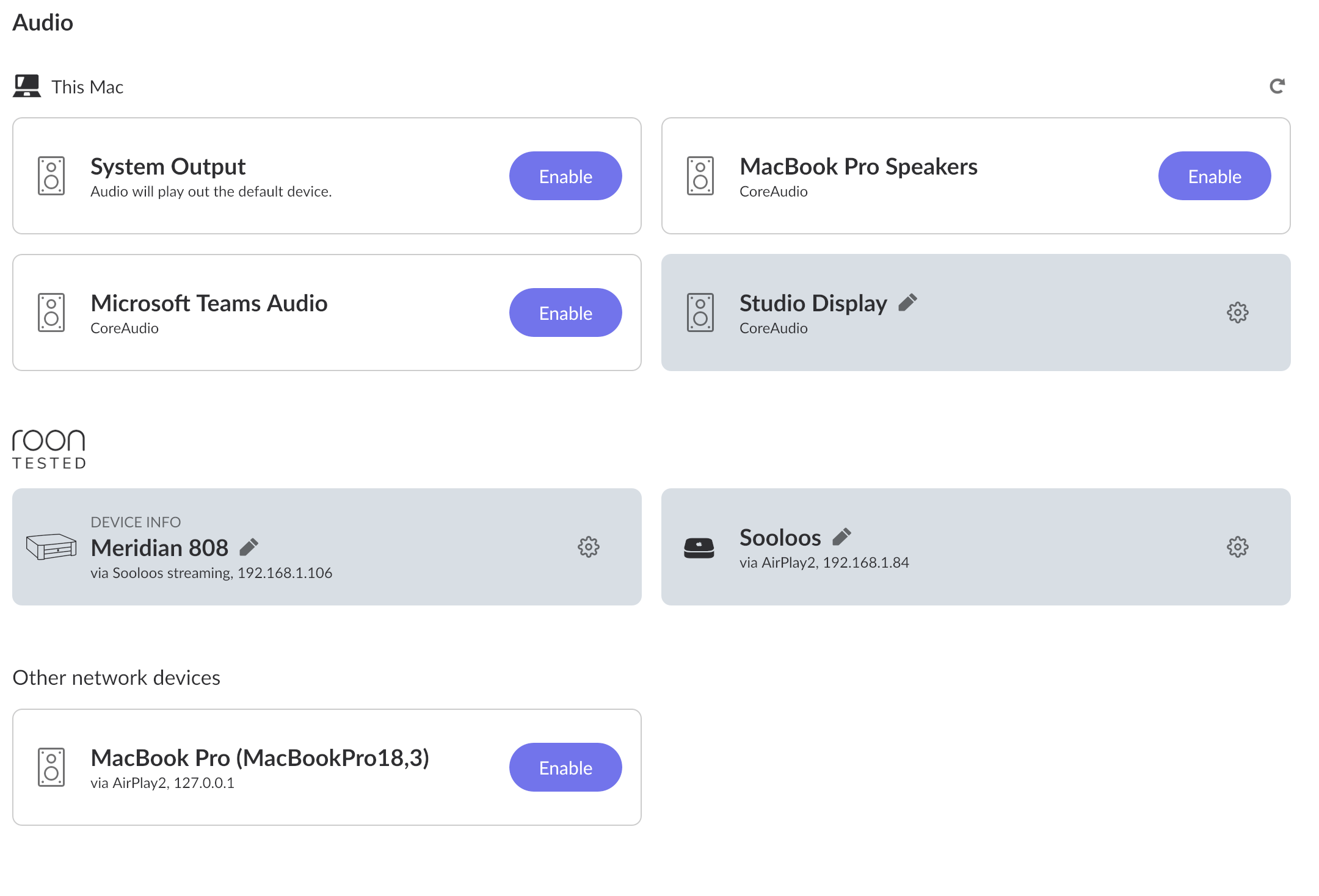

· My Roon core is a MacBook Pro connected to the router by ethernet. My main music system is Meridian 808 with ID41 card also connected to the router by ethernet. I am losing connection, the 808 'disappears' as an audio device despite the fact that the indicator lights to the ID41 input continually flash so the network connection appears OK. The issue is intermittent, with the 808 reappearing, then disappearing again. I read that there have been issues with older Meridian legacy products, including the ID41. Is this the likely cause? In which case should I replace the 808 with Meridian 210 streamer? Any other advice? I am using Meridian DSP speakers so I need something that connects by ethernet (speaker link) cable. Thanks for any suggestions.

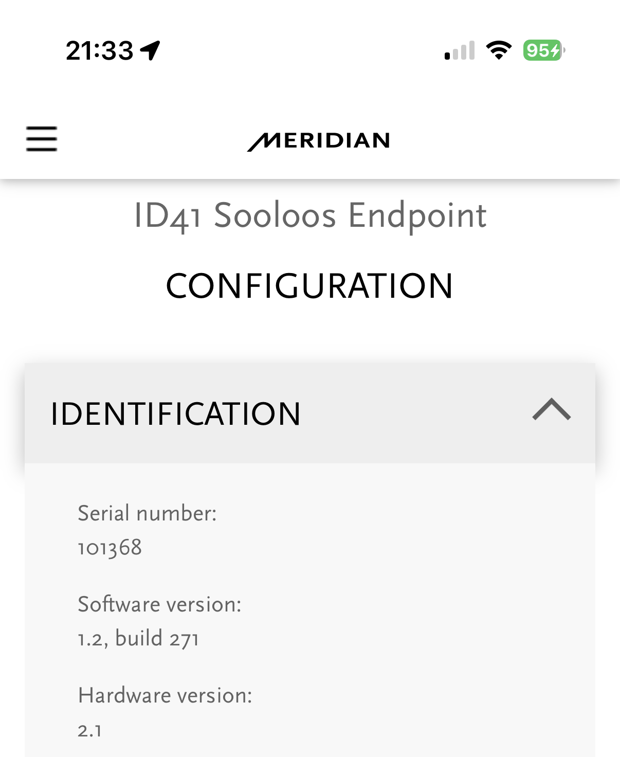

Is the ID41 card running the latest firmware? Meridian recently released a firmware update for the ID41 that may help with this intermittent behavior.

Not the latest software but connection issued solved by rebooting everything, MacBook Roon Core and modem. Hopefully, the issue will not reappear.
I really recommend updating the ID41 firmware that was issued last week. It significantly improves network performance with Roon.

However, I want to strongly second @ncpl’s recommendation regarding the firmware. While the reboot provided a solid immediate fix, the underlying communication quirk between the older ID41 firmware and modern network protocols is still present on the card. The intermittent dropouts you were experiencing are exactly what this recent firmware update was engineered to resolve.
To ensure the Meridian 808 stays permanently connected without needing routine reboots, I highly recommend prioritizing that firmware update when you have a moment.

FYI….info about the Meridian firmware.
