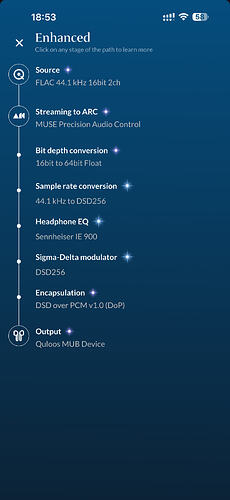

Can you please share a screenshot of the Signal Path under the configuration with which you’re experiencing these issues? This will be transparent to the actual digital chain as the vendor DAC firmware reports it to ARC. Any transcoding performed on Roon’s side will be displayed.

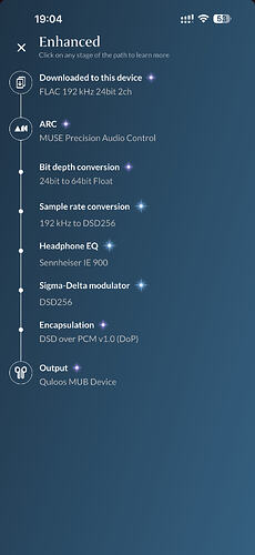

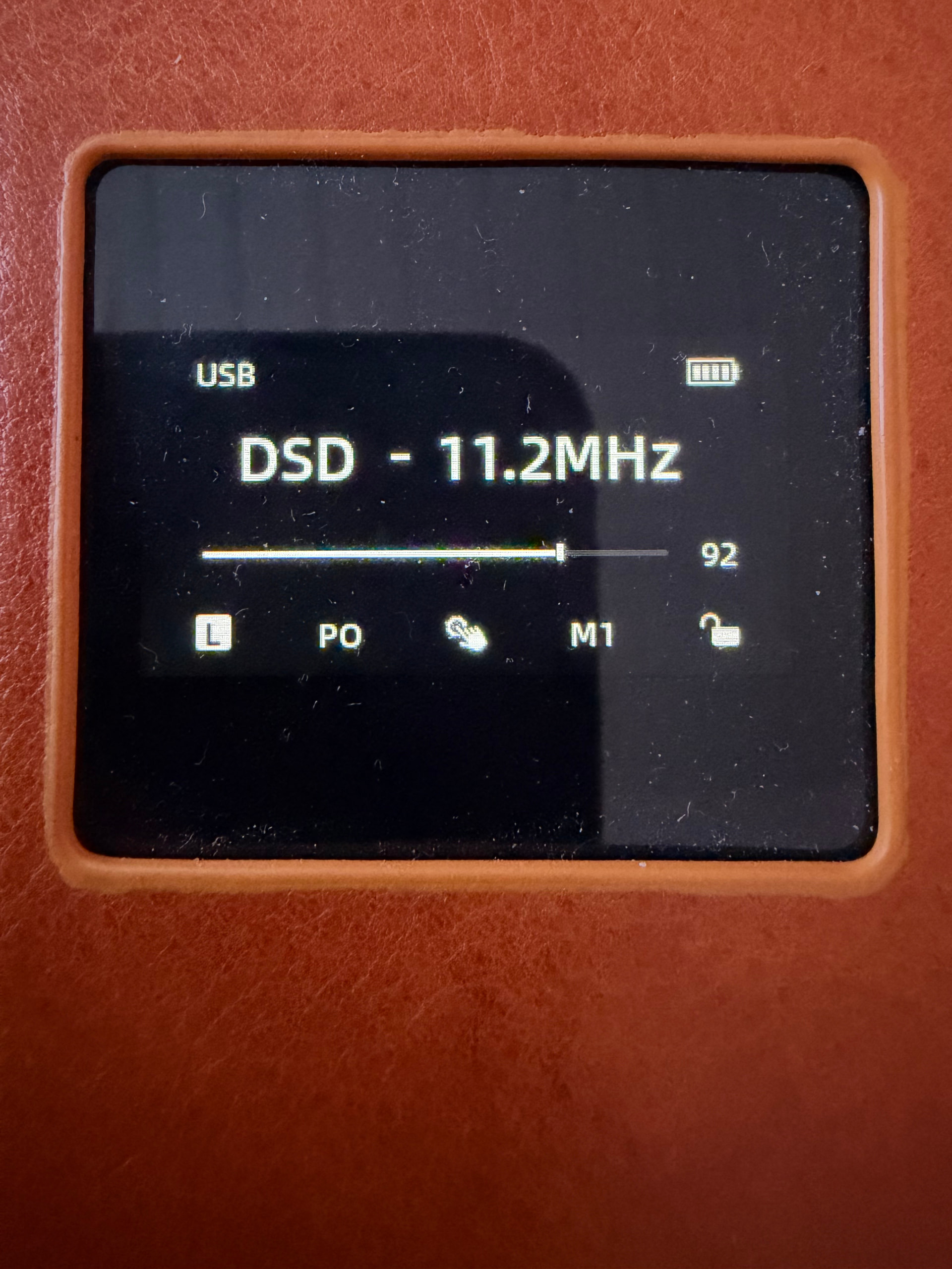

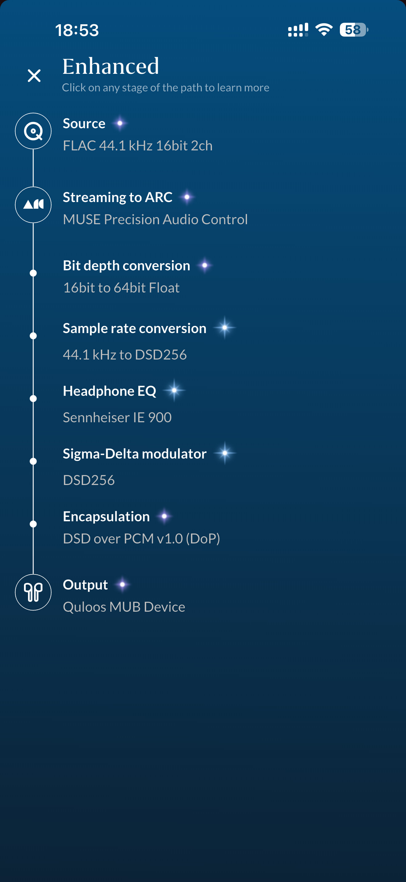

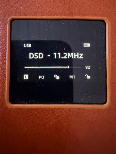

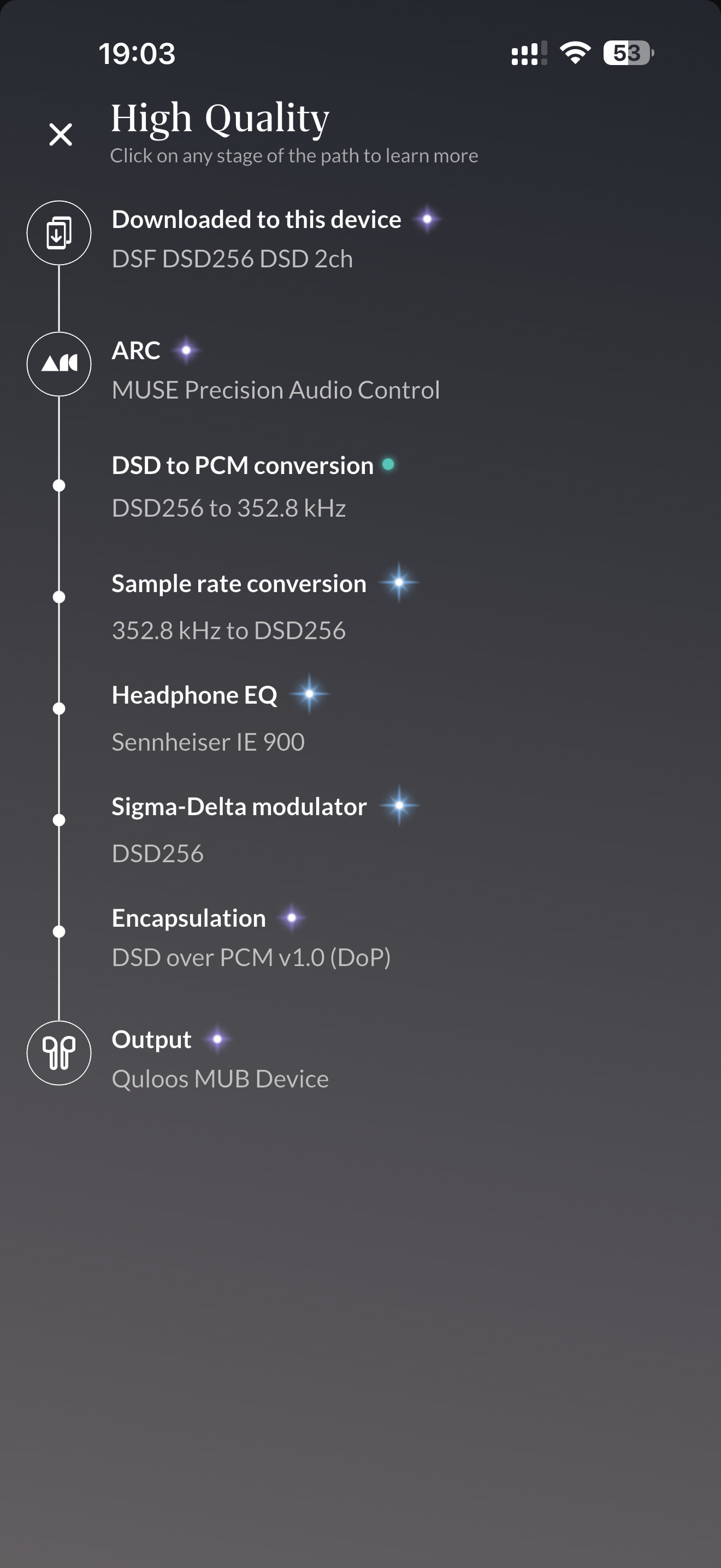

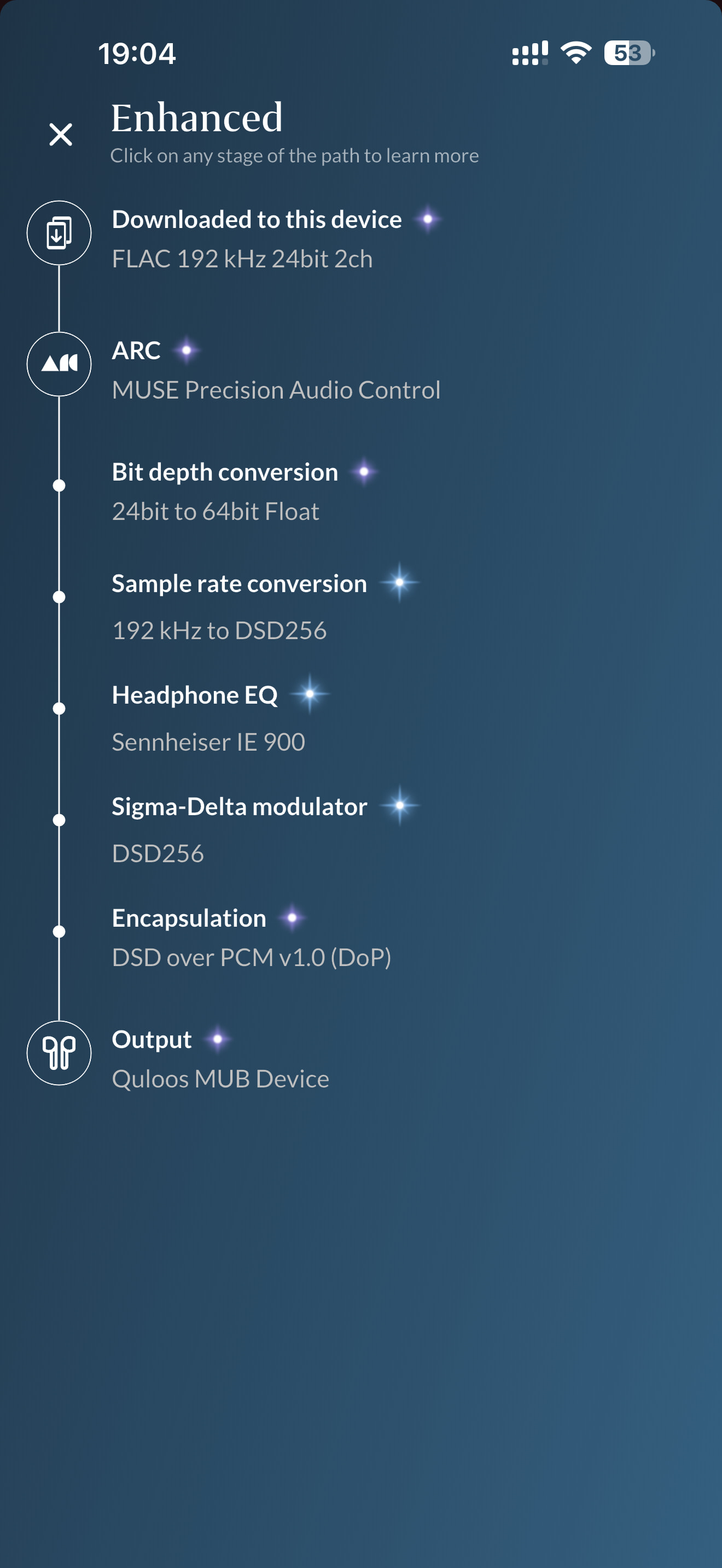

Hi @connor,
Thank you for your reply.
The issues — random brief gaps + distortions — happen with any album and any format. Streamed and/or downloaded.
I have attached three sample Source Paths, each reflecting a different source format. I also attached a photo of the screen of the MUB5 that confirms that it is receiving DSD256.
Interestingly, I noticed that when I take screenshots when listening with SRC to DSD256, I hear a screeching sound through my earphones. On the other hand, when listening to PCM — with or without SRC — the screenshot action is silent. Also, if I receive an incoming message that triggers a sound (WhatsApp, for example), it squawks, whereas with PCM the audi on temporarily reduces in volume. It sounds like DSD is not preserving the exclusive mode…
