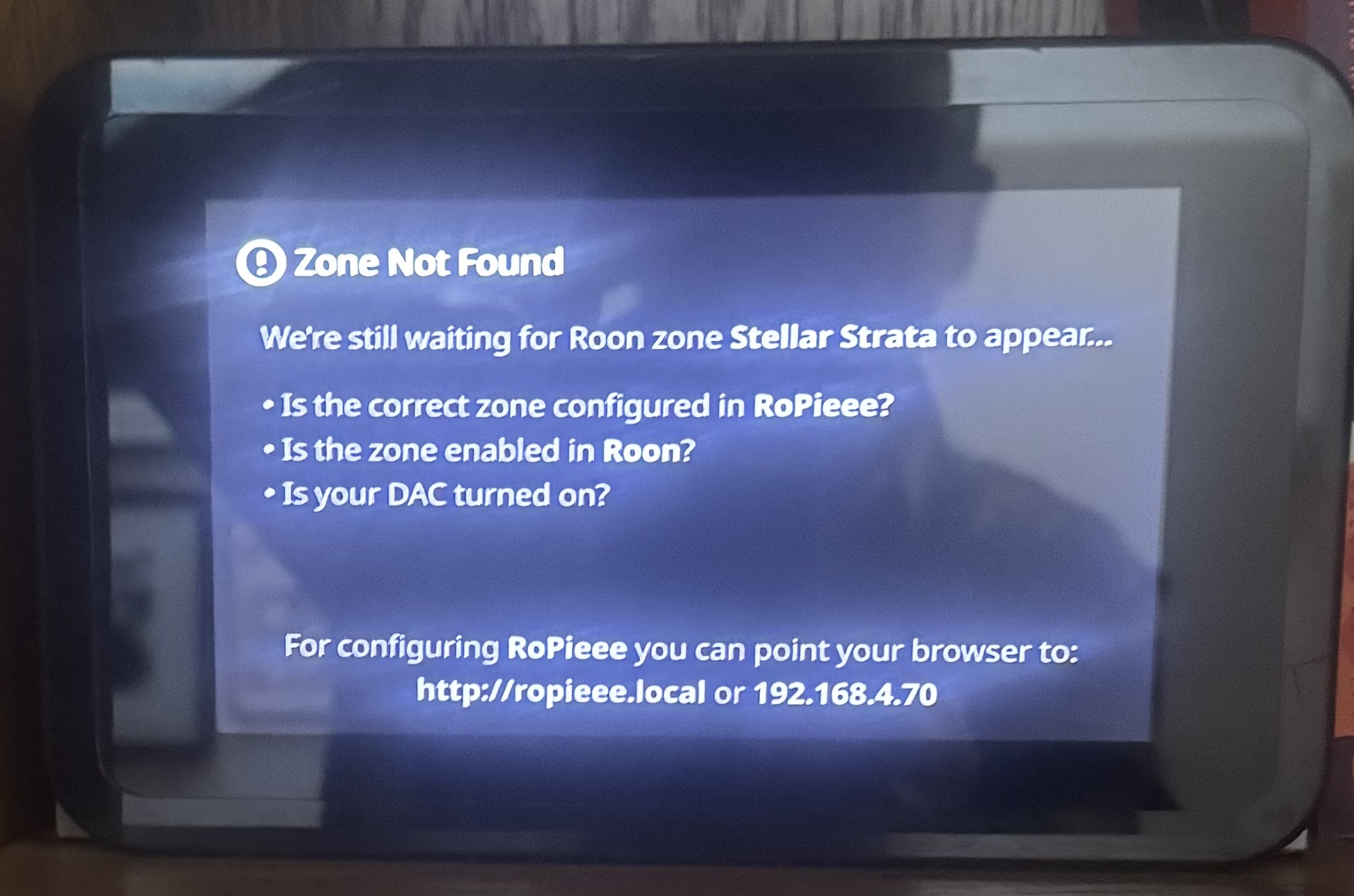

I'm experiencing ntermittent dropouts while playing music, my RoPieee end-point displays the "zone not found" error message, and I have to reboot my Roon core.
Internet provider is Frontier. Router is eero mesh wifi system. Internet comes into my listening room via an eero extender, and I run ethernet out of the eero extender into my Roon core.

Welcome to the forum! I am looking over your account diagnostic and I noticed something odd here, it looks like your Roon Server is on a 192.168.4.XYZ subnet, while in your screenshot the Ropieee appears to be on a 192.168.5.XYZ subnet. I suspect that this is the source of the issue, for some reason, your Eero has set up an additional subnet. Please see this thread for a similar report:
It makes sense that differing subnets might be the source of the problem, and that it might solve the problem to get the Roon server, the RoPieee, and my audio device (Stellar Strata) on the same subnet. However, from reading through the thread I’m not sure how to actually accomplish this on my network. Where do I start?

Intermittent dropouts while playing music, my RoPieee end-point displays the "zone not found" error message, and I have to reboot my Roon core.
I've already submitted this ticket once, and the solution I got was to make sure that my RoPieee end-point and Roon core were on the same subnet, which I did, but that did not solve the problem
Here are some more relevant screenshots:
The screenshot from Roon audio settings shows that during the dropout, Roon is not able to find the audio device, which is the PS Audio device showing “unnamed”. This audio device is a DAC connected to my Roon core via USB. During normal music playback, this audio device shows up as “Stellar Strata” and is enabled in Roon audio settings.

I’ve enabled diagnostics for your account and looking over your error logging, I do notice the Ropieee drop at certain times, and it looks like when the Ropieee drops, so do the rest of your zones. This suggests that the issue is with the network connection from Roon Server → Endpoints is dropping entirely.
How is your Eero extender connected to the primary router, is it over WiFi/mesh backhaul, or did you run a cable from router → extender? If it’s over WiFi/mesh, are you able to try to temporarily run a cable between them?
The Eero extender is connected to the router via WiFi/mesh. The router is literally on the other side of the house from my audio room, so I hooked up Roon server/RoPieee by plugging the Eero extender into a wall socket, running ethernet cable out of the extender to an ethernet switch, and then running separate ethernet cables from the switch to the Roon Server and RoPieee.
