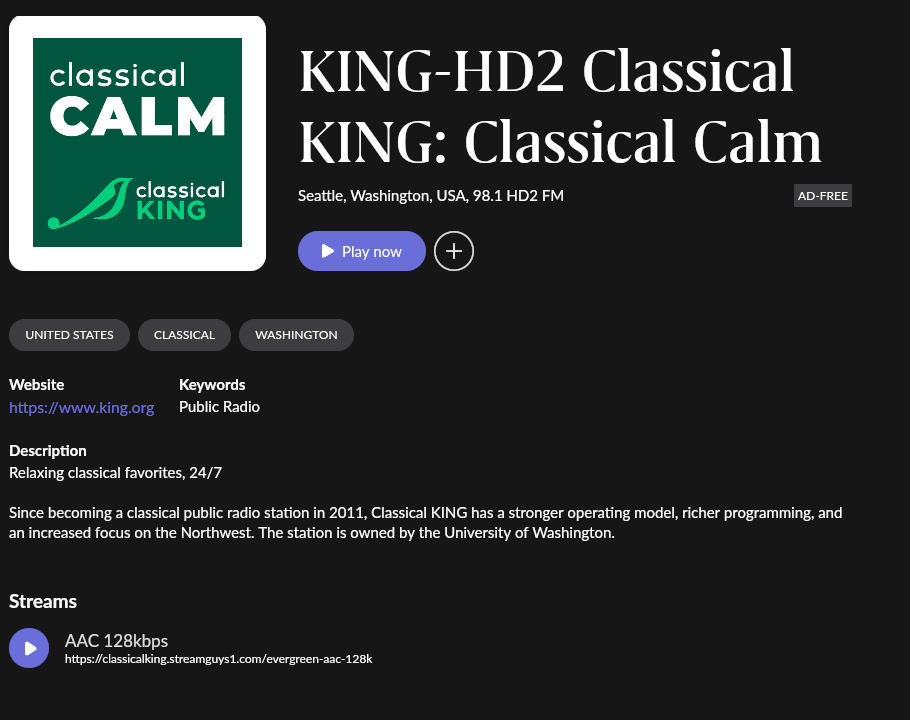

Well this is weird, the station has been playing just fine for a while now. But, I just went back to its page and the stream is no longer showing on the Roon page:
The stream still plays, though. so not sure how that happens.
The other classical king stations show up properly.
I tried unlisting , editing and then re-publishing it and it still does not show the details and stream info.
@BrianW Any ideas why this is?
Edit: I removed it from my library and the re-added it and now it shows up fine. Maybe a graphical glitch?
