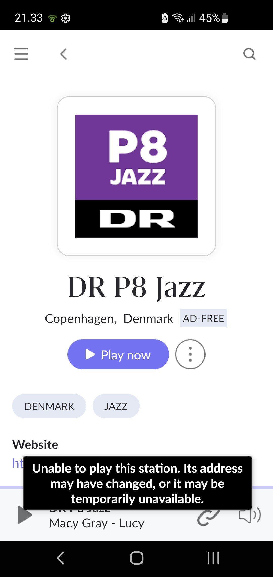

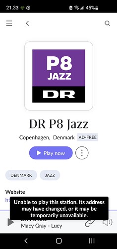

This evening when playing the 192 kbps DR P8 stream I had many stops. Some time stamps are 21:33, 21:58 and 22:31, and there were quite a few more. Immediately after a stop I was able to play another station (BBC 3) and also the same station (DR P8), and this is how it usually is when the stream stops.
I include a screen dump of the error message which displays only briefly after a stop. This is the usual message which I have seen countless times.

I get the same error message as @kassoe (“Unable to play this station. Its address may have changed, or it may be temporarily unavailable”) and last time it happened was today at 9.20 (Copenhagen time)
