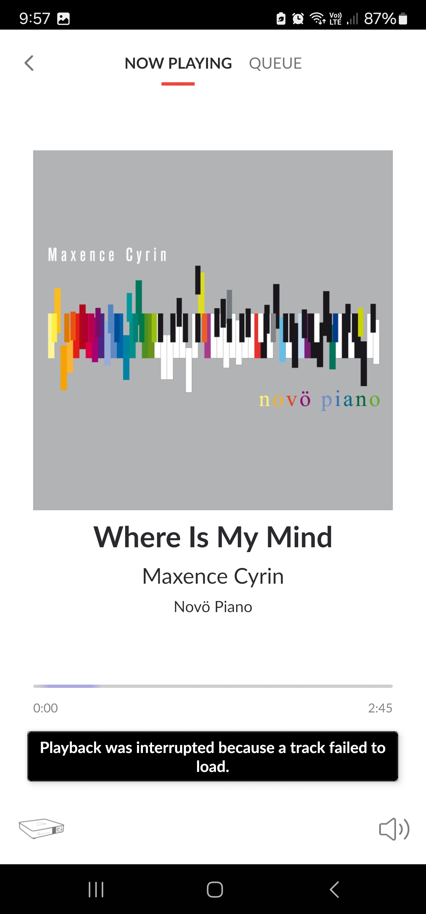

i keep getting logged our of roon when i log in again sometime roon works sometimes i get a error saying to many failures to play

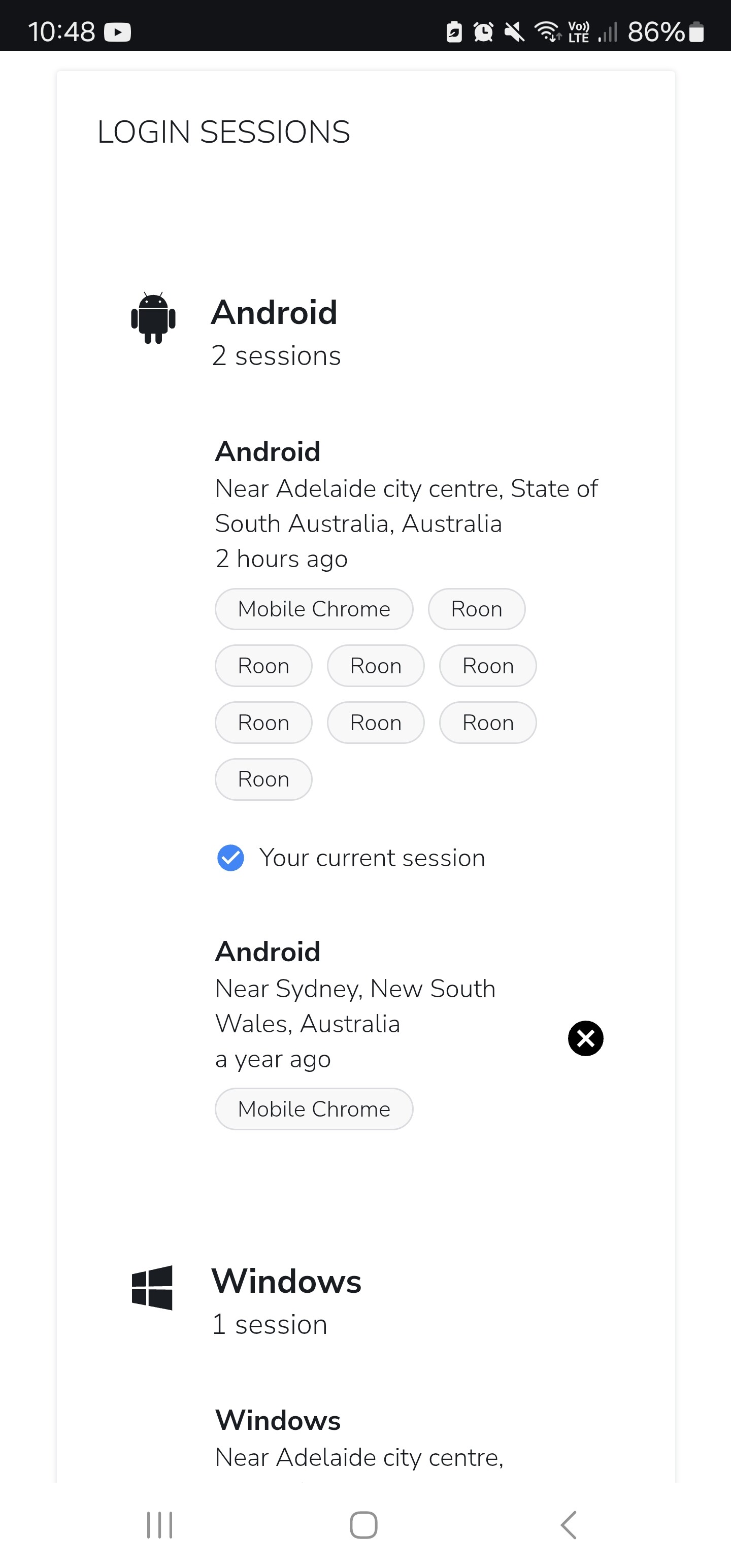

If you navigate to your Roon accounts page, you should see login sessions displayed in Roon. Do you see the account getting logged out every restart, generating a new session?

hi this is since i re installed

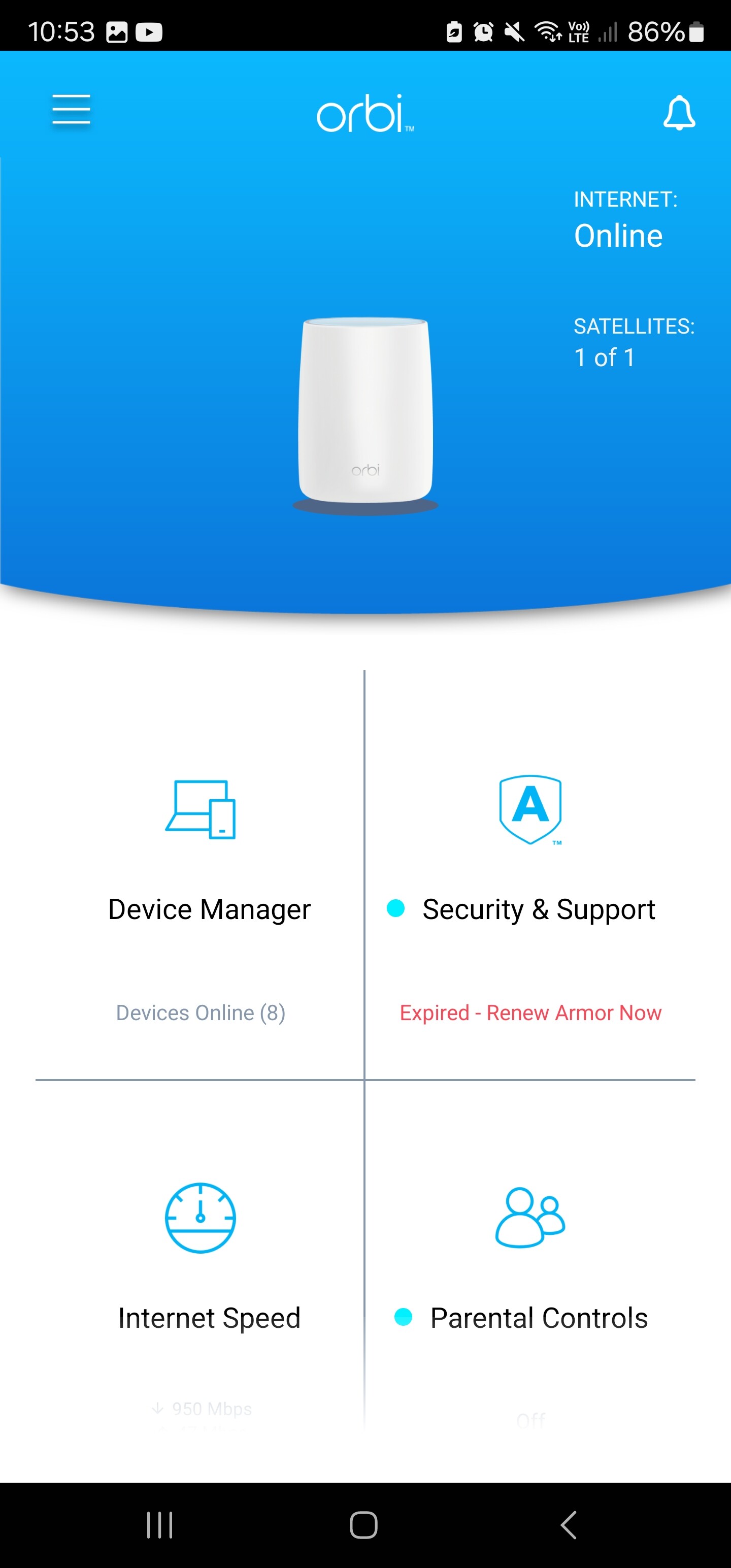

If you have any VPNs or other extra security installed anywhere on this network, double-check that you’ve added all of Roon’s processes as exceptions, including RoonGoer.exe and RoonAppliance.exe as available.

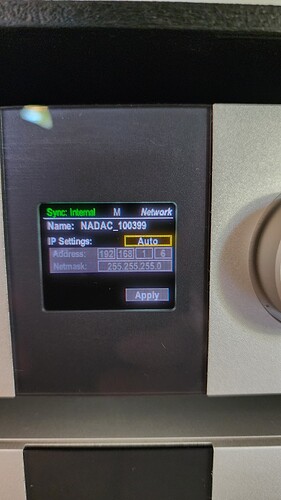

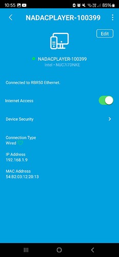

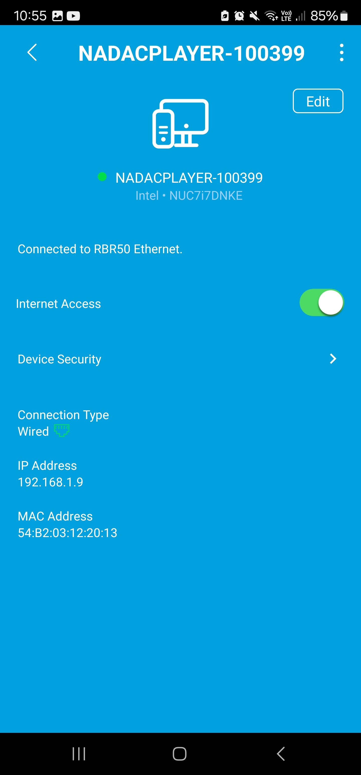

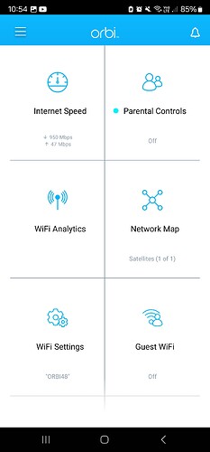

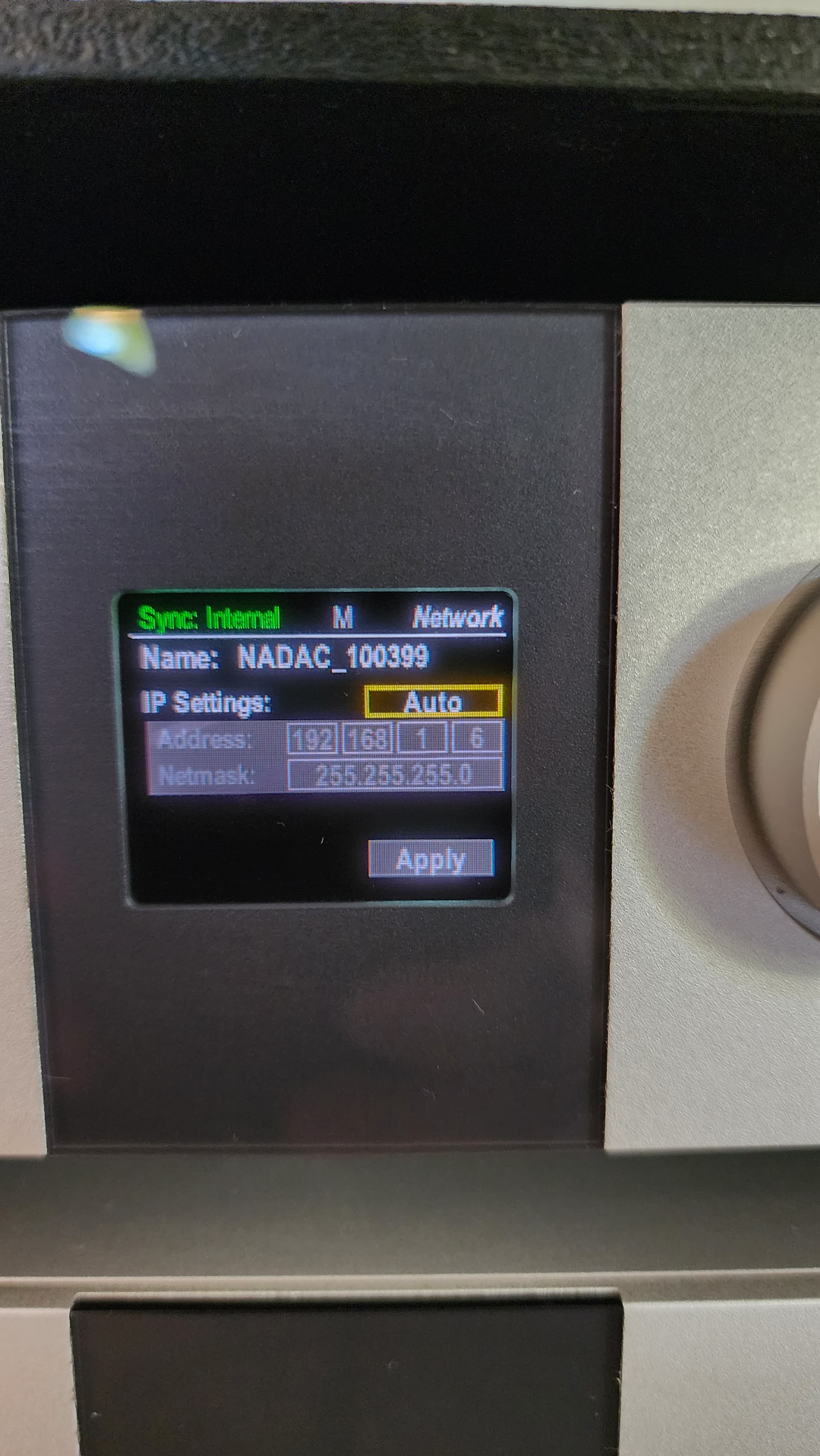

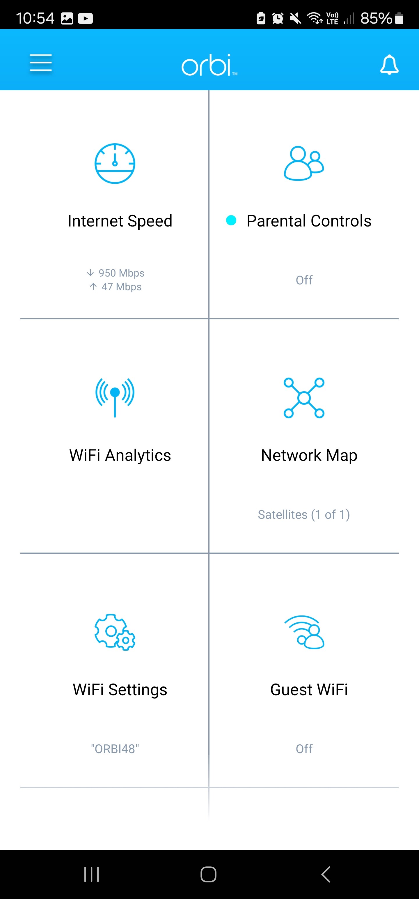

i have no security on my orbi or network. my computer is off so no firewall there. so only security would be basic orbi settings one thing i have noticed is the merging has a different ip to whats on orbi

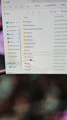

First, there’s a second RoonServer machine on this network that is active and logged in, hosted on a Windows machine. If you’re switching between RoonServers, this creates a pathway to inadvertently deauthorize the Nadac during a session by connecting to the second server on a remote, thereby switching the authorization to that machine. Please temporarily uninstall RoonServer from the Windows machine by finding the Database Location and removing it.

sam issue has happened again. logged out had to log back in and now…
to many failures play interupted

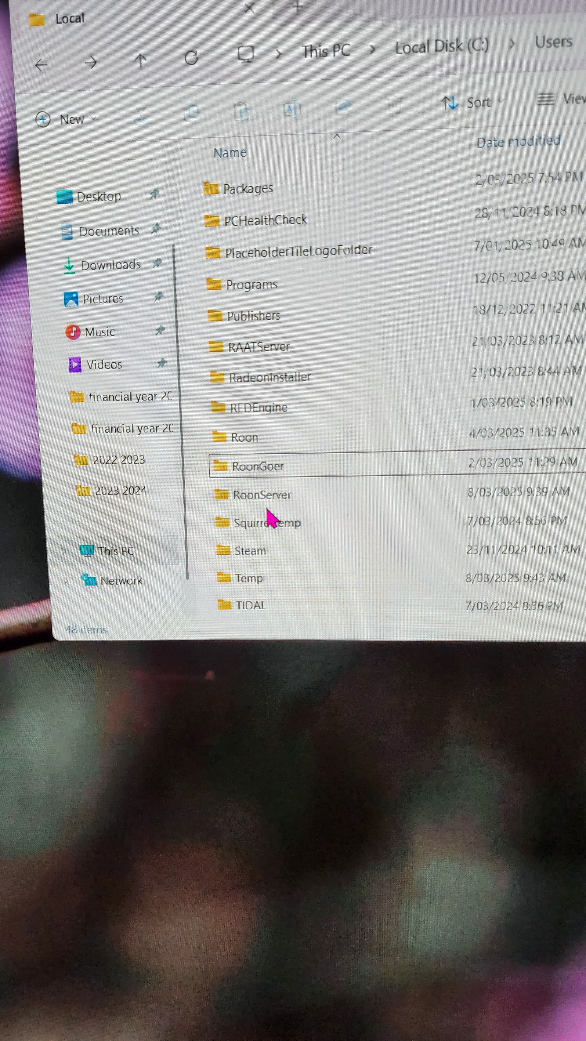

i have 3 folders which one do i uninstall/delete
i have now deleted roon goer and roon server folders only roon folder is still installed. also i have uploaded the latest logs stephen_kinnane_2
tried again this morning and it wont work same error code? playback interupted and i was logged out. i think i need to make you aware that im paying for something that isnt functioning? is that legal?
