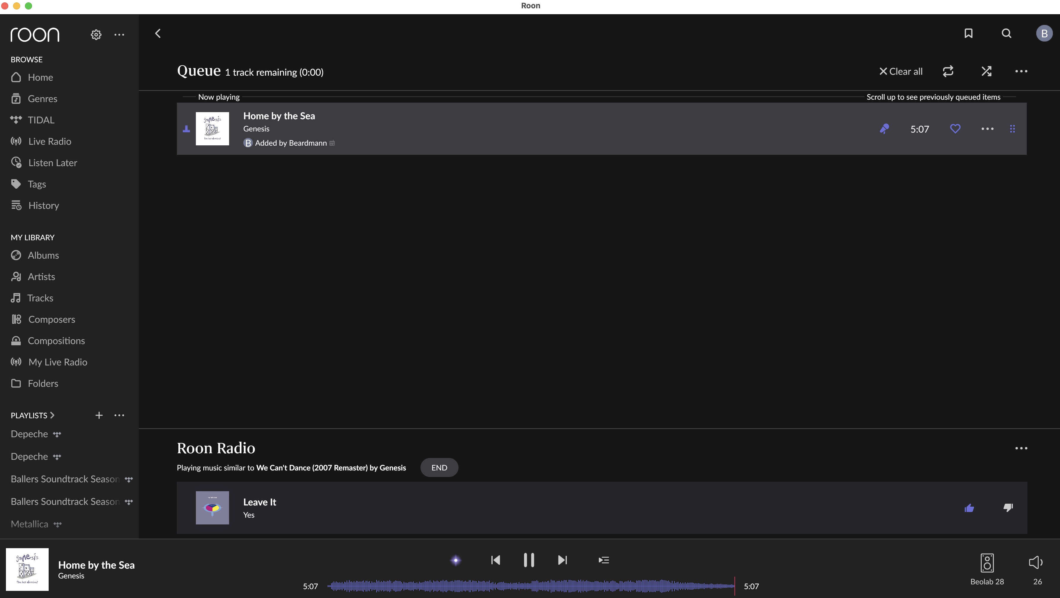

It used to be that if I played an album it would automatically continue after it had played with similar tracks... and just keep going... but lately it has just played a few other tracks, then stops... If I look at the playlist/queue it shows the latest track under now playing (but the track is done)... I can then click next and it will play one or two tracks, then top again... ?
Roon server on Intel NUC simple UI wireless setup with Bang&Olufson BL28 speakers..

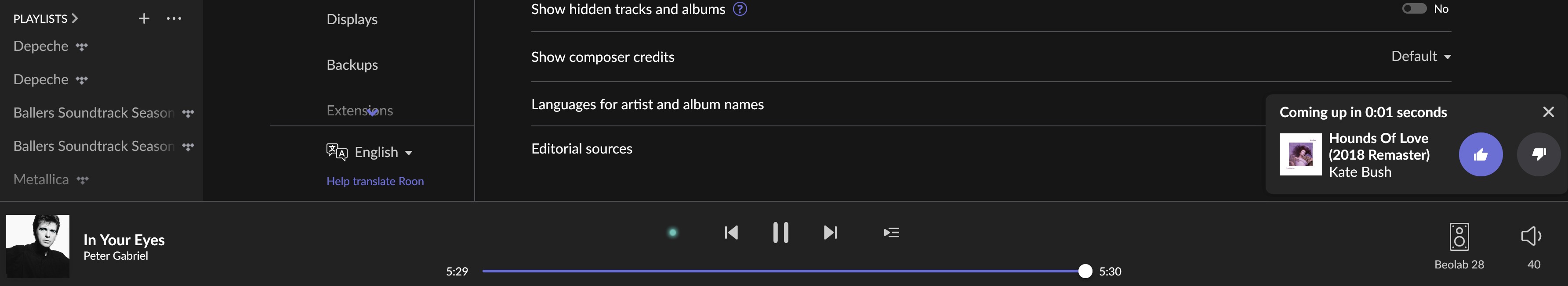

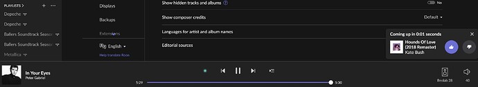

Actually is shows “Comming up next…” as you can see below… but it never plays the next track… just sits there…
Had a look at the logs on the CIFS share… but not sure what I have to look for there? It looks kinda normal to me…
Here may be some interresting.. We have some “Connection refused”… ?
It starts with Peter Gabriel playing… and it you look at the time specified, you can see that it “hangs”.. and tries to get the next track with Kate Bush… not sure what the “raatserver” is? But it’s having issues connecting to it?
