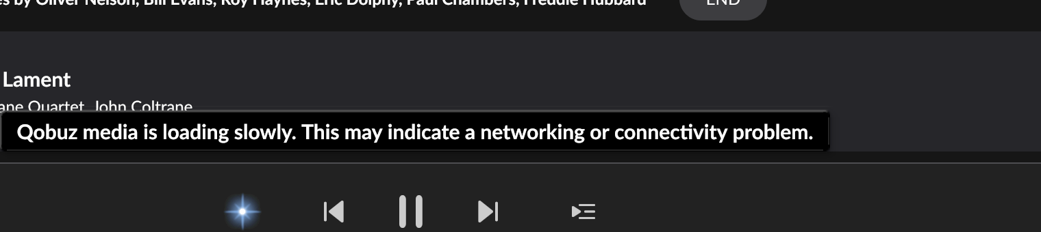

· When streaming from Qobuz i sometimes get "Qobuz media is loading slowly" messages. It used to be onyl with 192khz files but these days it often also applies to 44.1khz.
· Fiber 500 mbit/s, the Mac Studio M2 hosting the Roon server is connected by LAN

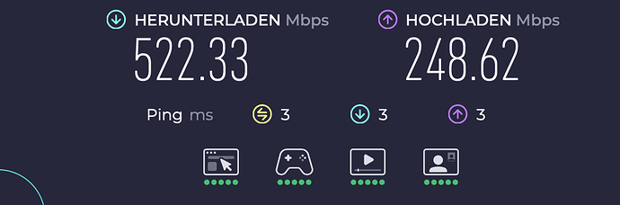

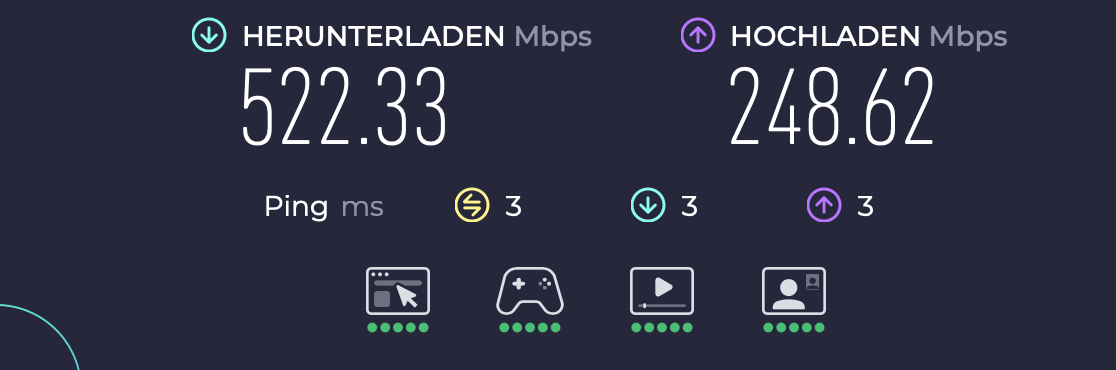

This is a speedtest i just did on the computer where Roon Server is running (connected by LAN). Those are very typical results. I never had any problems with this quite new fiber access.
I am using a Fritzbox after the fiber to LAn converter from the ISP. It just seems quite unlikely that my network hardware should be the problem when i can stream 4k tv streams with no problems at all. I cannot tell you how well my ISP (htp) is connected to Qobuz’ ISP.
