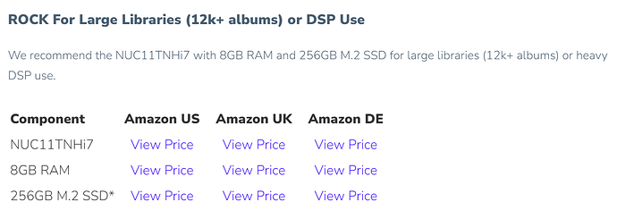

@miguelito , my experience tells me a couple USB ports, an Ethernet port and an HDMI port are no indication of processing power. Roon doesn’t disclose specs, and rightly so for an appliance. In time we’ll get some idea of the cpu and installed RAM (which can’t be updated without voiding the warranty). Most importantly, Roon understands their customers needs, and I have no doubt the One will deliver. Cheers.
Is the i3, i5, i7…., etc important?? Here’s my bible:
(List Your NUC Capabilities Here)
So unless you have a bazillion albums and insist on converting PCM to DSD infinity, the One should do just fine. :+1:

Understood. But when I compare that with the back of a NUC, for example, I don’t see any USB-C or Thunderbolt ports or much of anything else. It looks to me like a very barebones build - and one that is likely available on Aliexpress or similar (I actually did an image search of the back ports but didn’t find anything like it).
Regardless, all of this speculation misses the point: It is a cheap build, probably i3-class or Celeron, and that’s enough for less than 10,000 tracks. Fine. No issues.
Well I have 21k albums. But the more important bit is if you need to do transcoding - that might require processing power that exceeds the One specs. Fine.
