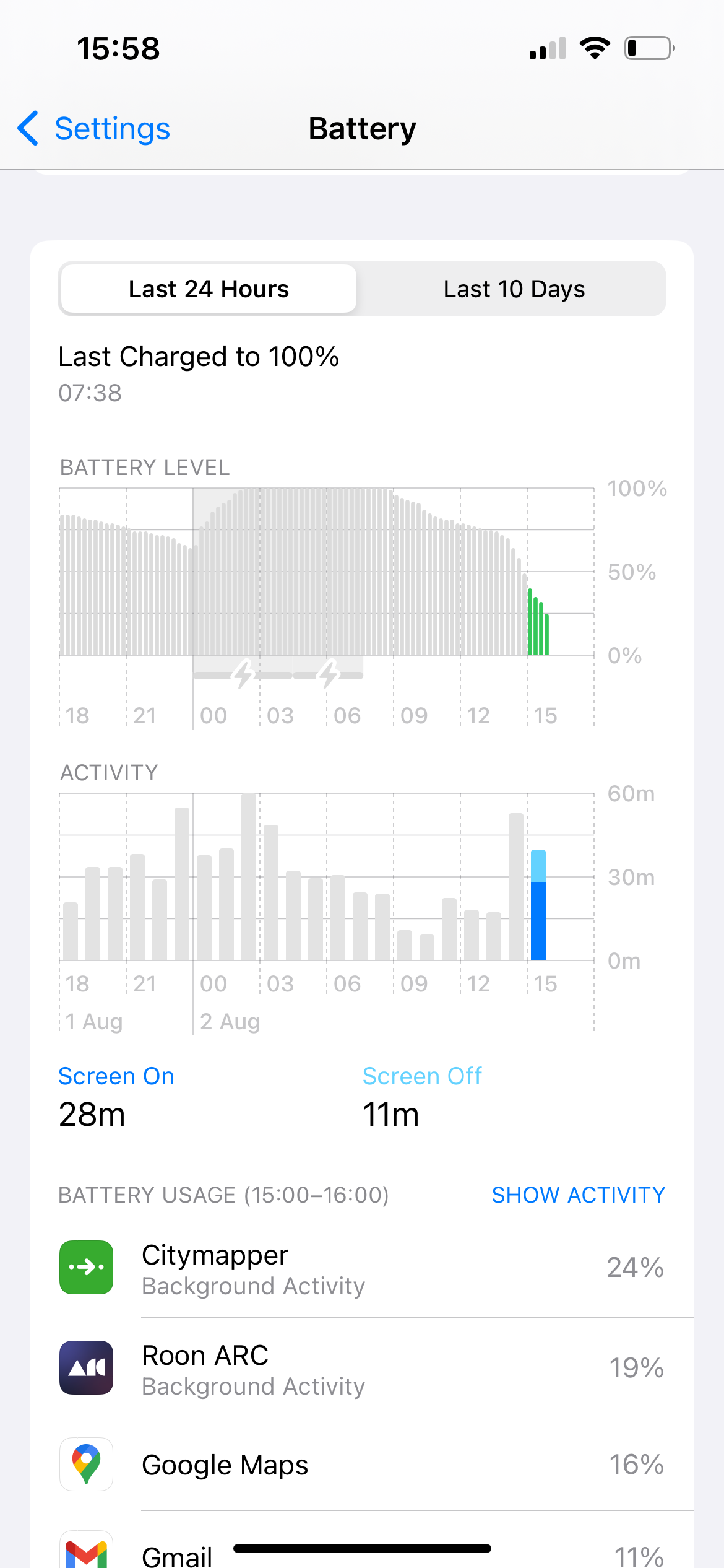

Have attached a few battery usage snapshots
As you can see - using ARC for an afternoon killed the phone battery!
Hopefully there is something useful in the logs.
