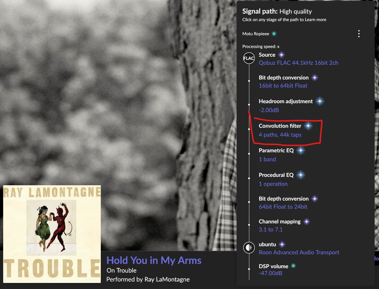

As an example, I currently use an Intel series 3 i5-3427U Processor.
Roon is installed on Ubuntu server 21.10 running Roon server.
The Server completes all Roon tasks, and executes 2 way minimum phase crossovers @ native sampling rates (44.1, 48, 88, 96, 176, 192hkz) via Roon DSP engine.
I run 1:1, Sample rate:TAPS, @ 4 channels, which provides excellent target curve matching in rephase.
Ubuntu shows about 55% load as an average via htop, with Roon showing 5.4% ish processing speed @ 192,000 khz SR.

To provide some background, when a convolution is made one typically needs to enter/select a tap count. The Tap count sets the maximum number of sampling points used to reproduce the target correction. The software used to create your convolution, will have this as a user selectable setting.
Roon will confirm also confirm tap count during playback…
The more taps, the more CPU processing/load required.
I provide two examples here.
My system taps @ 96khz (Notice 1:1 relationship with Sample Rate)
@ 44.1khz
I typically run with a 1:1 ratio (sampling rate to taps), which provides good balance of filter accuracy to target curve. Many people run taps well in excess of this, but for well executed correction it should be more than adequate. Its good to think of the tap count like the sampling rate for music, its the maximum number of points used to sample the target curve correction (which is then applied to the signal during playback). The higher the taps, the more accurately the target curve can be sampled/executed.
The goal IMHO is to use an adequate number of taps at each sampling rate, accurately reproducing the equalisation filter without over taxing the CPU.

Hi Stephen. Processing speed is showing as between 34.7x and 35.7x. Here is a screenshot of the Signal Path panel.
As you can see I have not yet turned off X2 upsampling in Roon. But I will, as I really dont think its adding to sound quality either.
And as you can see in the screenshot, I am running 66K taps, about 50% more than you are.
