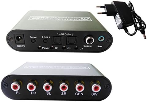

Has someone tried a 5.1 channel DAC such as this one? Connected to an RPi endpoint and feeding the 5.1 analog input on the AVR?
This would appear to be for AC3 and DTS audio. While surround sound is indeed encoded in those formats, most often for movies, there doesn’t seem to support in this device for DVD-Audio or SACD (DSF or ISO files) which are what commonly are used for high def music. So, I doubt it would decode those important formats as a DAC. Plus, as noted above, if connected to an RPi3, the output will be limited to 16/48, so again, no high DSF audio.
