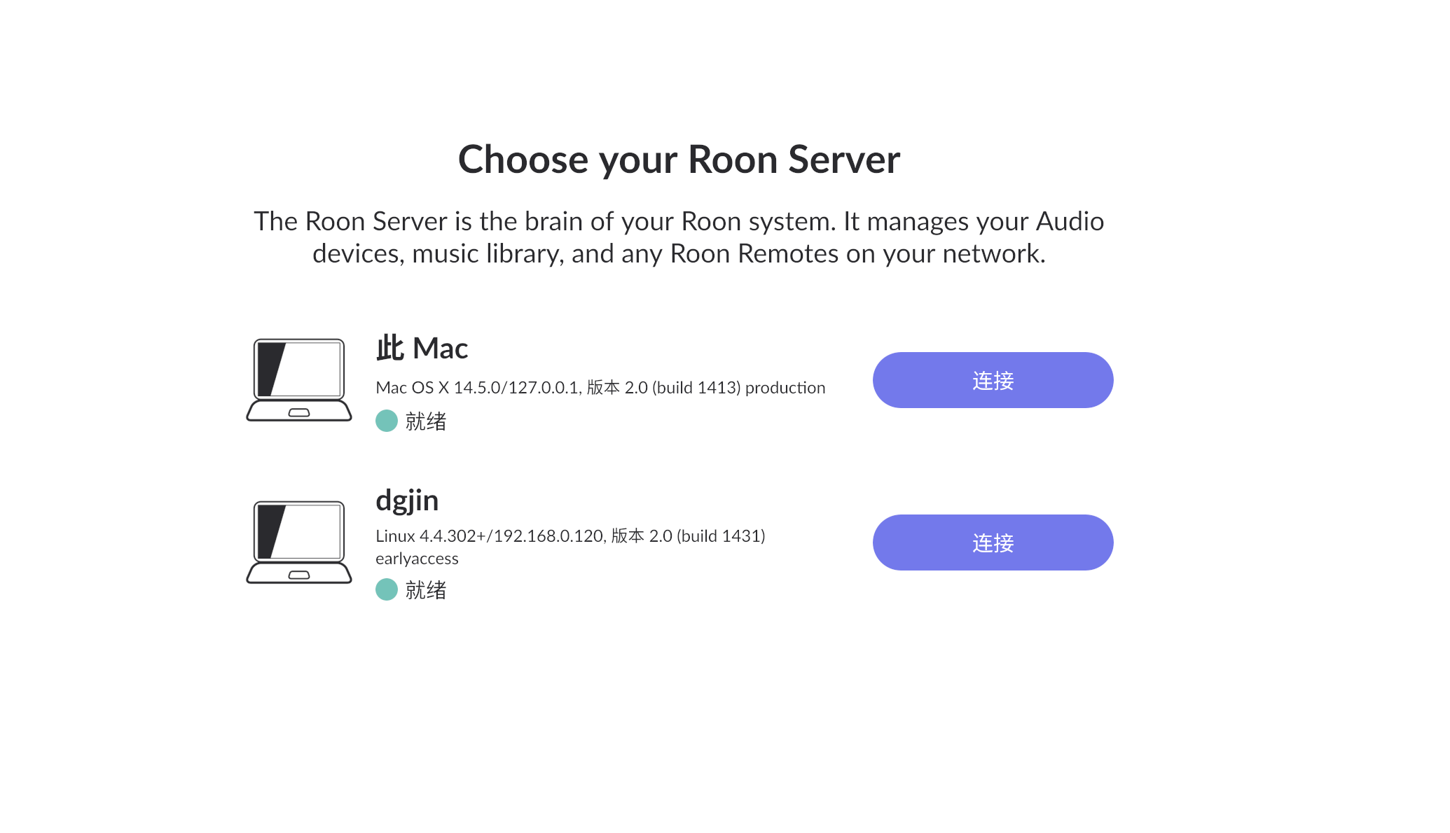

I installed the Roon suite on Synology 920+. I can find the Roon server when connecting through the client, but there is no response every time I log in. I used to be able to access it for a while by restoring the backup (at this time, there was also a prompt that the metadata update was paused. , prompting that the Roon server cannot be connected), but it was no longer accessible the next day. Before this, Roon server was also installed on the PC, and there was a prompt that the license was exceeded.
Is the Synology the machine called „dgjin“? Note that it is using an Early Access version. Are your remotes also using Early Access (or Beta for mobile devices)?
“dgjin” is my Synology server. I installed the latest version before and had the same problem. I just installed the current version, but the same problem persisted after installation.
