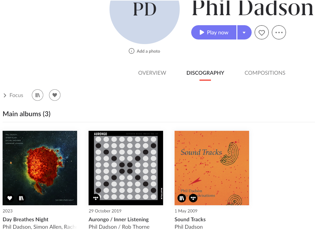

After some experimentation, I left the commas in the artist metadata alone rather than changing them to semicolons. That worked for me. The album now has an ‘artist’ consisting of all four names. But below that are the individual artist names that I can click on to see their other albums:
